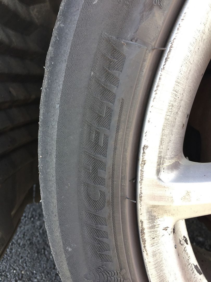

rears
http://i1168.photobucket.com/albums/...psel7orw4h.jpg

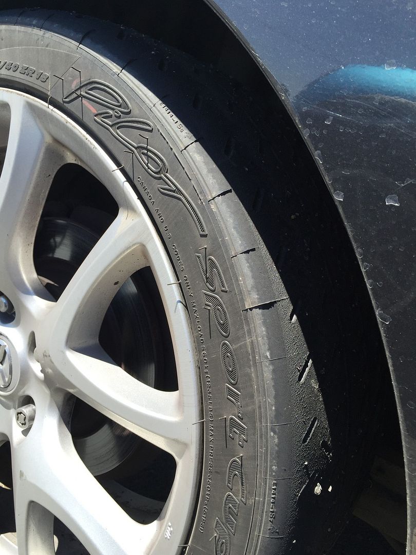

drivers front. Track is hard on the drivers front. This is what happens when you try to push too hard. Overcooked turn 9 (right hander). Overall, a big step up form the Michelin Super Sports, which are a great tire.

Looks like you need more camber and/or more pressure in front tires. Try running 38-42 psi hot. That Porsche guy needs a driver mod pretty bad, I bet I could make him spin by staying close on his ass. :D
gliding_serpent 05-20-2015 08:32 PM
Michelin suggests 32 hot front, 35 rear. I probably ran a little higher than that, as I was 32 warm for the fronts. Still, the loss of grip on the straights might be worth the firmness in corners. I was fine at first but tried to go a little lower as the day warmed up to see what would happen, but I agree I went too low. My tires did pretty well until the final session - with a heavy passenger and me not adjusting with higher pressures. Overcooking a right hander did not help either. The beat up tire will be passengers rear next time.
I need way more front negative camber to get full benefit from these tires. Probably will not bother however as there is no easy solution (tried the loosening the three bolts trick), and this is a hold-over until my other car finishes a rebuild.
