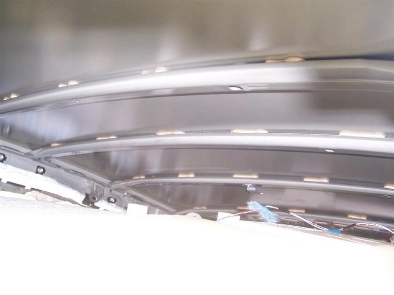

Actually (at least with the Gen Won), there are extra roof braces connecting the two sides of the car (at the B pillar and elsewhere) that the regular 3 doesn't have.
http://i36.photobucket.com/albums/e1...of009Large.jpg
http://i36.photobucket.com/albums/e1...of007Large.jpg
That's why the MS3 isn't offered with a sunroof/moonroof from the factory like the regular 3 is.
Regardless, you're probably right about the fact that you're most likely creating an even larger detriment when it comes to the added weight at the worst possible place for it to go (in terms of how it affects handling/chassis dynamics): the roof.
dbrier 09-09-2012 09:59 AM
I'd like to see the bare roof of the 3 and MS3 to see the difference.
It's hard to tell in that photo how strong those braces are. In many cars they are just keep the roof panel from bowing in the wind or a car wash.
I believe the lack of a sunroof is more about pricing, marketing and weight, not structure.
Raider 09-09-2012 10:02 AM
Those crossbeams are useless. I remember when the guy on m3f got it 6 years ago he was chastised. 2 years ago, still no problems.
And look what worked in a rollover....

It's not a fucking roll-cage...they're braces. If you don't think they reduce chassis flex/twist, I don't know what to tell you. They aren't meant to hold up the weight of the car in a roll-over...

Being held on with glue, I don't put much stock in them being needed. Regular 3's have em removed for sunroofs no problems. Modern moonroofs are equivalent to oem in quality.
Removing the braces for a moonroof will not hurt the ms3.

they look like they're bolted in at either end. The glue is to support the roof structure and prevent shear, has nothing to do with rigidity.
Lateral braces bolted on either side, on a roof structure, do significantly aid rigidity, as little as you think it may. Why do you think convertibles get such a bad rap with rigidity? No roof structure to tie it all in. If you can stiffen the roof structure but keep weight low, that's optimal....and that's usually done via multi-point roll cage which also helps keep c of g low.
Nliiitend1 09-09-2012 11:00 AM
They're actually welded to the roof rails on either end, but @chimmike has the right idea.
These things are not decoration, and removing them and putting in a sunroof/moonroof will likely reduce structural integrity and definitely raise the car's center of gravity. Will it reduce rigidity and raise the COG enough for it to matter to the kind of person that puts an aftermarket sunroof/moonroof in an MS3? Probably not, but I sure as Hell wouldn't do it.

The braces are there to support the roof sheet metal from bending under flex because nobody wants a roof with a bunch of waves in it. They do contribute slightly to lateral stiffness but mostly id worry about the thin ass roof skin deforming.
