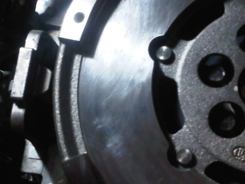

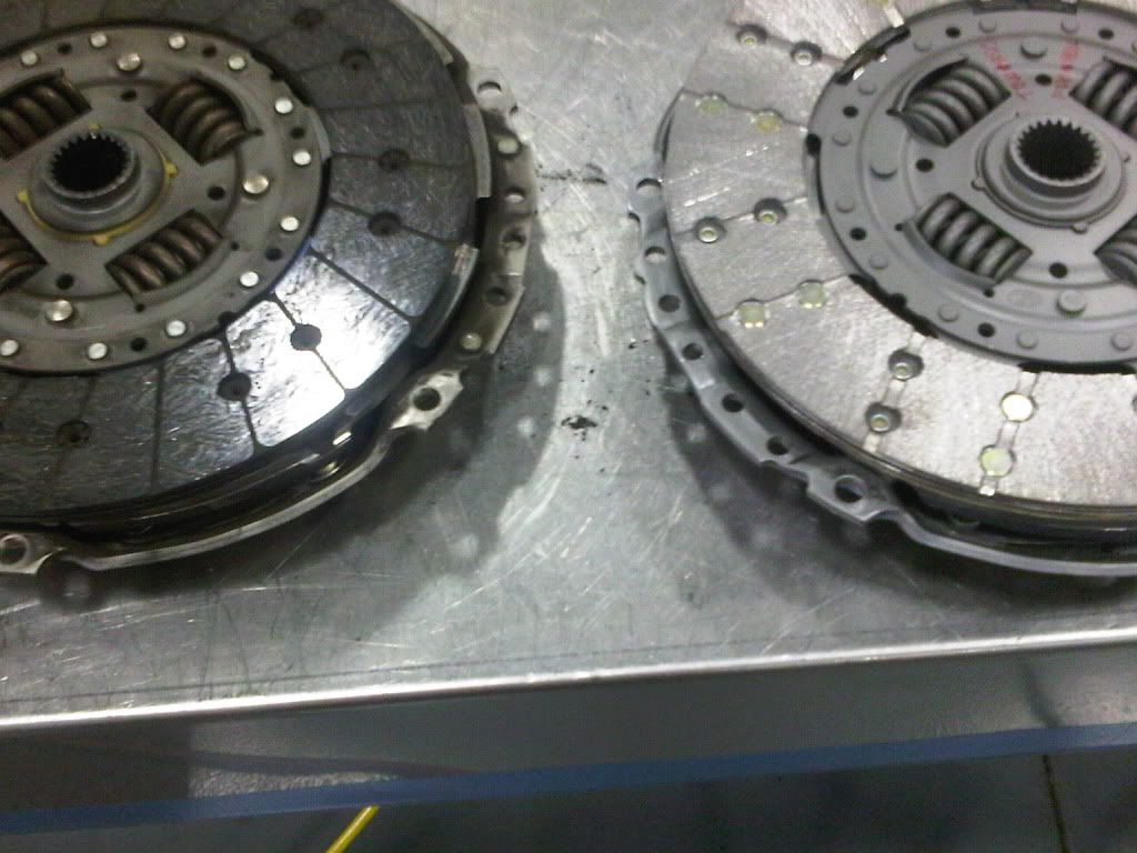

The feel is due to the SAC 2 or self adjusting clutch / pressure plate. The more the clutch disc wears down the more clamping force the pressure plate will put on the disc but the feel of the pedal will remain almost the same throughout the clutch's life. It's actually a very neat design. Our clutches and dual mass flywheels are made by a German company named LUK.
Schaeffler Technologies —|—LuK Products —|—SAC 2
http://i1211.photobucket.com/albums/...10724-1249.jpg
http://i1211.photobucket.com/albums/...10724-1233.jpg
