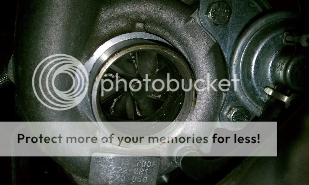

MS3inDC 06-28-2011 07:12 AM
Take the intake off and check your turbo. This is why my turbo whined...
http://i455.photobucket.com/albums/q...e/IMAG0285.jpg
I bought my car used, from a mazda dealer. Just make sure you check everything because obviously my dealer missed this shit before they sold the car...
