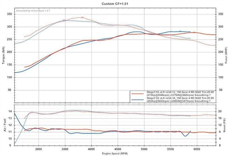

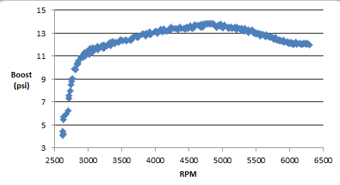

So I've been tuning my new "fully bolted" setup which is a catless long ebay DP, 3.5" intake, and a CP-E TMIC. I was having some trouble dialing in WGDC. After 8 revisions I was still over target in the 4500-5000 vicinity and was scratching my head big time. Well, had a thought today that my K04 might be creeping a bit due to the catless DP. Zeroed WGDC, took a log...sure enough, it is. This was taken with BATs in the 130's...imagine if it was colder lol.
So far WHP is in the 275-280 range with probably a little more room to grow (~5 whp) but not much. Kind of expected a little more, but it is what it is...it's summer, shit's hot, and an aftermarket TMIC is still a TMIC. Soon I will resume my 2 gal methanol mix and make some real power.
Love the catless downpipe so much though. The fast spool, the sound, the low cost. It is excellent.

Originally Posted by Awal View Post
Thank you so much for this post/info MD, I'm looking for as much "fully bolted" information/logs/feedback etc as I can on the K04 w/ most bolt ons. If this POS d-bag MAC Tools representative actually delivers my OSW-SET by the end of this week I should have my catless CS TBE on by Sunday, and will finally get to do my custom tune with Alex in person shortly after. It's good to have these numbers/info from you so I know what to shoot for/be happy with.
I too will be going to WMI in short order, but in the mean time, with our shitty eth-free 94 octane gas I'm trying out in-tank meth w/ 91 oct (w/ 10% eth) to see if I notice any differences overall. Won't be tuning for in-tank meth, but I thought it would be fun to try it out and see if I could notice some differences.
I just put in a 1/2 gal of meth in my current tank of 91 w/ 10% eth (from the pump) and will monitor to see if I notice any significant diffs in KR etc.
You might or might not see some benefit from the half gallon. Personally I would recommend going straight for a 2 gallon mix. The values you will need to put in ATR, according to sheston, who helped me get started with methanol, are fuel density = 0.7482 and injector scalar = 1.08. Those values will get your fuel trims down to normal levels.
One thing I forgot, vdyno's not the greatest at giving an accurate result, but good for relative differences. I was in the 260 whp vicinity with just an intake. So the catless DP and IC are probably worth about 20 whp combined, and all bolt-on's are probably worth 30-40 whp. I think this helps reinforce the notion that the downpipe is not a major restriction on the K04, as people with a test pipe can easily achieve the numbers I'm talking about.
Also, there's one more limitation here and that's my tuning ability. I'm not sure exactly what to target right now with regards to boost. Because of the IC, the car's significantly more tolerant of timing (this was a nice surprise, actually), which makes me think maybe I should run more boost. I need to review more logs of people with similar setups who are pro tuned to get a feel for my best option.
Edit: Took two 4th gear logs on the way home. One had a KR spike in the 3500 vicinity because of overboosting, just ignore the AFR in that region.
It's obvious to me that I really need to switch to load tuning at this point. The boost with this setup just isn't consistent, no matter how many revisions I do, and I'm getting these occasional massive KR spikes, which I attribute to small localized boost errors (0.5-1 psi), which I guess could get away with on my old setup, but now my loads are like 0.10 higher across the board and that isn't going to fly anymore.
