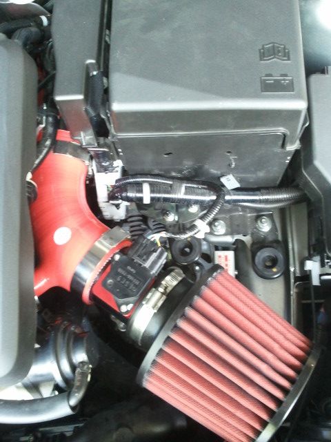

Finally got around to finishing my JBR CAI install yesterday. I actually installed the TIP and the SRI portion of their stage III power path intake system a few weeks ago, but couldn't do the CAI portion of it because I had no jack or car ramps at the time to get my car up.
I ordered some Race Ramps from Amazon (Great ramps BTW, totally recommend them) and they arrived last Friday. Now equipped with a tool to lift my car up I installed the extra silicone elbow and pipe to make my intake a full CAI.
Here's a picture of it when all I had was the TIP and SRI installed.
And here's a picture of it with the extra pipe installed.
The air filter sits nicely in the area just behind the fog lights. The JBR instructions where great.
Total install was pretty much a breeze. The hardest parts was taking off the damn stock vacuum house off the boost control solenoid nipple.
Also getting the belly pan back on was kind of a pain. Kept getting shit in my eyes and with no one helping me I had to hold that shit up myself while screwing everything back into place.
But all in all it was a an easy install and JBR makes an amazing product! Fit and finish is superb. I am 100% satisfied with my CAI purchase. The turbo spool sound is amazing with everything installed.
Definitely will be buying up some more JBR products.

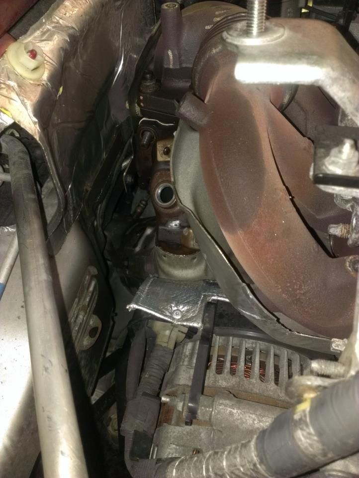

Fixed my front 02 sensor myself. I could see the guy who installed my DP, did not disconnect the wire harness or cut the stock zip ties when he swapped it over. That's pretty much guaranteed to wreck it by putting tension on the wires while screwing it in and out. Anyway not that hard of a fix if you get the proper offset o2 socket. IGot a set from princess auto for $80 that also includes an injector socket, Vacuum switch socket, and oil sensor unit socket.
Only had to remove the battery and tray, again I noticed my battery wasn't disconnected during the DP install, and I don't think they are accessible from the bottom unlike the rear sensor... Use the screwy thing to clip the wire to the firewall to keep it off the DP, and used a couple of extra zip ties to keep things neat and tidy.
I used the NGK/NTK 24357 sensor. I think this is the OEM unit on the Pus anyway, and it's available for $130 shipped online.
Now that the AFR reading is back I was able to do my MAF cal and WOT log for my Strat Tune. I love how the car is running in closed loop now. I'm barely touching boost during everyday driving anymore.

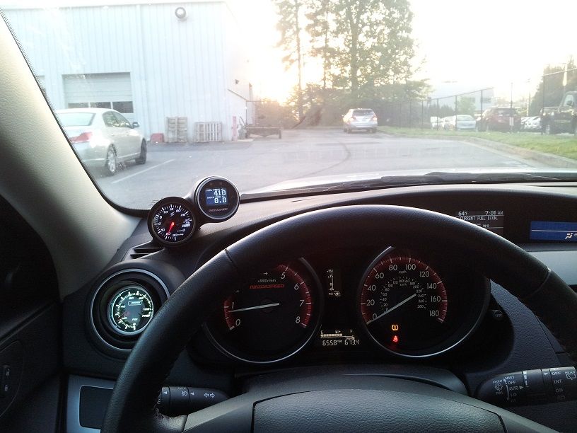

installed the Aeroforce interceptor gauge and block8head gauge pod i received in the mail.

Finished wiring all my gauges and putting the boost gauge in yesterday. Prosport oil pres gauge is eventually going to get replaced with a matching STRI. Also did a second oil change and found another slipped belt on the right front tire...Fuck toyo tires i have never had problems like this with any other tires i have owned so i the stock wheels and dunflops will be going on until i order some super sports through my work.

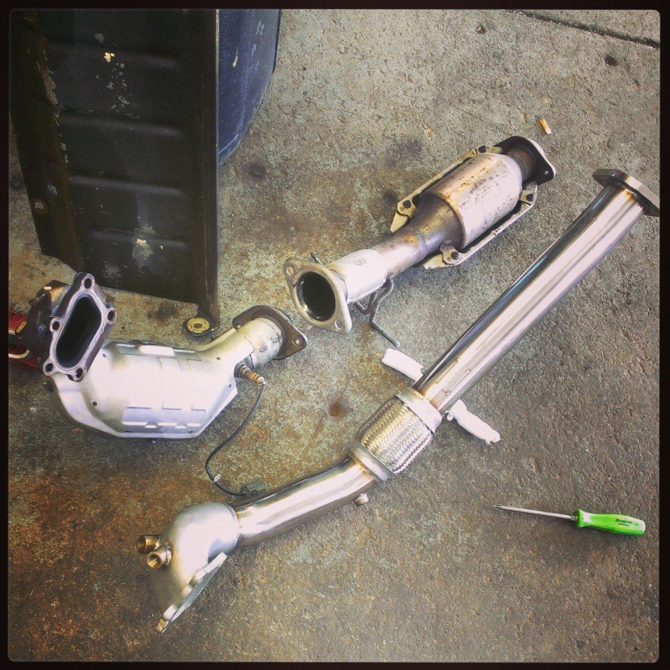

Installed the CNT Catless DP a couple days back. I have to agree with everyone else...the bottom 2 bolts were a bitch! Thankfully we used my buddies lift so it was a fairly easy install.
I have to say that I am very impressed with the CNT catless DP and the welds were very good for the price. I would recommend it to everyone. The drone isn't too bad but you can definitely tell a difference in sound and the butt dyno.
Soaked the hell out of the bolts and o2 sensors
Sorry for the shitty video but it was the first time I ever used my gopro :/ I don't know why there is static noises in the background of the OEM comparison. I really wanted to let the car warm up a little bit before revving the piss out of it so I guess it made for a boring video.
