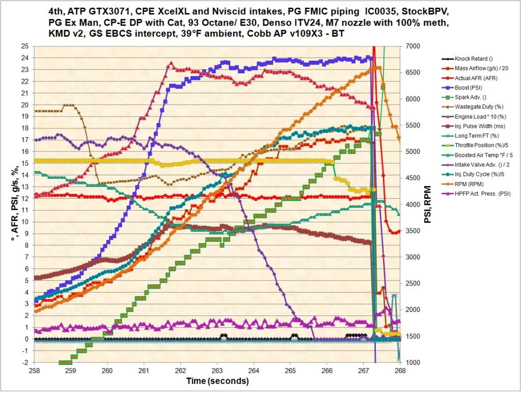

My initial results do not indicate that the fuel scaling helps shift us under LCV2™:
http://i77.photobucket.com/albums/j6...30112-1log.jpg
I should have been tapering up to 25 PSI by 6500 RPMs where I was targeting 2.05 load, but the throttle started to close and the WGDC didn't go up to support this. So instead I was at 24 PSI and 1.99 load at 6500 RPMs.

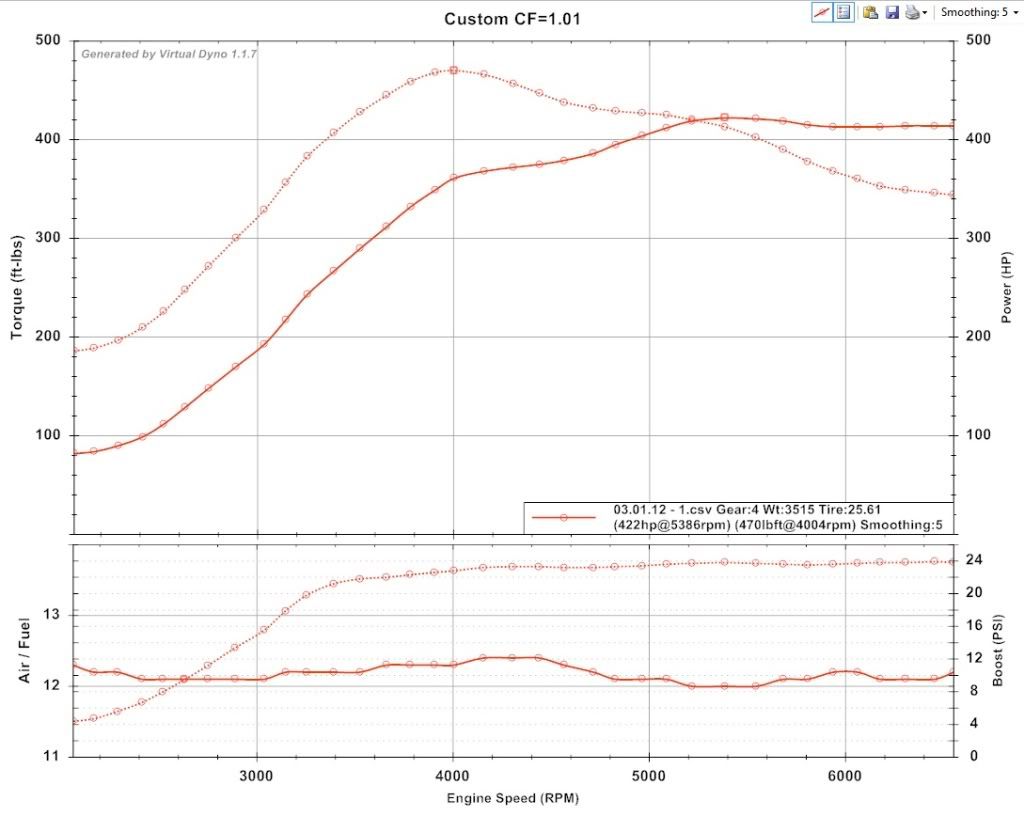

Still making decent power though:
http://i77.photobucket.com/albums/j6...030112-1vd.jpg

do you feel the least bit uncomfortable with 470ft/lbs TQ at 4K RPM?
rfinkle2 03-02-2012 02:23 AM
Originally Posted by mrmonk7663 (Post 1288804)
Can you link me to the intitial discussion of Load Cap v2. I have searched for it but I think I missed the initial dissertation on it.
lots of that info here:
http://www.mazdaspeedforums.org/foru...-again-102597/
cld12pk2go 03-02-2012 05:15 AM
Somewhat yes...I actually have pulled WGDC back some there as I had overshot my target a bit there.
That is a little higher than I would expect at that RPM normally. I wouldn't expect every pull to be that high as their was a bit of a spike their on this pull, which was likely related to a hump in the road.

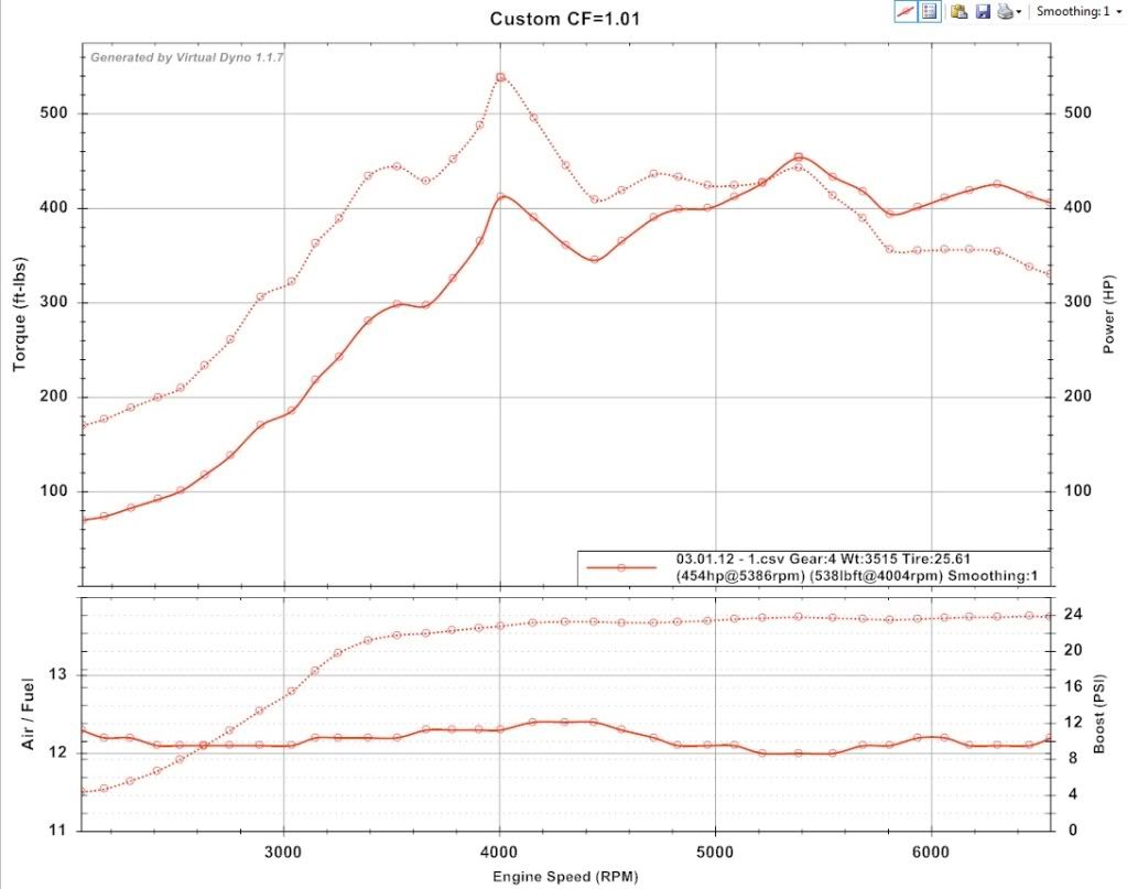

Here is the same pull with smoothing set to 1 to show the spike at 4k:
http://i77.photobucket.com/albums/j6...0112-1vds1.jpg
I am currently targeting something like 400-430 ft-lbs over as broad a range as possible. Specifically, I am trying to carry the torque higher into the RPM range, which is causing me to bump into LCV2™.
In this pull, I am over 400 ft-lbs from 3300-5600 RPMs, and other than the spike around 4k it looked pretty good.
Dano 03-02-2012 11:00 AM
lol so a road induced TQ spike...got cha...I would still be worried about 430 @3.3k but that's just me. I try to stay under 400 which I do now with my reverse taper. Saves on rubber as well :)
