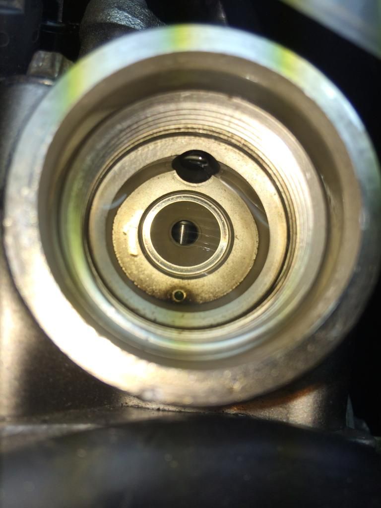

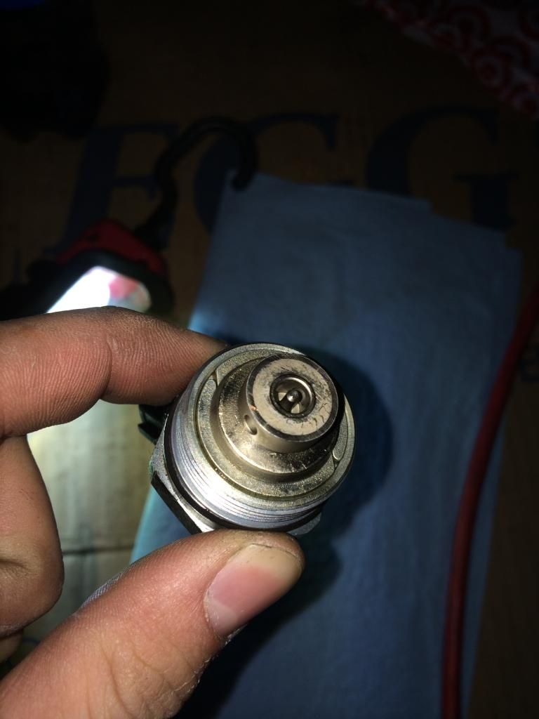

Originally Posted by MSP6 View Post
I know, that's why I separated the two lines. Your car, as well as the testers car. No real point or logic to my post. Just announcing the sexiness of my exactly similar pump....
Also, FWIW I didnt just clean my internals alone. I hit the internals, spill valve and entire pump insides with S-1 goodness.
How much did u put in spill valve? When I did that, my pressure was 60psi till shit started flowing. Or that normal till fuel starts circulating through the pump?
I generally crank over for 3 seconds (holding down clutch and throttle). After the time elapses I let go of the throttle and I get a good clean high pressure start. If I cold start without doing this... It stumbles briefly.
Sent From a Galaxy, Far Far Away...
Yeah that's exactly what mine did. So either way it's normal till gas starts flowing again.
@littleloogy; how much did u put in the spill valve?

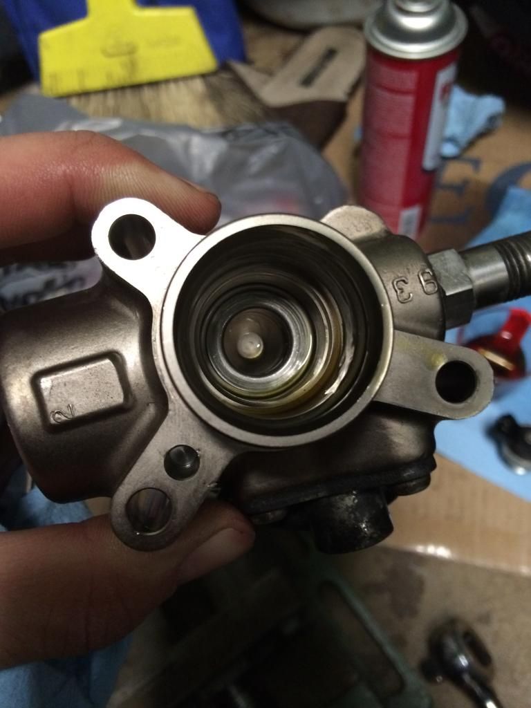

Pump/internals were spot less..... Just the spill valve took a shit.
Pump is clean, not one sign of Black Death

But sticky death everywhere, right?
I put the spill valve itself in a cup of s-1, submerged the entire internal assembly and then pour s-1 into all accessible areas of the hpfp. I also exercised the internals a bunch of times while submerged. All done after initial cleaning. If it was possible for fluid to get there, there's s-1 there. As to how much in the spill valve housing, no idea i didn't measure. Halfway filled it or so.
I also cranked it over for a few seconds on initial startup but haven't since.
No..... Housing was clean and lubed still by the s-1 shit so it wasn't sticky.
The spill valve was a lil sticky tho. Idk if I had s-1 in the spill valve.

Swap to the RP Dexxos oil and see if you can last longer.
Edit:
When you put the pump back on, remove the spill valve and fill the pump up to the first thread, then put the spill valve back on. Should last longer.
