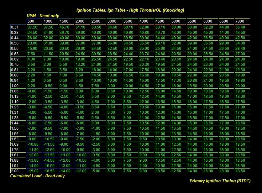

cld12pk2go 08-30-2011 04:41 PM
Originally Posted by bewsted (Post 1018614)
I am running this currently.....even in the 95 degree weather it was breaking the tires loose in 3rd.
2500 3000 3500 4000 4500 5000 5500 6000 6500
0.00 6.00 9.00 11.00 12.00 13.00 15.00 17.50 19.50
You do understand that the lack of KR doesn't mean you aren't beating the piss out of your main and rod bearings right?
Not that I am saying you are, but you are operating on a leap of faith until someone tests 50/50 on a dyno to find MBT.
The only place I would be significantly concerned is your 2500 RPM timing as everything else isn't too far from demonstrated safe conditions...

phate 08-30-2011 08:42 PM
Code:
RPM              2500        3000        3500        4000        4500        5000        5500        6000        6500
bewsted                      0        6        9        11        12        13        15        17.5        19.5
phate              -1        8        10        11.5        13        16.5        19.5        22        24
Difference        1        -2        -1        -0.5        -1        -3.5        -4.5        -4.5        -4.5
Weak sauce^^ [haha, you're running more timing than I would without being on a dyno!!]
The 2500 range is probably fine, as well, if it isn't causing knock. My flywheel is damned chattery down low, so I'm guessing that is what caused my KR in that rpm range.

bucker              1        5    6.5  10    12.5  15    17    18    19
Difference:        2      -3    -3.5  -1.5  .5    -1.5  -2.5  -4    -5

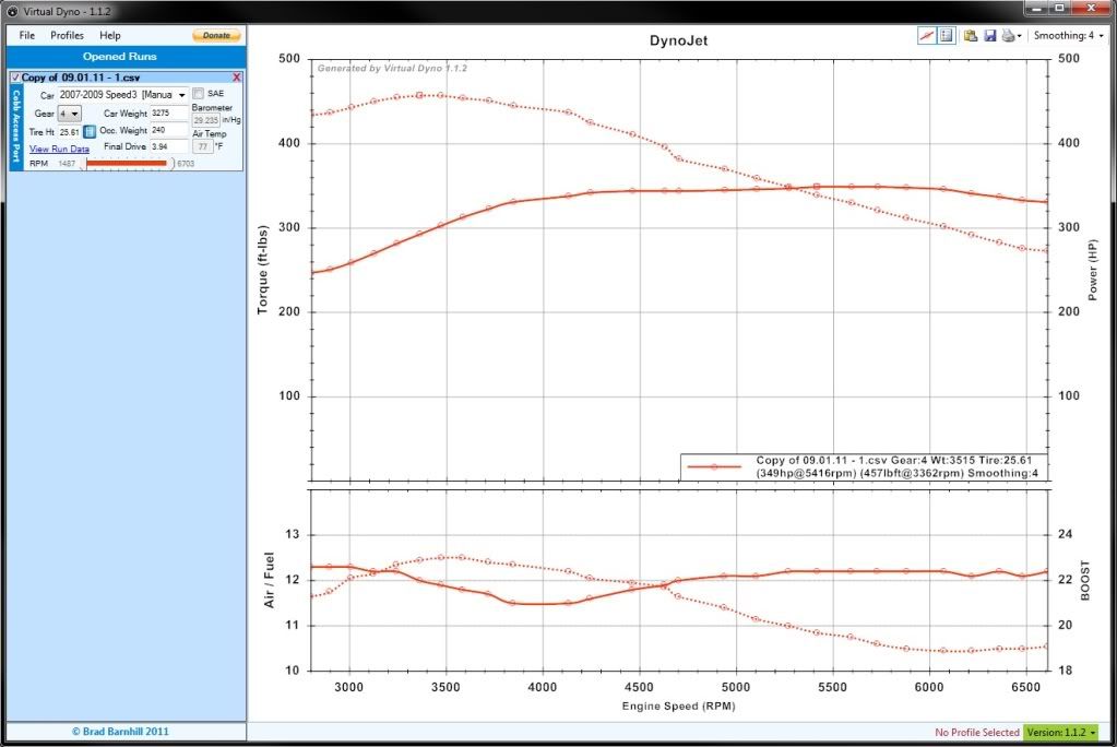

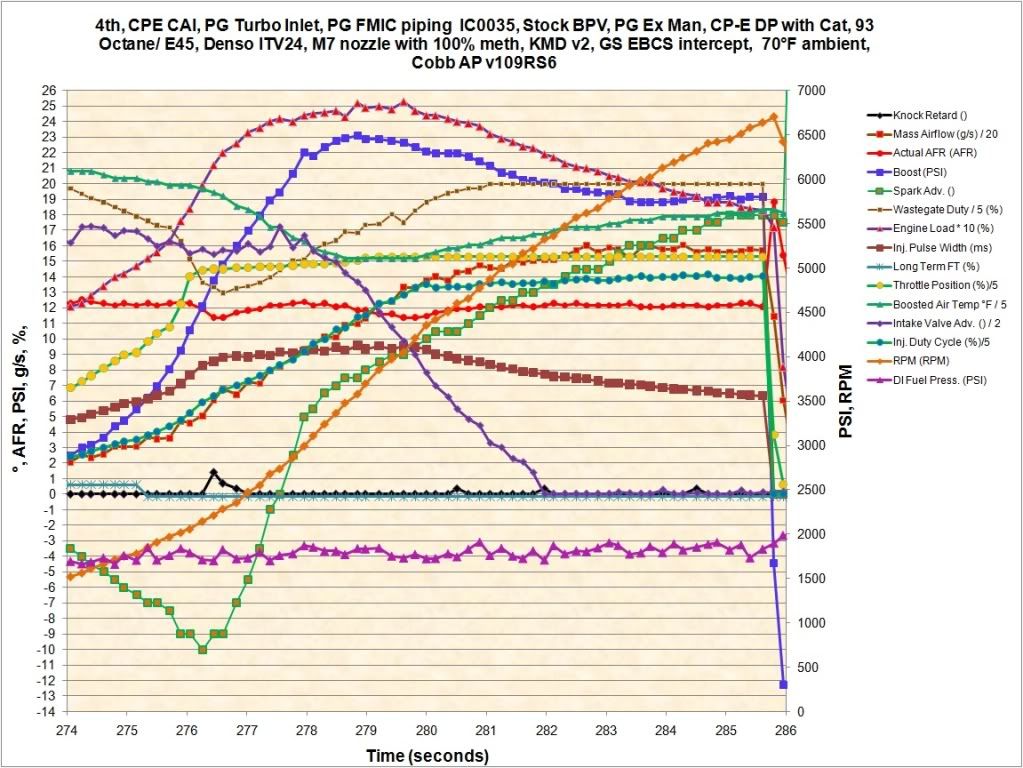

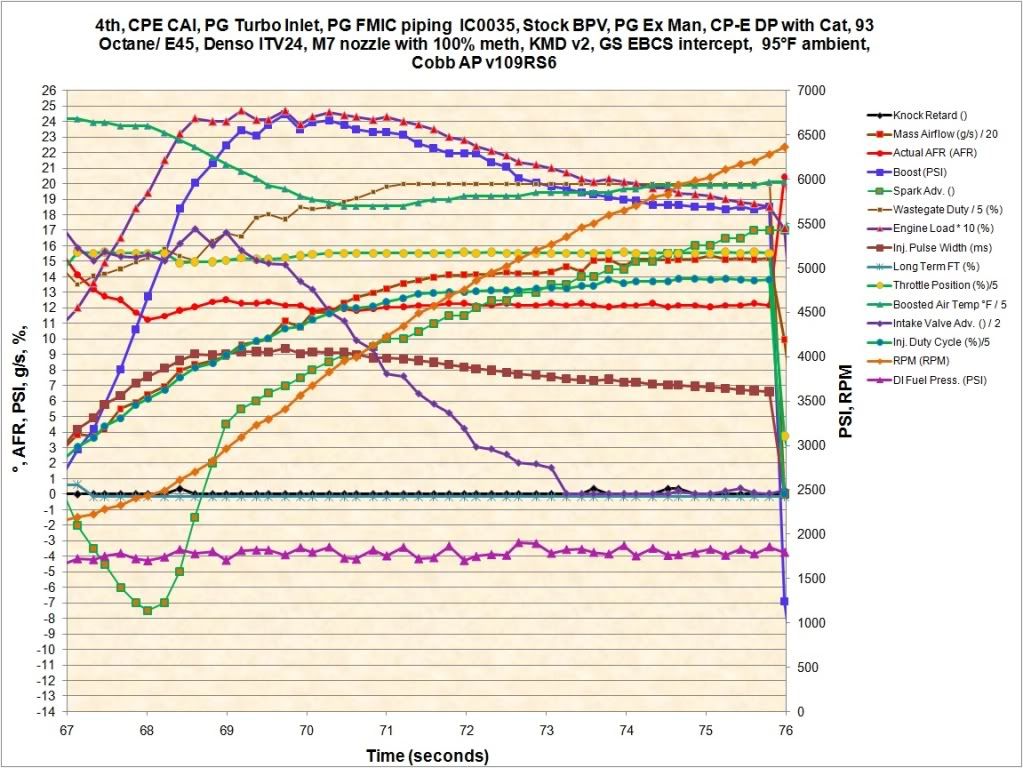

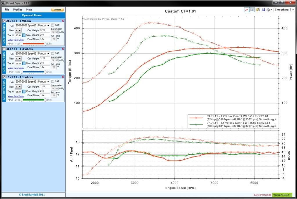

Today is a sad day. For the first time in over 4 months, I filled up with 93 octane :( I haven't gone full throttle yet, but I'm anticipating disappointment, haha. I'll switch back to E85 when I return from my trip Monday night.
I can tell you guys the car is ridiculously fun to drive with the flat power curve of the E85 tune. Being able to short shift at 4500rpm and still have power in the next gear is amazing. I'd bet it would be fun as hell on a road course.
@silvapain - I grabbed a 4th gear log last night that was pretty clean and I threw it into virtual dyno. It said 357hp and 472lb/ft of torque. The curve was almost identical to what I saw on the dyno, just raised a little bit. I'll post this up when I get back from work/class, tonight.
Anyway, I just putted around on one of Cobb's new boost tuning maps, and I must say - They are MUCH more refined than the older maps and my E85 map. The car drives very nicely with it. I think I'll transfer my E85 parameters into one of these to take advantage of how smoothly it drives on the low end.

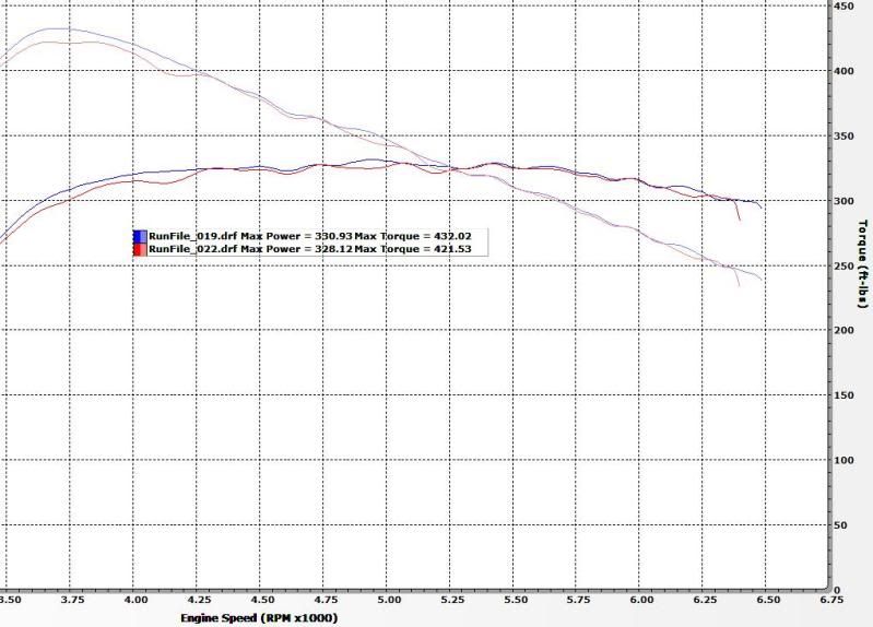

Phate, I don't know if you got a good look at my tq curve, but I was amazed at how flat that was over the entire rev range. Comparing it to comparable 93 dynos I have much more "under the curve".

cld12pk2go 09-01-2011 03:50 PM
So far so good with more timing...
Peaking at 18° at 6500RPMs, but with several degrees added in the mid range as well. I am still a minimum of 2.5° less aggressive than Phate's optimized timing.
http://i77.photobucket.com/albums/j6...09S6timing.jpg
Morning pull:
http://i77.photobucket.com/albums/j6.../090111-13.jpg
Afternoon pull:
http://i77.photobucket.com/albums/j6.../090111-22.jpg
The stock K04 doesn't mind 23-24 PSI...
Car is pulling wicked fast in the mid range. I have occasionally chirped the tires from 4th gear rolls around peak torque, which is insanity defined...:boobies:
phate 09-01-2011 03:54 PM
It's all about airflow...
ps - I hate your charts :tongue:

How the shit are you holding 18+ PSI at redline? I didn't think that was possible on K04...
cld12pk2go 09-01-2011 03:55 PM
No mercy?
phate 09-01-2011 03:56 PM
I repeat...IT'S ALL ABOUT AIRFLOW!! Who cares what pressure it's at, as long as that little snail shell is pumping out my 280+g/s, I don't give a damn what pressure it's at.
cld12pk2go 09-01-2011 03:58 PM

fwiw i also hate your charts lol
Bucker 09-01-2011 04:24 PM
Yeah I HATE those charts lol... I just never spoke up. Dude, I need to add some boots down low then to keep up! Good shit. Maybe its time for the new MAP sensor too lol.

Dano 09-01-2011 04:39 PM
spray enough meth on it and it will go.
@cld12pk2go
are you running stock BC or an EBC in int mode?
edit: nevermind I see the grimmspeed
That's how you make a K04 do 18PSI at RL guys :)

cld12pk2go 09-01-2011 05:00 PM
Exactly, the no mercy mod... :fingersx:

bewsted 09-01-2011 05:39 PM
@cld12pk2go
It looks like your logs show that same stupid dip in AFR when hitting that 200 maf g/s
I had very similar looking logs to those that you posted. I bet its pulling nice n hard.

cld12pk2go 09-01-2011 07:44 PM
Originally Posted by bewsted (Post 1022744)
@cld12pk2go
On a side not...... LOL
I know my afrs are hair wacky I need to dial in my maf cal on my pump map....And i blame heat for a bit of the oddities.
This is on at most .5 gallon e85 and a full tank of 93......Eat your hearts out. Sorry for derail.
Turns out the car likes timing down low even on pump.
I cleaned my MAF this weekend and also installed the 3-Bar MAP sensor. Since these changes I have had that rich dip.
I pulled 1% from the MAF curve from 230-300 g/s on the v109S6 map revision this morning to help mitigate it (just an incremental change).

phate 09-01-2011 09:34 PM
@silvapain:
Here's a 4th gear run in virtual dyno: Using the standard dynojet correction factor of 1.07 was definitely high. I had to cut it down to a correction factor of 1.01 in order to get it closer to my dyno numbers. I also removed the very low end portion of the dyno graph, since dynos don't really read low rpm's.
Virtual dyno with 1.01CF and 3700+ rpm:
http://i64.photobucket.com/albums/h1...Gear_101CF.jpg
^^As you can see, the above run was lean, so it's possible it was my leaner map. BUT, they were almost identical power curves.
For reference, again (cropped version of prior dyno graph):
http://i64.photobucket.com/albums/h1...20110828-2.jpg
Overall, the curve looks damned similar - very impressive. Maybe the dyno I was on was just a stingy whore, haha.
@bbarnhill - Thought you might like to see this! Any comment as to why the standard correction would be so much higher compared to the actual dyno run? Conditions were almost identical to when I dyno'd.
Datalog is attached to this post.
dougefresh_ 09-01-2011 10:11 PM
Subbed for groans
silvapain 09-01-2011 11:13 PM
It all depends on how the operator calibrated his dyno @phate. I've heard of some seedy shops calibrating their dynos to be generous on purpose.

cld12pk2go 09-02-2011 06:03 AM
Originally Posted by atvfreek (Post 1023485)
Here you go man. It works good. And stays consistent if you are on flat roads.
http://www.google.com/url?sa=t&sourc...ExdmtA&cad=rja
Here is my first log from yesterday:
http://i77.photobucket.com/albums/j6...0111-1VD-1.jpg
I could live with those numbers if real! :danems6:
Any idea how to make the RPM axis show starting at ~1500 RPMs? I don't see it as an option anywhere...
atvfreek 09-02-2011 06:35 AM
Damn. those are big #'s lol.
Not sure how to change the rpm axis, I think it's supposed to chart where you started WOT, by looking at tp/app
rfinkle2 09-02-2011 07:00 AM
When I saw Phate's dyno, I thought HOLY SHIT, those are silly numbers for the stock turbo.
Then I thought, cld12pk2go is running e-85, and spraying a ton of meth too. I was wondering what cld12pk2go would dyno, and I guess I have a rough answer. LOL
SICK!
If that program is anything like excel, right clicking on the axis lines opens a dialog box that allows for scaling.

cld12pk2go 09-02-2011 07:32 AM
Originally Posted by phate (Post 1023569)
Comparing dyno numbers is like competing in the special olympics??
If the VD is shown to be pretty darn close to a real dyno (like your info suggests), then it becomes a neat tool for comparison purposes. With that said, MPH at the strip is the true test for power...
Originally Posted by rfinkle2 (Post 1023579)
I'm 100% in agreement with the whole dyno comparison idea, but I wanted to see cld12pk's
numbers, considering he is running as much e-85 as anyone AND a shitload of meth.
TBH, I would love to have either of your virtual dyno numbers.
I am still only running ~E45 (not remotely close to Phate's E85). I filled up this morning with 7 gallons of E85 and 5.3 gallons of 93.
I do have a FMIC and Exhaust manifold above Phate's mods, so in theory I should be able to eek a little more power out of the K04. I just don't know how much those mods buy me vs straight E85 like Phate is running.
silvapain 09-02-2011 07:38 AM
VD starts and ends the run based on accelerator pedal position or throttle plate position. You can adjust it within that range by the slider in the car details box on the left of the window.
If you want it to start lower, go into you datalog file and manually change the PID's mentioned above.
Dano 09-02-2011 08:24 AM
I have been using VD for about 3 months now....but can't get it to match up with actual DJ dyno numbers. I'm talking my 350 run comes out to 497 w/o correction and 430ish with SAE and lots of smoothing...7 IIRC

So after playing with Virtual Dyno for a little bit, I think I have it mostly figured out.
The following plots are using the 1.01 correction factor to be more apples to apples with Phate.
These two pulls are about 6 weeks apart, but on the same road and with ambient temps withing 2°F of each other.
The newer log does have about 1 PSI more boost below 4500 RPMs, but mostly this plot is showing how huge the difference a few degrees of timing makes. +85 ft-lbs at 3000 RPMs is just nuts!
http://i77.photobucket.com/albums/j6...hightiming.jpg
Timing:
Code:
07.21.11            -6        0        4        6        7.5        9        11.5        13.5        15
09.01.11        -5        5        7.5        9        10.5        12.5        14        16        18
Delta                1      5      3.5        3        3        3.5        2.5        2.5        3
Torque:
Code:
07.21.11            224        310        368        365        343        315        277        256
09.01.11            290        395        422        410        378        340        310        284        255
Delta                66        85        54        45        35        25        33        28        255
Very nice gains.
