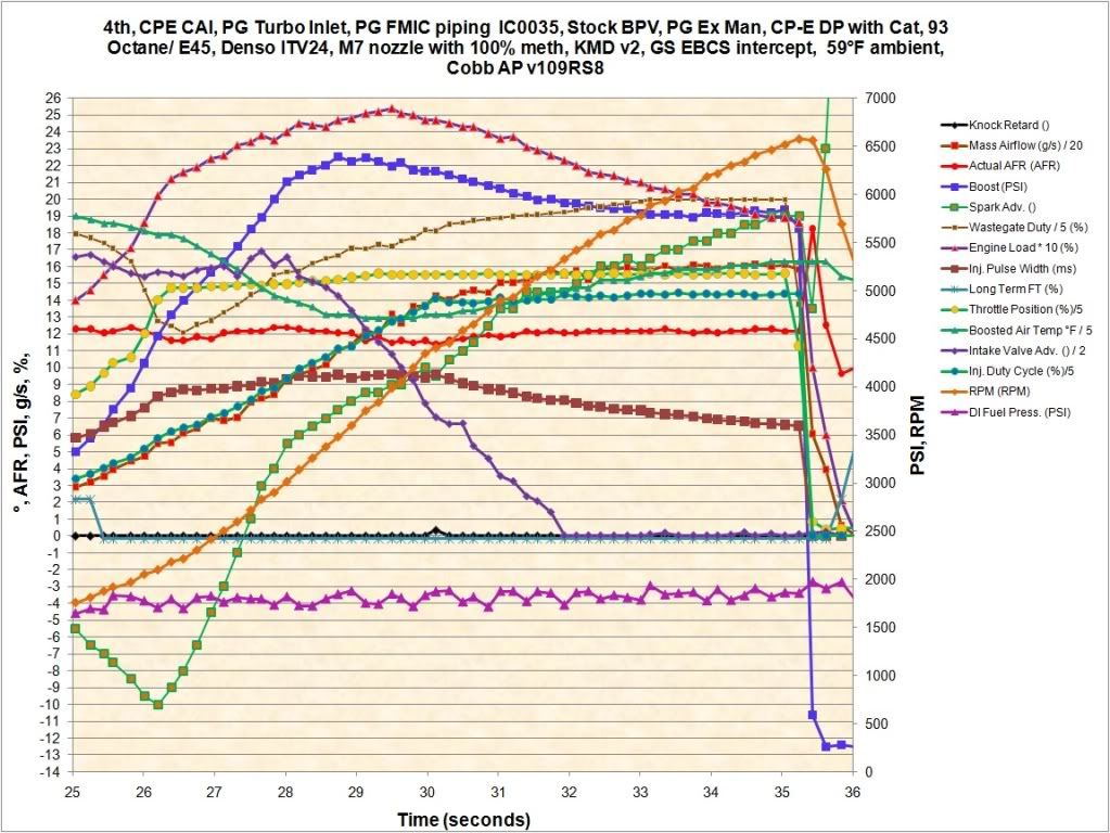

khopwood77 09-07-2011 07:31 PM
3 Attachment(s)
I've been having lots of fun with WMI 50/50 + 50/50 E85 this week. The car doesn't care what is going on outside as the temps don't seem to phase it. I did many back to back runs and they felt very consistent. I can't wait for the rain to pass so I can hit the dragstrip.
There has been something weird happening from time to time. I had my car loaded up with 2 CBE's and a passenger traveling on the highway in 4th gear. I decided to do some logs on the long ride home. It was still drying up from a rainstorm but that didn't stop me from getting some work done. Check out the attached logs. Log #2 is very "strange".
This happened 2 out of 9 datalogs. The first time it happened I had traction control on and I noticed the traction light flash. I turned it off but it still happened again without the light flashing. Is this a symptom of the SWAS?
Dano 09-07-2011 07:50 PM
didn't look at logs but if it shit itself went way rich and pulled a ton of timing...your answer is yes.
http://www.mazdaspeedforums.org/foru...disable-90739/
khopwood77 09-07-2011 07:54 PM
That's exactly what it did. Thank you!
BlueStreak 09-07-2011 07:58 PM
Originally Posted by khopwood77 (Post 1032469)
I did many back to back runs and they felt very (in)consistent. I can't wait...to...(s)hit (on) the dragstrip.
There has been something weird happening from time to time. I had my car loaded up with 2... passenger(s) traveling on the highway in 4th gear. I decided to do some logs on the long ride home. It was still drying up from...the (shit) storm but that didn't stop me from getting some work done. Check out the attached logs. Log #2 is very "strange".
This happened 2 out of 9 logs. Is this a symptom of the SWAS(S)?
Fixed.
Dano 09-07-2011 07:59 PM
just looked and its and easy try to fix.
khopwood77 09-07-2011 08:28 PM
Originally Posted by BlueStreak (Post 1032509)
Fixed.
Thanks Blue :firedevil: It only seems to happen when its wet out and I lose traction. It's very consistent otherwise and I'm really pleased with the way the car deals with the outside air temps.

cld12pk2go 09-09-2011 03:52 PM
Still working up the timing....
So far so good:
http://i77.photobucket.com/albums/j6...R/090911-1.jpg
Peaking at 19° at 6500 RPMs.
I am 2.5° less than Phate's final best timing from 3000-5000, then 4° less at 5500 and 5° less at 6000-6500RPMs.
I am going to add another 0.5° at 5500 and 1° at 6000-6500 on my next map. I doubt I push any further than that to be prudent as Phate's engine might be a bit different than mine.
The car simply rips.

Dano 09-11-2011 09:51 AM
I am on my 3rd car tuning now that no matter what you do to MAF, fuel tables [even beta clutch tbls], LTFT breakpoints, etc, car runs lean around spoolup. Yours is def later but DJ has had the same spoolup lean issues with other cars.
There must be some more fuel tables out there we don't have access to.
This may not even be your issue but I thought I'd post up my findings on leanness. Without meth my car does the same thing but only sometimes.
