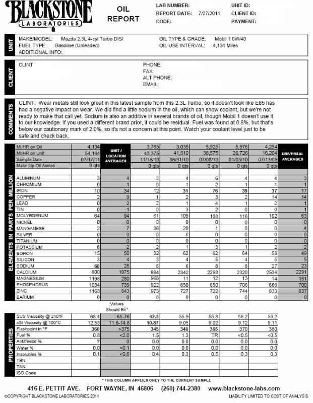

Here's the most recent UOA:
http://i64.photobucket.com/albums/h1...50050Miles.jpg
Note: This is NOT with Mobil 1 0W/40. This is Rotella T6 5W-40. For some reason, they still have the 0-40 on file from my Mercedes...
