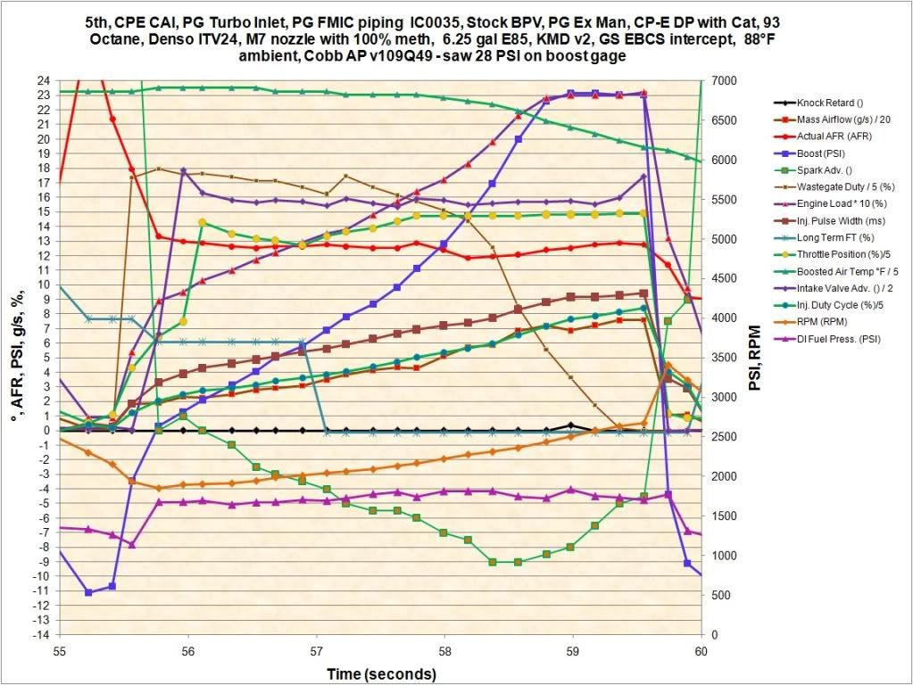

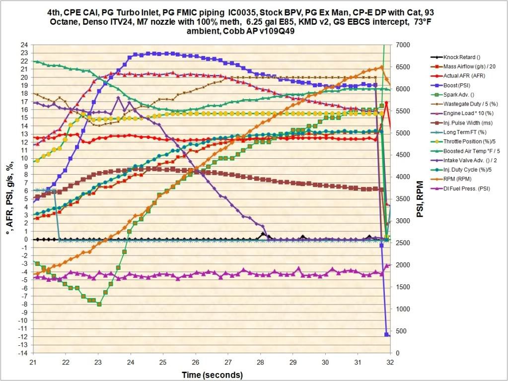

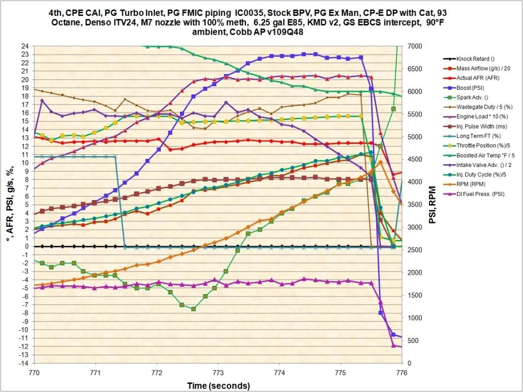

cld12pk2go 08-09-2011 06:58 PM
So more E40 love on the way to work today.
Everything is cool. Still pegging the stock 2.5 Bar MAP sensor around 23 PSI.
Loads in check around 2.05 as desired.
http://i77.photobucket.com/albums/j6...R/080911-1.jpg

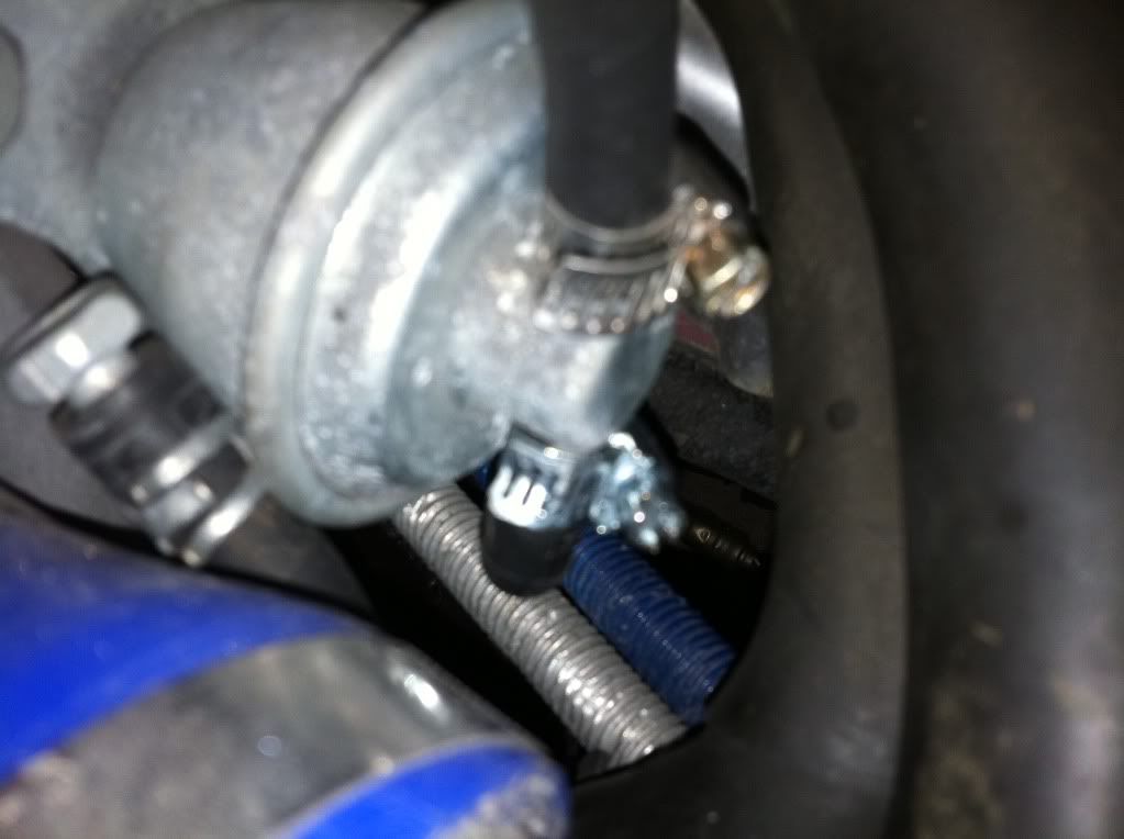

On the way home I got a heck of a surprise when I saw my boost gage shoot to 28 PSI!
Nothing like 28 PSI and 2.3 load at 2400 RPMs to get the sphincter puckering... :smileeek:
http://i77.photobucket.com/albums/j6...R/080911-2.jpg
Fortunately I lifted immediately (not a bad reaction time between recognition of problem and lifting or perhaps I just got lucky) without issue and found the following when I got home:
http://i77.photobucket.com/albums/j6...aponnipple.jpg
I had lost the bottom cap on the WG nipple some how on the drive to work after the initial pull, which makes sense given how the ECU was forcing the WGDC to zero trying to decrease load in the afternoon pull.
New one is clamped on tight with a hose clamp:
I do not wish to think about how this might have gone down on 93 octane...
However, this is another interesting data point showing how strong the stock bottom end is when you aren't knocking...
Also it would appear that my new clutch is going to be able to handle what I am planning to throw at it. :drive:
