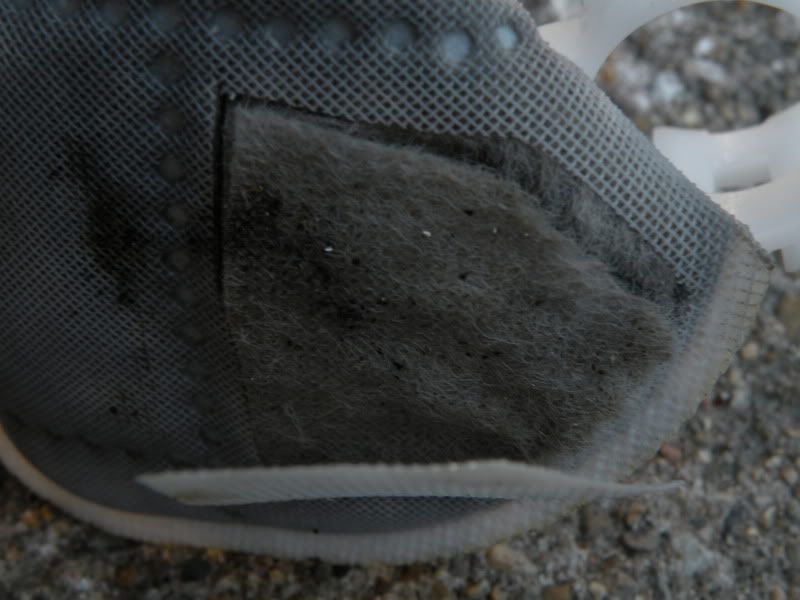

So we dropped the tank, all went well. It only took a few hours. Everything in the pump assembly looked fine, except for the filter. The filter, which is a tiny POS on the inlet of the pump, was almost black with nasty dirt. It had so much sediment, it was very heavy compared to the one on my replacement pump. I am 99% sure it was the filter causing a huge restriction on the inlet of the ITFP.
But, I went ahead and replaced the entire pump assembly, only reusing the fuel level float. So we dissected the pump and regulator to look for anything odd. Every bit of it looked fine. All plastic pieces were intact, the pump motor spun freely, there wasn't buildup anywhere inside of the pump. The O-rings on the regulator looked brand new, and the rubber flapper valve was intact and functioning properly.
The filter material was still intact, and obviously doing its job. I am pretty confident in saying the ethanol is not eating anything in the fuel pump assembly. Though, it may be an indirect cause of the fuel filter clogging. I am unsure if this was 55k miles (total on car) worth of dirt, or 5k (total on e85) miles worth of dirt. In 5k or so miles, I'll re-inspect the new filter.
Aside from that, I have noticed significantly more buildup in the HPFP since the stock internals went back in and the ITFP started to die. It could be dirt getting past the ITFP filter, or it could be tied to cavitation in the HPFP due to lack of supply from the ITFP. I'm going to pull the HPFP tonight and clean everything. Hopefully I'll see this buildup subside from the current rate. I haven't been running the in-line filter for a few weeks, now, so I may put it back in.
On the positive side of increased buildup, I scraped together a good sample to send to Blackstone. I used a brand new razor blade to prevent cross contamination as much as I could. I'm going to compose a letter summarizing my entire experience. Hopefully they will be able to get some results. I'll post a copy of my letter here.

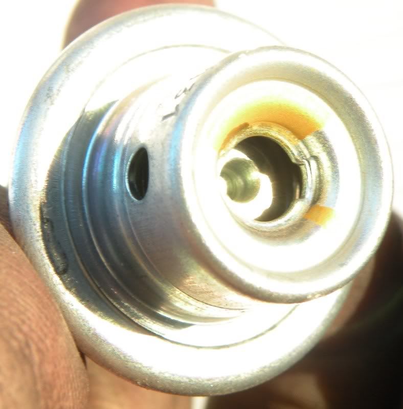

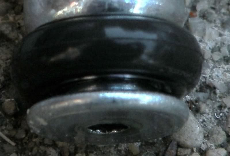

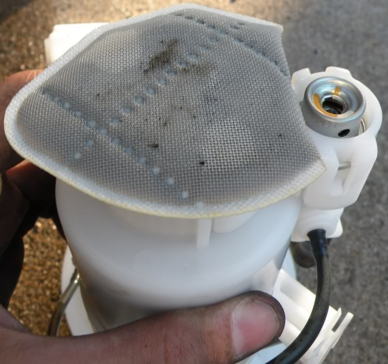

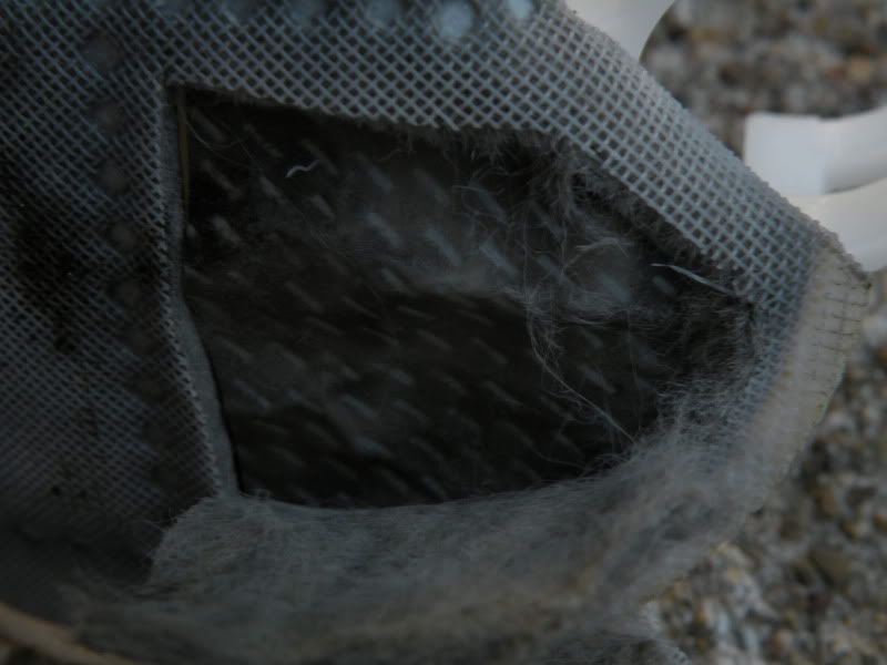

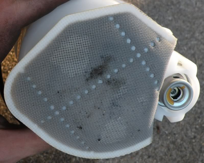

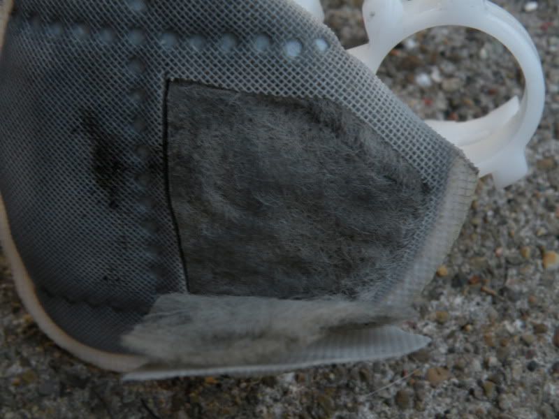

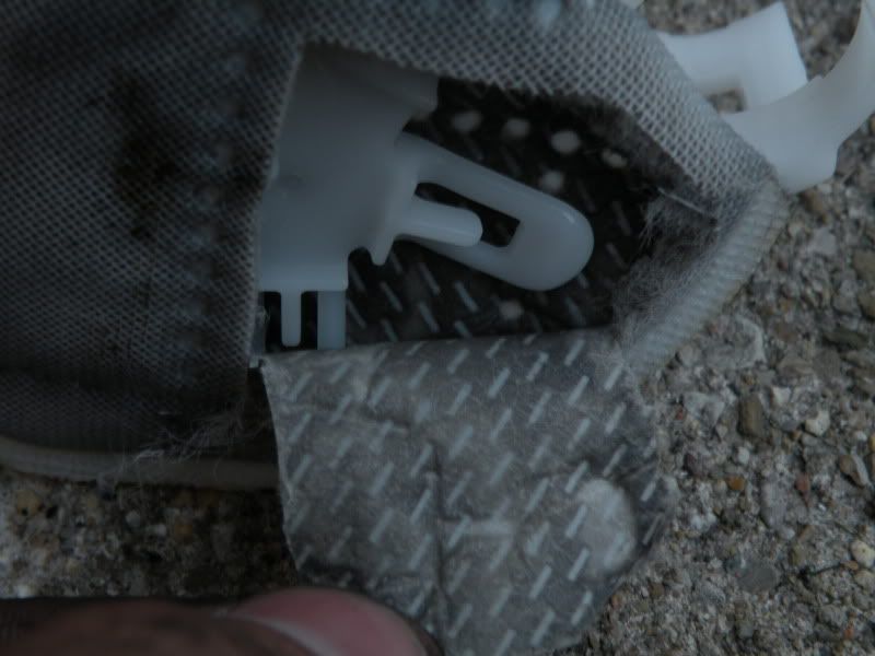

phate 08-12-2011 08:51 AM
I haz interweb :)
http://i64.photobucket.com/albums/h1...0/DSCN3167.jpg
http://i64.photobucket.com/albums/h1...0/DSCN3168.jpg
So I chopped the filter apart in layers:
http://i64.photobucket.com/albums/h1...0/DSCN3176.jpg
http://i64.photobucket.com/albums/h1...0/DSCN3177.jpg
http://i64.photobucket.com/albums/h1...0/DSCN3178.jpg
The inside portion (pickup side) of the filter is dirty:
http://i64.photobucket.com/albums/h1...0/DSCN3179.jpg
http://i64.photobucket.com/albums/h1...0/DSCN3181.jpg
And a few other pieces:
http://i64.photobucket.com/albums/h1...0/DSCN3169.jpg
http://i64.photobucket.com/albums/h1...0/DSCN3172.jpg
http://i64.photobucket.com/albums/h1...0/DSCN3174.jpg

Enki 08-12-2011 09:45 AM
Looks like you might be just fine with a filter replacement and a good old fashioned scrubbing of the gas tank (if that's even possible). Maybe toss a gallon of methanol in there and swish it around for a few minutes to really get all the nasty shit out.
If you do that, take a pic of the result :)
Edit: New internals? What happened to the old ones?

The inside of the gas tank looked clean. There was a little bit of debris floating around, but nothing serious for 55k miles worth of fuel. Gas tank is back in the car with the new fuel pump assembly. It was definitely an issue with the ITFP, as I'm seeing 1900psi out of the stock pump when I get into boost a little bit. It can't supply enough fuel, of course, but I'm seeing way more pressure than I was before.
Internals were my first though, so I sent them in to KMD for warranty. Apparently they tested bad, as well, so I'm getting a new set.
