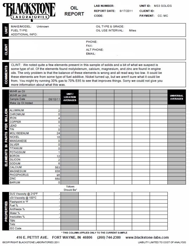

Well, this exercise wasn't as helpful as I wanted. UOA for the black death:
http://i64.photobucket.com/albums/h1...MS3_Solids.jpg
Enki 08-17-2011 03:31 PM
The high amounts of magnesium and zinc make me think it's eating something; not sure what the calcium would be from though.
*Toodles off to find chemical formulae for fuels and additives*
phate 08-17-2011 03:34 PM
Guys, remember this was diluted in something for the test. The actual PPM count is meaningless. Only the ratio is valid, here.
Edit: Maybe not. I'll call them tomorrow to verify how they tested the sample.

Probably already saw this, but I think it's worth posting:
NASIOC - View Single Post - E85 Injector Build-up / Gunk
At this point its only a handful reporting this issue....The general consensus is, it is fuel related & not any of the ethanol approved lines / other components in the EVO (Anyway I hope not)...I would hope the WRX & EVO have similar component builds that are ethanol compliant......Heres a cut/paste from some type of Engineer who analyzed the material.....Glad to hear all's well over here.......Peace
Well, here is what I did just so everyone is clear. I filled a 40mL vial with E85 and blew it dry with nitrogen gas and mild heating (about 150*F). After there was no fuel left, I placed it under high vacuum to remove any remaining volatiles for about an hour. I was left with a clear sticky residue that smelled bad - like nasty frying oil. I dissolved this sample in the NMR solvent and analyzed it and it IS the same goo that was on the injector. There was smaller amounts of some other stuff in it as well, but the same peaks I saw in the black goo were in this residue. The black goo IS coming from the E85. It isn't naturally black, though. I suspect it just has soot mixed in with it that is giving it the color.So the next challenge is figuring out why is this crap in our fuel, and if it is in everyone's fuel (particularly people who aren't having this problem).

Would be nice to know what the composition of said "gas cum" is; with that knowledge, there might be a way to dissolve or permanently suspend it in the tank so it doesn't adhere to anything.
I'm still digging, will post more info if I find anything of note.

triplejumper18 08-17-2011 04:19 PM
I wouldn't rule out that it could be your E85 source as well. Just another idea.
Enki 08-17-2011 04:20 PM
I was just thinking this; it would be worth a phone call to the station where you fill up to find out whether or not you're the only one who buys e85 there, and how often they refill/clean the tank.
