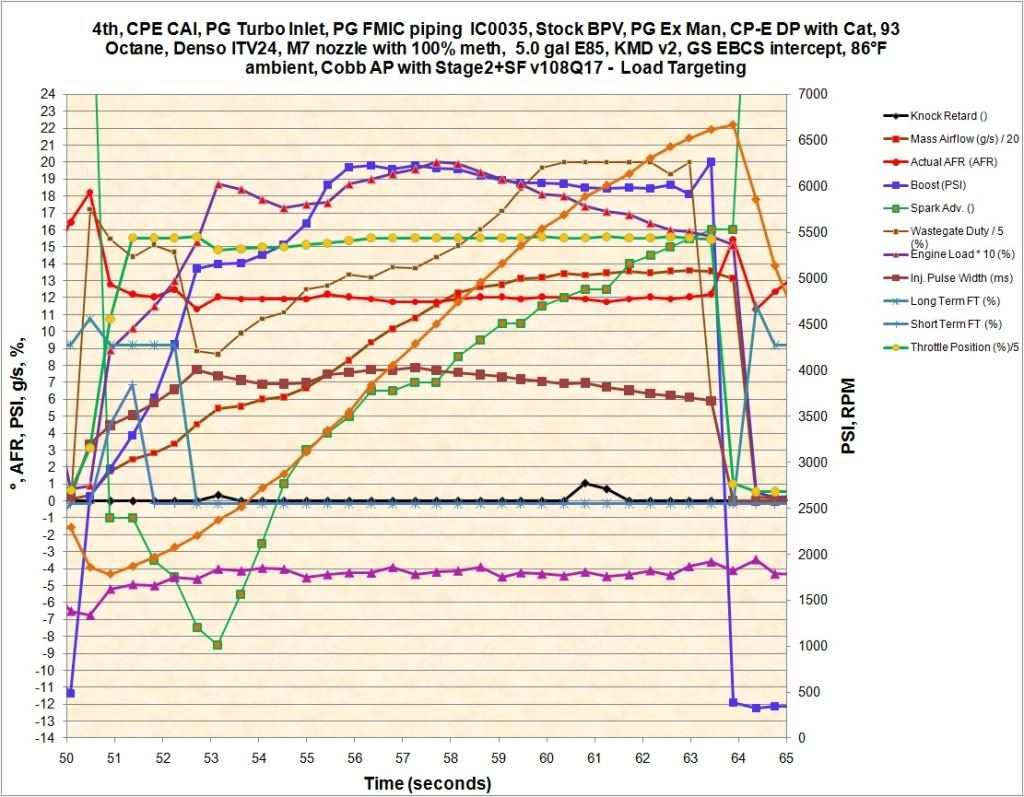

cld12pk2go 05-18-2011 03:57 PM
Originally Posted by Lex (Post 857237)
We already discovered that the ECU injects fuel during the compression stroke when DJ measured the injectors and superimposed it to the crank position signal.
cld12pk2go, the ECU still uses LTFTs up to around 240 g/s airflow. Are you maintaining the correct AFR even beyond that?
Here is a log from about a week ago that shows mid 270 g/s (MAF curve properly calibrated for ~+/-2 LFTF on gas):
http://i77.photobucket.com/albums/j6...R/051211-2.jpg
AFR flat well beyond 240 g/s...

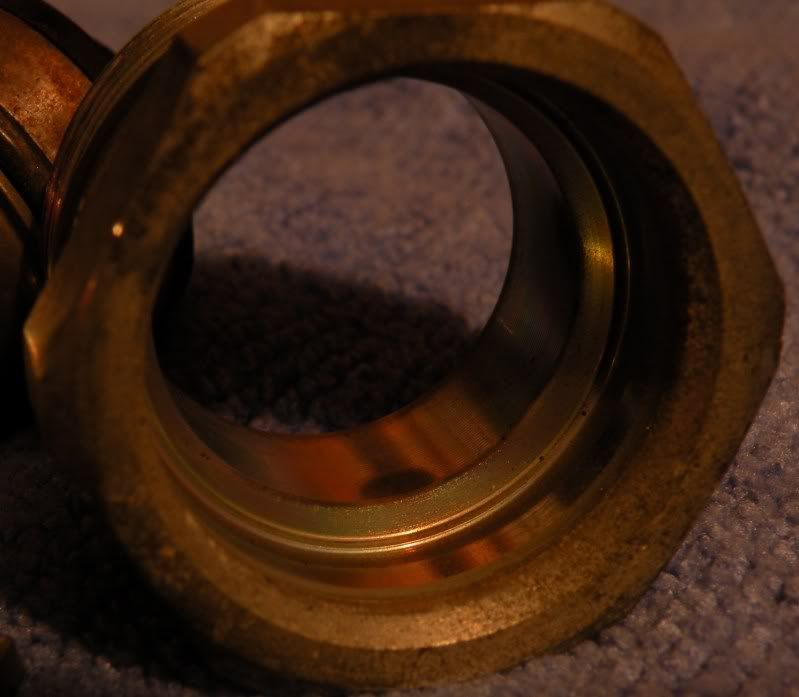

Back on track for a second. I pulled the spill valve solenoid last night, and it had a light coating of residue on it. Not black nasty crap, but just enough to make the solenoid malfunction. Cleaned it up, and its running perfectly. The spill valve parts, though, look much, much better after this 250 miles. There was no gunk buildup on them, so I just put them back in without cleaning.
I pulled apart the solenoid and took some pics, but I left my camera in the garage. I'll upload the pics tonight and update this post with them.

amoosenamedhank 05-24-2011 10:34 AM

As promised, this is the spill valve solenoid taken even further apart. This pic shows the normal position of the solenoid in the background. The foreground picture shows how it pushes out just a little bit.
http://i64.photobucket.com/albums/h1...d/DSCN3137.jpg
That little groove in the foreground solenoid is where the split ring lock sits. The split ring lock simply keeps the solenoid from pushing back through the sleeve. You can sorta see how the two halves should sit in that groove here:
http://i64.photobucket.com/albums/h1...d/DSCN3140.jpg
Once the two lock halves are out, you just push the solenoid back through the sleeve (towards the connector end):
http://i64.photobucket.com/albums/h1...d/DSCN3141.jpg
And that's about it. This is the sleeve. You can see where the O-ring on the solenoid sits:
http://i64.photobucket.com/albums/h1...d/DSCN3145.jpg
Nothing spectacular, but I thought the overall design of the spill valve and solenoid is pretty neat.

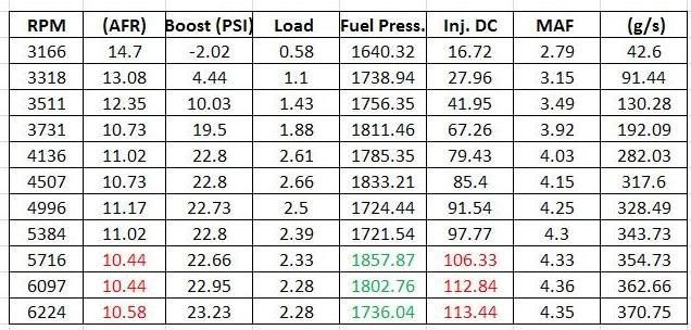

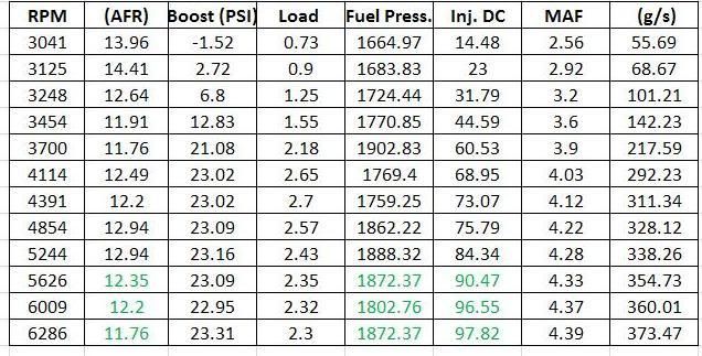

phate 06-09-2011 10:20 PM
Ok, guys, I've been driving the car quite a bit lately with nothing unusual to report. No pressure loss and the car seems to run well, overall. I think the MAF scaling has thrown off the tip-in enrichment: in a cruising scenario around 1500-2000 rpm the car hesitates slightly if you give it too much throttle too quickly and it goes a little lean. Nothing I'm worried about, its pretty easy to drive around.
After wasting a bunch of time with load tuning the car, I have switched to boost tuning. I've been slowly (I mean creeping) increasing the boost and watching injector duty cycle/AFR/how the car runs. In the last couple of days I've tried to do some comparative testing of fueling, but just changing the top end fueling and leaving other parameters has proven troublesome.
I have a 12.2:1 AFR tune that pulls hard and smooth all the way up to my rev limiter of 6150rpm. Changing this tune to 11.2:1 (and only changing the fueling tables) results in lower WGDC and ~.5lb less boost over the entire upper rev range (>4k rpm). This occurs even after I increase WGDC targets in the richer map by ~1 point (I will play with this more in the future). Between the fueling and lower boost, the rich(er) tune feels much slower than the 12.2:1 tune. In both tunes, I feel I am running very conservative timing with only 4° @ 3k rpm up to 11° @ 6k rpm.
The 11.2:1 tune has hit an injector duty cycle of 106.09%, but I can't see or feel a difference in how the car runs at >100% duty cycle. The 12.2:1 tune decreases the max injector duty cycle by ~8% to a max of 96.x% (obviously).
The last observation I have with the E85 - high BAT's don't seem to phase how the car runs any more. I have seen ~140* BAT's and the car still pulls damned hard. I've slightly reduced the amount of timing pulled for high BAT's and it runs well.
Anyway, I could continue to ramble about this stuff, but I'll just attach the datalogs so you guys can check it out. [MSF now supports .xlsx files!!]
