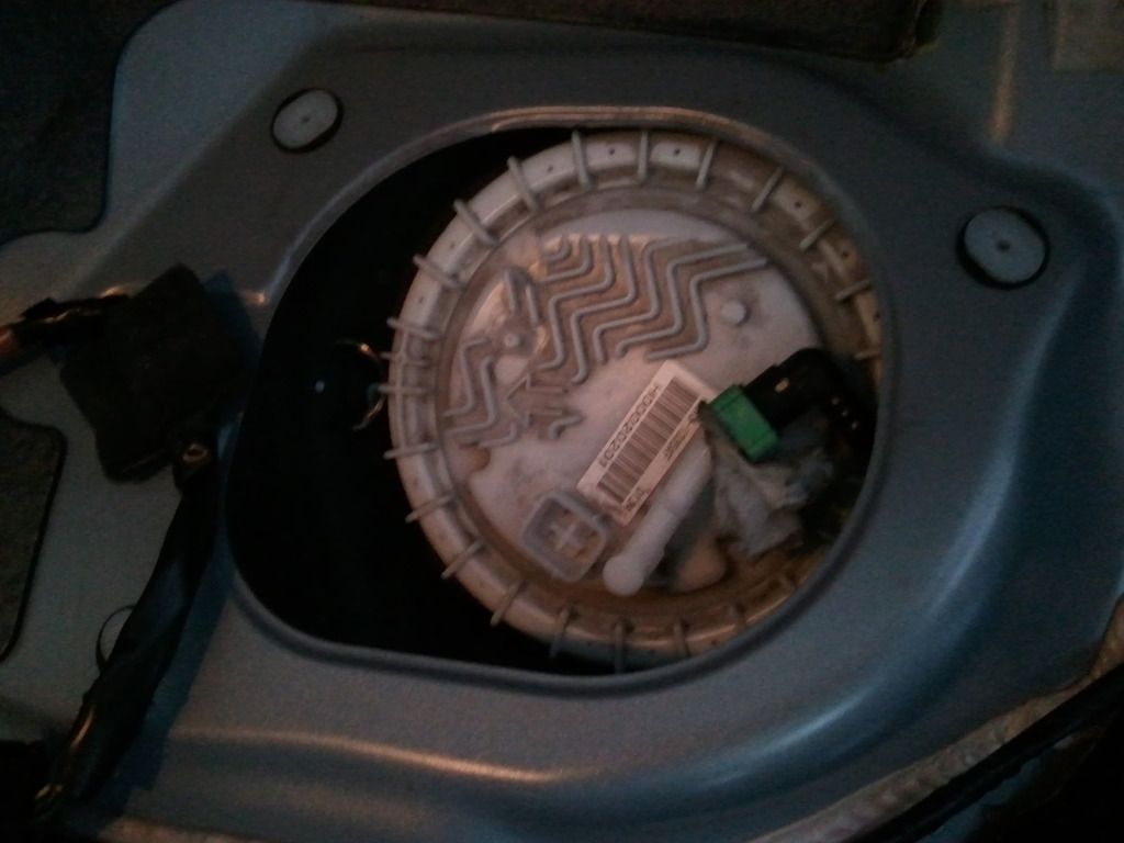

You still coming to my place this weekend? I would be interested in pulling the in-tank fuel pump and having a look, just to see if the sock and lines are in good shape. Have you pulled the primary fuel filter apart to inspect since going E85?
phate 07-18-2011 11:38 AM
Yeah, I'm planning on it. I'll send you a PM about the address. I haven't checked out the in-tank pump/sock filter, and I kinda doubt we see anything out of the ordinary.
silvapain 07-18-2011 04:41 PM
I still suspect the buildup you're seeing on the CDFP internals is from fuel line/component deterioration.
There is an E85 station on the southside of Kankakee at exit 308, so you could run nearly empty to make dropping the tank easier (if there isn't an access hole under the rear seats already; I've never looked), and can fill up afterwards.

phate 07-18-2011 05:16 PM
Seriously? As I was headed back from the Museum of Science & Industry this past Saturday, I stopped at that exit and asked around about E85. The one seemingly knowledgeable person said the closest one is now in Manteno...So I drove my ass back 10 miles to the Gas City where the E85 was almost as much as 87 octane!
Originally Posted by bewsted (Post 941736)
Man you guys are making me want to drive up there now.....Access hole, drop that tank, sounds naughty
Oh yeah, it's gonna get dirty.

you can access from back seat but u need a SST to get the cap off the tank
silvapain 07-18-2011 07:07 PM
SST?
superskaterxes 07-18-2011 07:11 PM
super special tool lol (no joke)
its like this 4 prong wrench thing that locks these tabs in place while u unscrew the cap. HUGE PITA if u dont have this. its in the service manual if u wanna see a pict.

@silvapain - I'm pretty sure I don't want to dick with the fuel tank because of this.

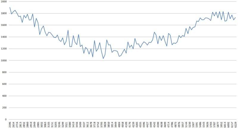

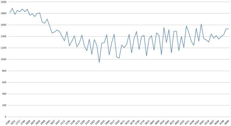

Update
Fuel Pressure is dropping :(
.82 lambda tune
http://i64.photobucket.com/albums/h1...85_120_240.jpg
.86 lambda tune
http://i64.photobucket.com/albums/h1...85_126_248.jpg
This is not what I wanted to see tonight. I'm letting the car cool off right now. In a little bit, I'm going to pull the CDFP to check out the internal situation. I'm also going to remove the in line fuel filter, just in case it is creating a restriction. It's a long shot, but this wasn't happening with the other two filters.

Enki 07-19-2011 10:05 AM
Originally Posted by phate (Post 942192)
Update
I saw the start of this in one of the first logs you posted (as a graph). The place where all stock pump MS3s have a fuel hole your pressures had dipped slightly as well.
Hopefully it's a cleaning thing and not something worse.

Soooo, I just checked the service manual. We definitely have to drop the tank to pull this thing out. And we won't have the SST to pull that cover piece off. What do you think, Daniel?
josurr 07-20-2011 09:57 PM
Really? Must be a Gen1 design fault... with the Gen2 you can remove the back seat, use the SST to get the cap off, then just pull the fuel pump unit out after disconnecting the lines and wires.
Edit: Nevermind, overlooked step 9 which says remove, tank, breather hose, fuel hose, and fuel pump unit as a single unit.

just because the manual says you have to do it doesn't make it so. They are VERY over cautious.
Example: They say to replace the clutch you have to remove the engine cradle...not so. Tranny can be removed without removing the cradle.
phate 07-21-2011 08:37 AM
I pulled the inspection plate, beneath the back seat, last night. The hole only uncovers enough to remove the electrical connector and evap line. It only allows access to about 1/3 of the top piece that needs removed with the SST. The tank definitely needs to come out.
superskaterxes 07-21-2011 08:37 AM
im pretty sure theres just a tiny tab u need to trim to get the pump out from the top.
im pretty sure sean @socks posted a buncha picts of this in his dual pump setup thread.
phate 07-21-2011 08:43 AM
You're right, I just looked at his thread. He just cut the opening quite a bit larger. Not sure if I want to do this or not...
bewsted 07-21-2011 08:57 AM
Dont be scared..lol
djuosnteisn 07-21-2011 08:58 AM
Here's the access hole on ms6:
http://i359.photobucket.com/albums/o...n/312d3cd0.jpg
And my $.02 on enlarging it is..... well... sure as hell makes it alot easier to swap the pump, hahaha. Might be a blessing, especially when playing with alternative fuels.
bewsted 07-21-2011 09:01 AM
You not going to lose any structural strength trimming that hole out to be able to remove that thing.
djuosnteisn 07-21-2011 09:02 AM
Only thing you may want to do is enlarge the plate as well, so you can keep the fumes sealed off from the cabin. But that'd be simple.
triplejumper18 07-21-2011 09:08 AM
My friend Josh who is parts manager at Camelback Mazda/Subaru in Phoenix is going to be having stuff like SST's and timing tools for rent shortly.
socks 07-21-2011 09:32 AM
Yep, took a dremel to that bad boy. You'll want to put some trim around it to prevent it from cutting any fuel lines though.
Dripping the tank is no problem; getting an SST is the issue.
Let me call my local Mazda dealership and see if it cam be bought or rented from them.
Just for reference, the Mazda P/N for the SST is 49 F042 001
djuosnteisn 07-21-2011 12:54 PM
I'm sending the SST tonight. Should be at phates early next week i bet.
If you find one closer, just lemme know so i don't send this one.
superskaterxes 07-21-2011 01:17 PM
^^^ friendliest MSF neighbor to borrow sugar from!!!
triplejumper18 07-21-2011 01:32 PM
Originally Posted by superskaterxes (Post 947208)
^^^ friendliest MSF neighbor to borrow cocaine from!!!
Corrected for truth
djuosnteisn 07-21-2011 03:20 PM
^^^ friendliest MSF neighbor to snort coke lines off his pecs!!!
Even moar corrected
triplejumper18 07-21-2011 03:28 PM
^^^ friendliest MSF neighbor to snort coke lines off his pecker!!!
It's evolved into greatness.
phate 07-21-2011 03:33 PM
So here's the diagram of the MS3 fuel tank and assembly, for everyone's reference.
https://www.mazdamotorsports.com/wcs...79691_1000.gif
Mazda Motorsports prices:
42-167 - BN8F-42-167 - Union Nut - $30 - This is what the SST is used on.
13-ZE1 - LFB6-13-ZE1 - Fuel Filter - $13
13-350A - L3M8-13-350B - Fuel Pump - $123 [2010-2011 models use the same pump]
13-280A - L3M8-13-280 - Fuel Pressure Regulator - $22
13-ZE0 - L34B-13-ZE0 - Fuel Pump Body - $38
13-350 - L34B-13-35Z - Fuel Pump Assembly (4 parts, above) - $149
Edit: It looks like L34B-13-35ZA superseded the L34B-13-35Z referenced above. It's still the same price from Mazda Motorsports.
2010 & 2011 use the same fuel pump L3M8-13-350B.
The fuel filter is referenced through the 2010 model, so 2011's may use a revised version of this. I'll dig around.

socks 07-22-2011 09:37 AM
I thought the one that was tested was 155lph?
i'd have to dig through whoosh's posts though. a single walbro isnt a "drop in fitment". you'd have to use an external regulator, and have the pump flop around in the bucket. then you'd have to find a way to retain the stock venturi system in the bucket unless you want to have to keep your tank level above 1/4tank all the time.
Thats why i did the dual setup. Two pumps physically kept eachother in place, i used an external filter and regulator, and used the regulators return to maintain the stock venturi system, so the bucket would stay full even at low tank levels.
phate 07-22-2011 09:37 AM
I don't think Walbro makes a pump that designed for a returnless system. I know vortech makes one, and I'm pretty sure we could use it, but it's a little more cash than a Walbro.
socks 07-22-2011 09:44 AM
here, have a looksee.
if you take the data from the 12.3v sheet @ 65PSI
245 lbs per hr / 6 = 40.83 g/p/hr
(the 6 represents 6lbs for a gallon)
the conversion to l/ph = 3.7854
40.83 x 3.7854 = 154.57 l/ph @ 65PSI & 12.3v
Reference:
in tank OEM fuel pump flow data - Mazda 6 Forums : Mazda 6 Forum / Mazda Atenza Forum
Dano 07-22-2011 09:46 AM
