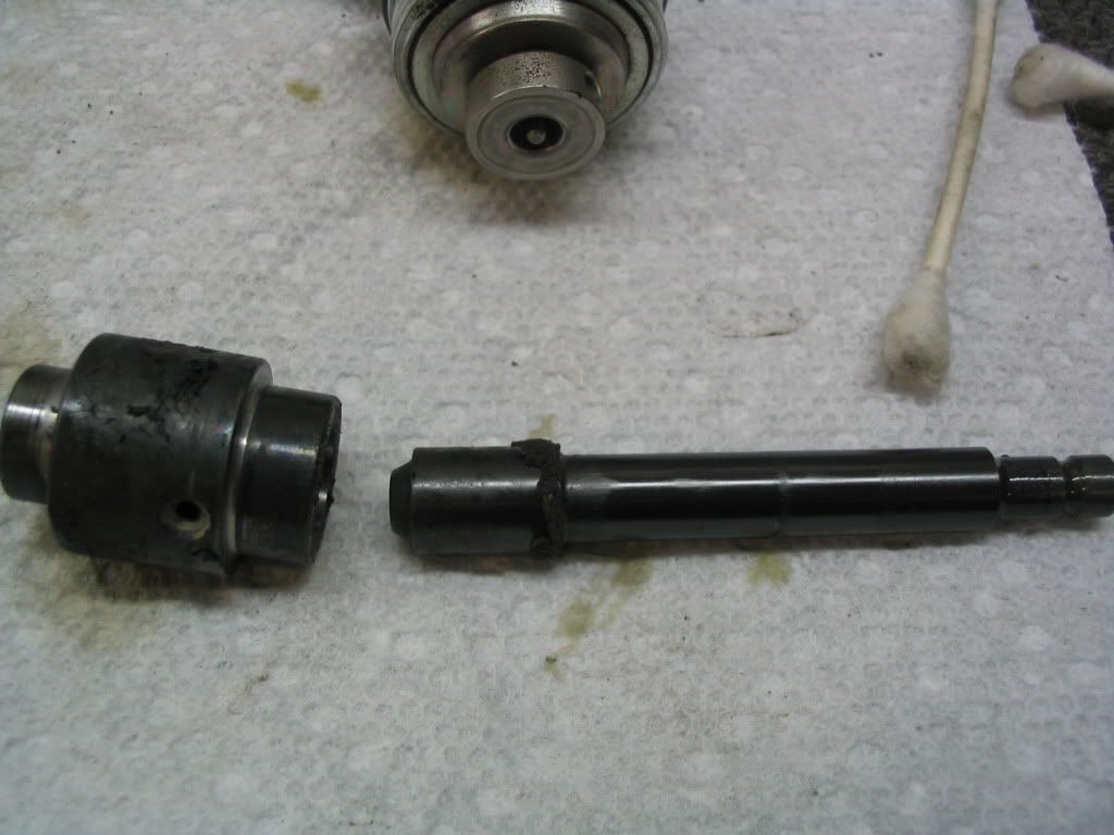

Autotech. I can easily move the piston with my hand, and the spring returns it to its original position.
Here's the O-ring by the way. There are no signs of it swelling up from E85:
http://i158.photobucket.com/albums/t...eed3/018-1.jpg
http://i158.photobucket.com/albums/t...Speed3/017.jpg
http://i158.photobucket.com/albums/t...eed3/016-1.jpg
And how my internals looked:
http://i158.photobucket.com/albums/t...eed3/010-1.jpg
Fatguy729 11-22-2011 07:28 PM
eww

Can you mic both the Autotech and stock internals shaft by chance?
Pedal-Force 11-22-2011 07:37 PM
yikes. That's some gunk. I was getting close to considering e85. Scary stuff now though. Plus, I can't even tune my car on the normal stuff...

My Autotechs show no signs of wear. No discoloration or scoring at all.
I started using MMO after the first couple times the spill valve stuck. I have probably 1000 miles on MMO.
