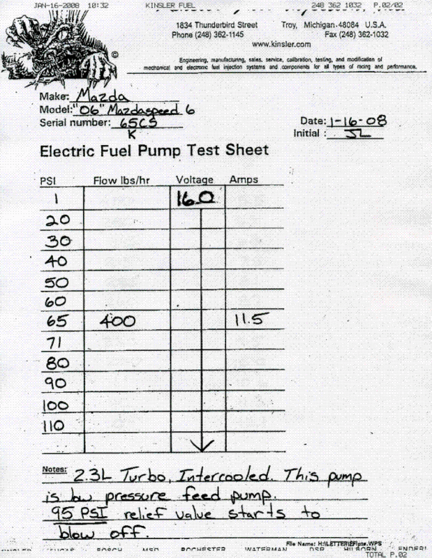

phate 07-22-2011 09:58 AM
Originally Posted by socks (Post 948656)
Ah, thanks. That's the sheet I remembered seeing, but I was thinking it was 255lph. Oh well.
BUT, the point still stands. The in tank was keeping up. I have a good number of logs showing fuel pressure staying steady. I will only consider changing the OE pump to aftermarket if it is the ethanol doing the damage to it. I hate butchering cars up for no good reason.

On the fuel pump topic:
At 16 volts, the oem pump will flow as much as a 255 though
http://i131.photobucket.com/albums/p...oosh_/ron1.gif
phate 07-25-2011 03:40 PM
Originally Posted by djuosnteisn (Post 953325)
Already shipped it last week sometime. You'll have it today or tomorrow.
I knew I wasn't crazy!!!

No real gains to in tank fuel pumps unless the stock system becomes inadequate. Because we have a positive displacement CDFP after the intake pump, it doesn't really matter if it's 80 psi or 5 psi feeding it, as long as it's enough "psi" to fill the CDFP piston chamber in the allowed time. Fuel is in compressible, so the difference in mass between 80psi and 1psi is negligible.
I just learned these lessons a couple months ago lol.
Also, when run at 16 volts, the oem in tank fuel pump will flow as much as a walboro 255.
