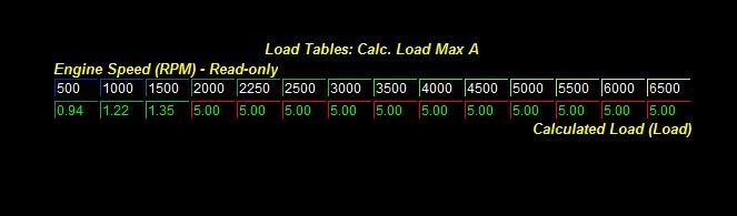

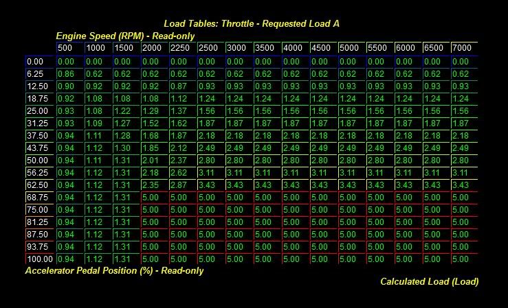

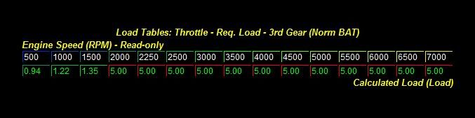

silvapain 12-11-2011 10:29 AM
Max calculated load (both the same):
http://i158.photobucket.com/albums/t...LoadMaxE85.jpg
TRL x Gear (all the same):
http://i158.photobucket.com/albums/t...RLxGearE85.jpg
Requested load (again, all three the same):
http://i158.photobucket.com/albums/t...ReqLoadE85.jpg
I checked, and you're right in that the max calc load is less than the OTS BT targets. In that case, I wouldn't worry about having them set to 4.05; I changed mine back to OTS values and will test it myself.

mrmonk7663 12-11-2011 11:39 AM
Thank you guys. Both of you. This clears things up for met :)
