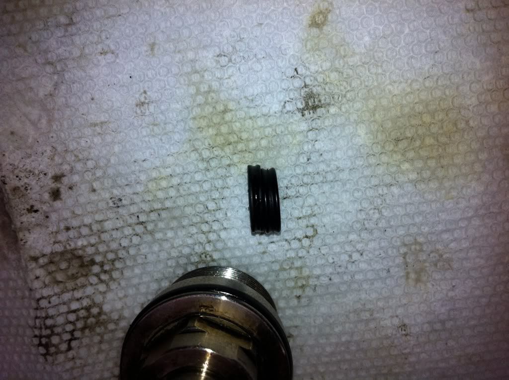

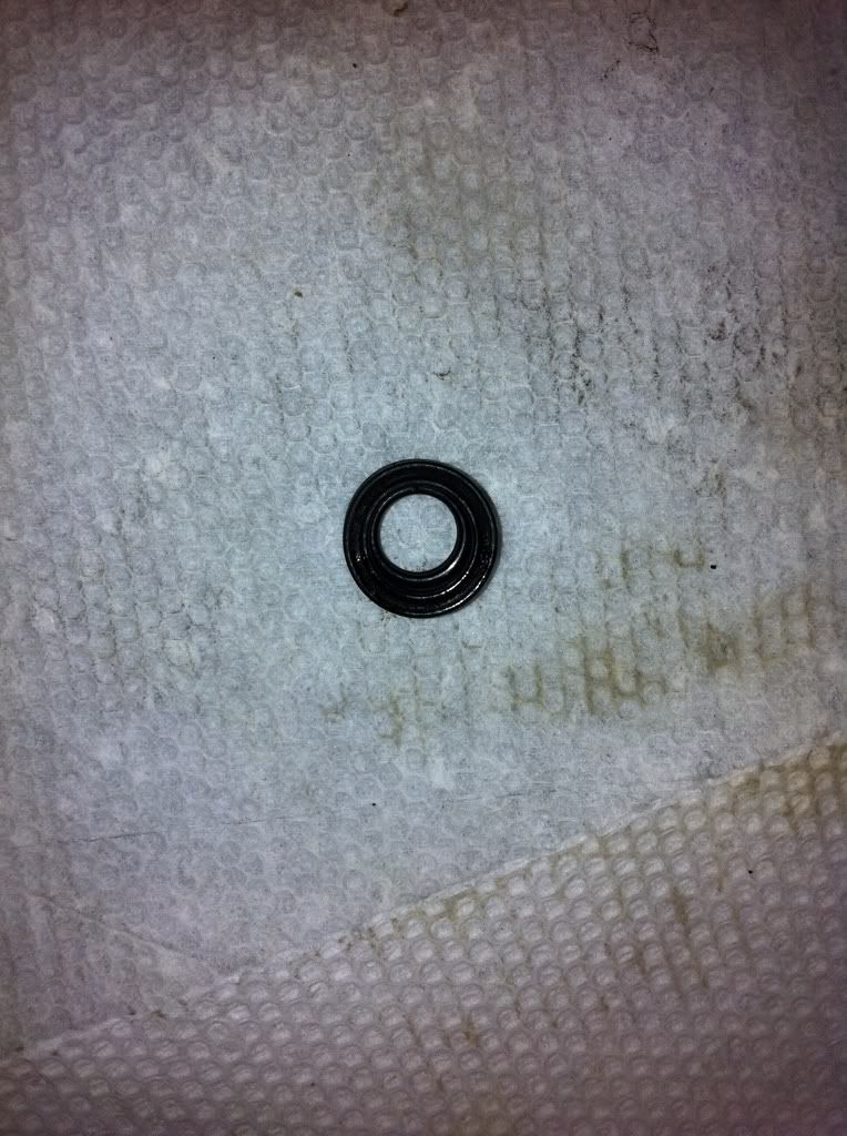

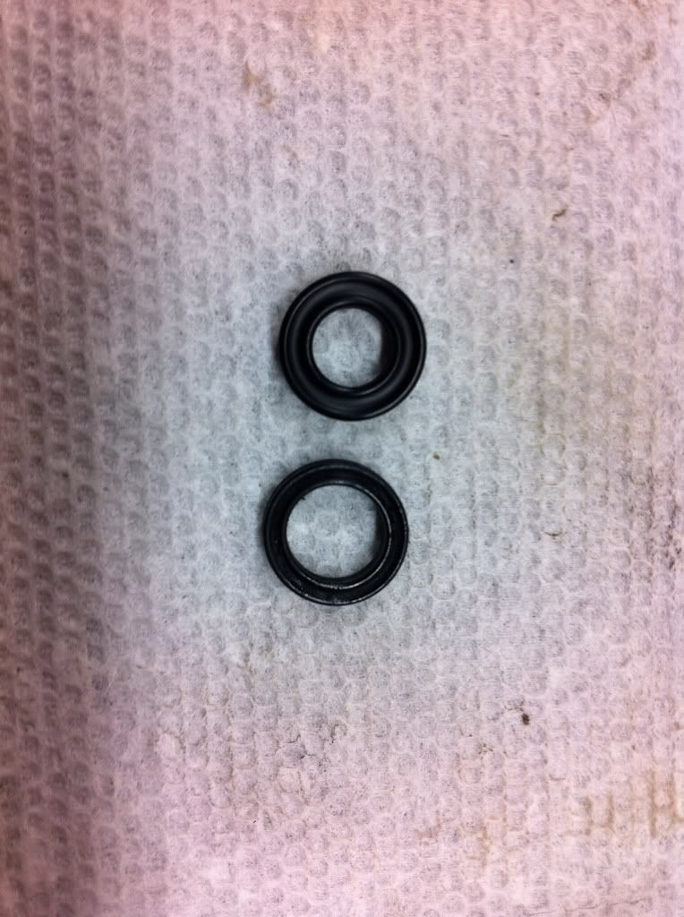

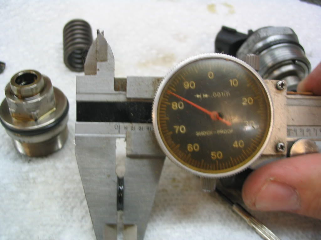

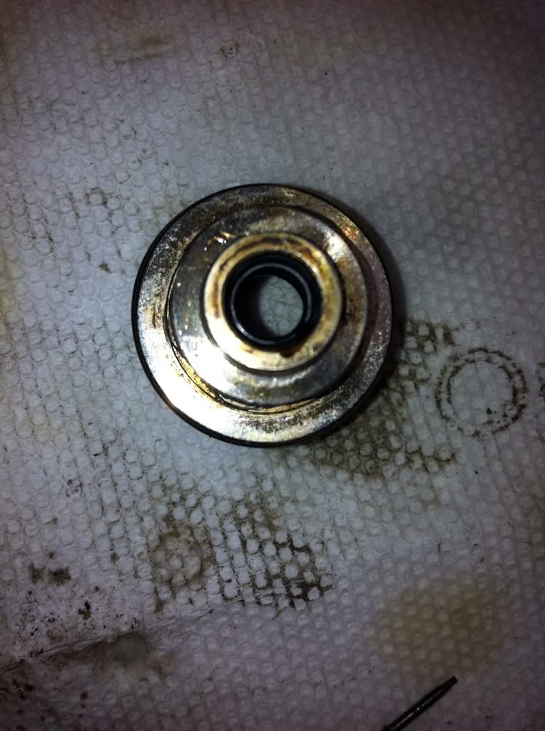

Okay, so I finally had some free time today (kids, don't grow up and become engineers if you value social lives and sleeping). I looked on McMaster-Carr's site, and found some Double-Seal O-rings (the style used in the HPFP to seal around the pump piston).
McMaster-Carr
Looking on eFunda:
eFunda: O-Ring Materials Compatibile with Chemical Gasoline, Automotive
Buna-N is compatible with both gasoline and Ethanol.
Based on my measurements, I'm going with 3/32" width 1/4" ID 7/16" OD Buna-N and try it out. If it works, I'll have plenty for others to use (the package quantity is 100).
P/N 90025K441
http://i158.photobucket.com/albums/t...eed3/018-1.jpg
http://i158.photobucket.com/albums/t...Speed3/017.jpg

How did you get the rings out? With a pick?
rfinkle2 12-25-2011 01:43 PM
Thanks for doing the research silvapain.
silvapain 12-25-2011 01:46 PM
A jewelers screwdriver. A pick would work well, too.

silvapain 12-28-2011 07:20 PM
O-rings came in. The size I ordered won't work; they are just a little too thick. After significant effort I was able to get the piston in the housing, but after just a couple pumps by hand I took it back out and there was significant wear on the O-ring. I need to look on McMaster-Carr for a smaller size.
Comparison photos:
New on top, original on bottom
http://i158.photobucket.com/albums/t...3/2dea66bc.jpg
New underneath original
http://i158.photobucket.com/albums/t...3/df900bdc.jpg
New on right, original on left
http://i158.photobucket.com/albums/t...3/352dd358.jpg
New in pump housing
http://i158.photobucket.com/albums/t...3/d7caf76a.jpg
