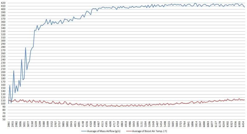

Here we go:
Originally Posted by phate (Post 1098338)
Okay, my car kinda freaked out because it's never seen BAT's like this, so it pulled WGDC in the mid range. So let's discuss the top end of these:
Average of 3 runs with normal intercooling:
http://i64.photobucket.com/albums/h1...hGearPulls.jpg

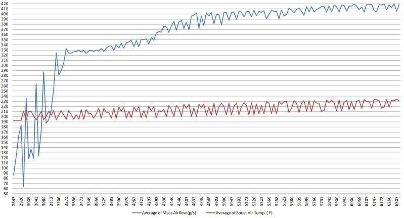

Average of 3 runs with intercooler blocked by a piece of cardboard (lol):
I'll alter my tune and get more consistent logs if anyone wants me to, but there were NO issues other than the car pulling WGDC, and therefore lowering boost/airflow up to about 5k rpm.

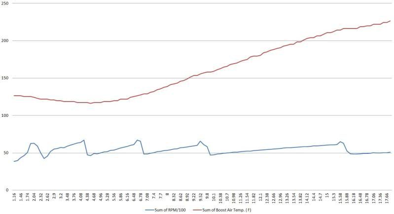

And Ziggo, you were right about the kind of temps the K04 is putting out. This is a 1st-6th gear pull:
http://i64.photobucket.com/albums/h1...ed_1st-6th.jpg
That should make you guys appreciate how much the stock intercooler really is doing.

Phate, you posted that to show bat's< temperatures listed for auotignition in the link you provided?

Consider post-compression temps of the same mass of air between a 100° pre-compression charge and a 250° pre-compression charge. Someone want to run some numbers for us???
