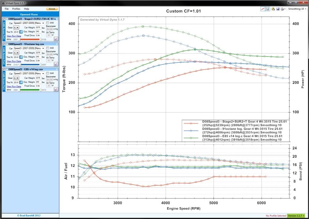

So here are the results from a guy I recently tuned:
The mods were:
2008 MS3
- K04
- COBB AP
- CorkSport TMIC
- Denso ITV22 (Gapped .28)
- HPFP Internals
- HKS Hi-Power CBE
- SURE Areos SRI
- StreetUnit Test Pipe
- Turboxs Downpipe
- Turbosmart Dual Port BOV (set to 50/50)
Using Cali 91 octane cat urine for fueling.
The baseline was using the OTS Stage2+SUR2+TIH+IC 91 v210 tune.
The 91 octane log was the most I could squeeze out without KR with the sucktastic Cali "premium" fuel.
The E85 log was just with 2 gal of E85 added per tank (the guy is an hour away from the nearest E85 pump so the minimal required to allow for extra timing is desired to minimize trips for E85), which allowed 3.5-6° additional timing from 4000+ and another 1.5-2° down low.
http://i77.photobucket.com/albums/j6...uningGains.jpg
I was quite impressed with how much extra timing was allowed by the 2 gal of E85.

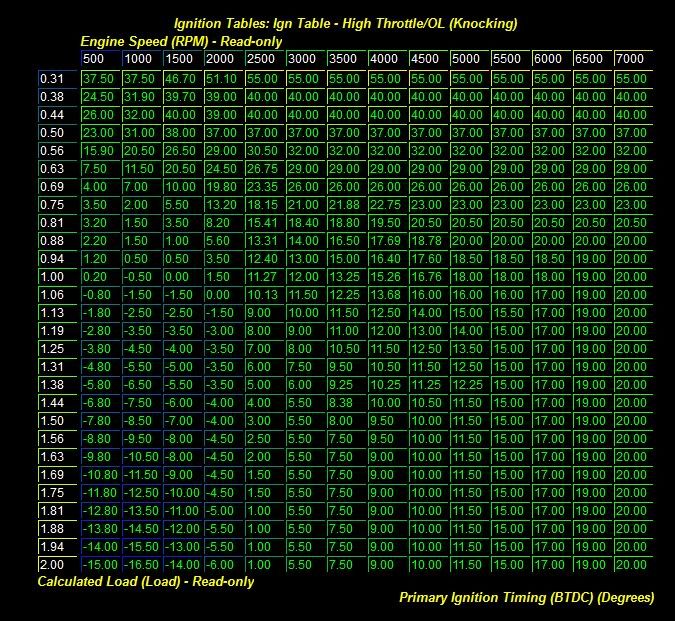

OTS timing:
http://i77.photobucket.com/albums/j6...tionTiming.jpg
Best 91 octane timing:
2 gal E85 timing:
I probably could have pushed another 1-2° from 3000-3500 and 5500-7000 RPMs, but wanted to play conservative. I did get small hits of KR in the 4000-5000 range intermittently at the current timing, but nothing overly concerning.
