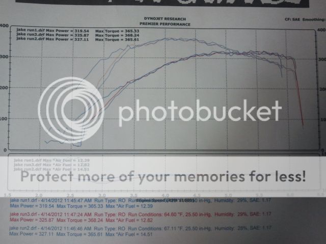

sleepyspeed6 04-15-2012 03:14 PM
Alright so went to the dyno yesterday, this is my car with 19° timing 4.5gal of e85
http://i427.photobucket.com/albums/p...4-14181319.jpg
