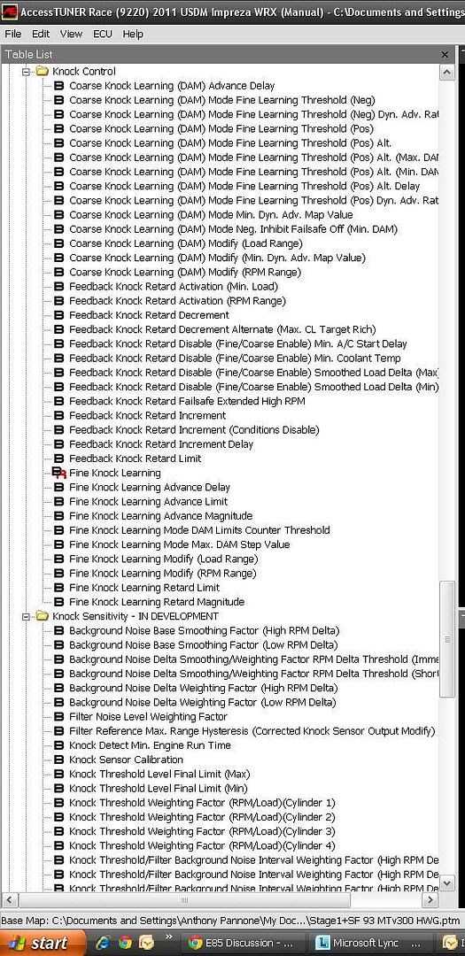

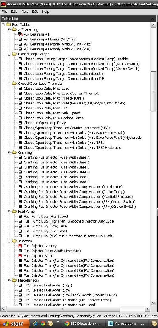

have you guys ever seen ATR for the scoobies? if you think this is anywhere NEAR the amount of fuel tables we have your crazy. this may be all we need to work with at this point but i would guarantee there is gona come a time when we need more tables to be discovered.

heres a little snippet of what im talkign about, it would be REALLY nice to have that kind of knock control too.........

Neat, but I don't think the end user needs access to 50+ fueling tables, especially with some of the redundancy up there. Hell, and "Auto populate" feature would be nice for stuff like the cruise control tables, etc.
