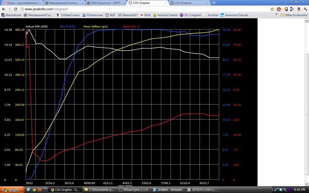

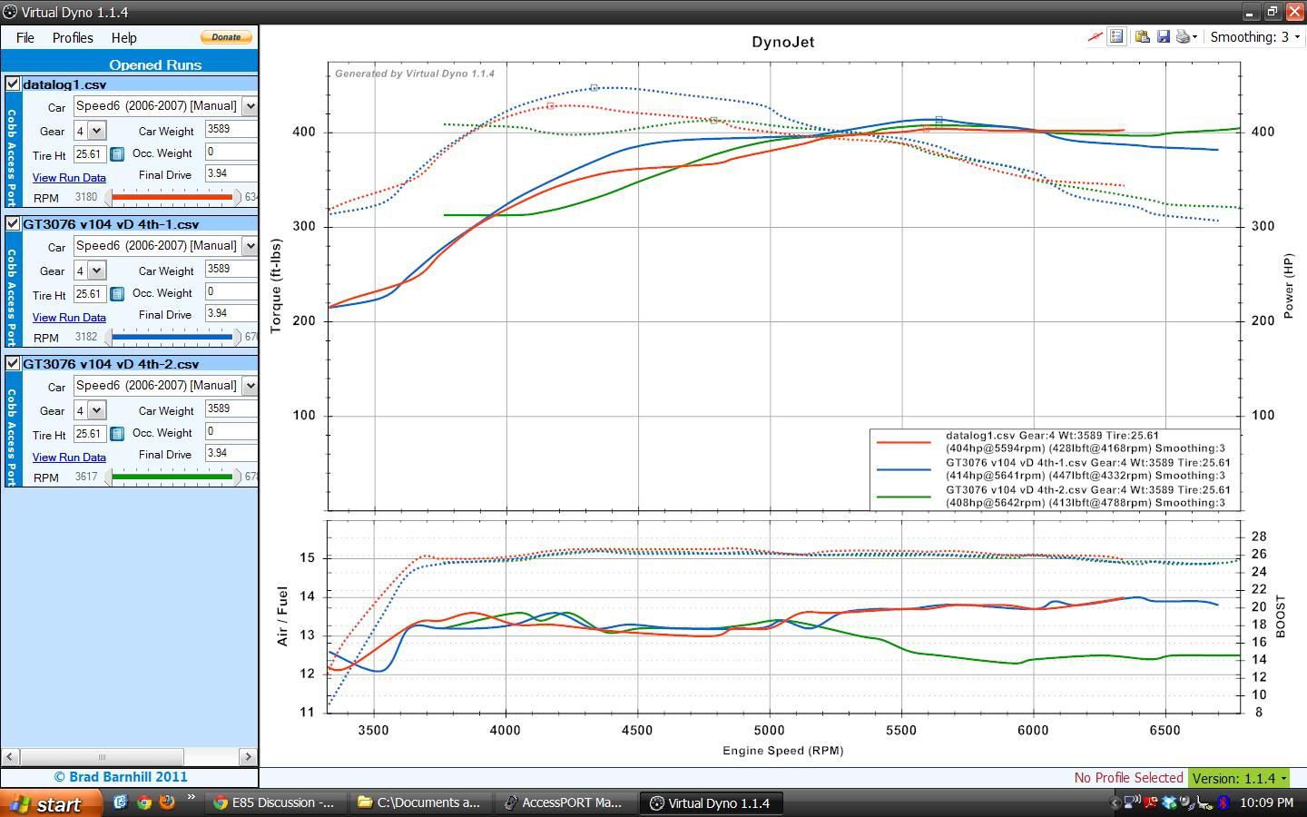

so this is my new tank of E30. i put about 20 miles on it before i started logging. Datalog1 was done at about 6pm and the other 2 were back to back around 930pm. my WOT AFR targets are 12.2. WTF!!!!!!!!!
EDIT: ok on the green log i layed into the throttle instead of just mashing it and i guess thats why VD cut it off even though i have auto trim TPS turned off. i also havent adjusted WOT AFR's since i started with E85 tuning. they were dead on @12.2 on pump before hand. logs attached

WTF your AFR is logging crazy lean. I guess i'm posting the obvious but do you have any idea why its happening? I logged my car on 3 gallons E85 to a full tank yesterday and had some LTFTs that needed adjusting, but AFR was fine. Could it be the inconsistency of the pump E85?

TEAM LBN BEERS -- FYCN

If you're at 100% IDC, isn't it possible that 13-14:1 AFR is all that the fuel system can muster? With bigger injectors pumping more fuel, that would fatten up the mixture more and get you back down to your targets. Yes? No?

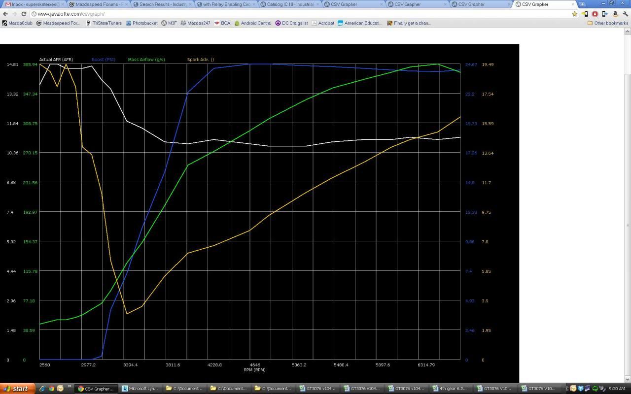

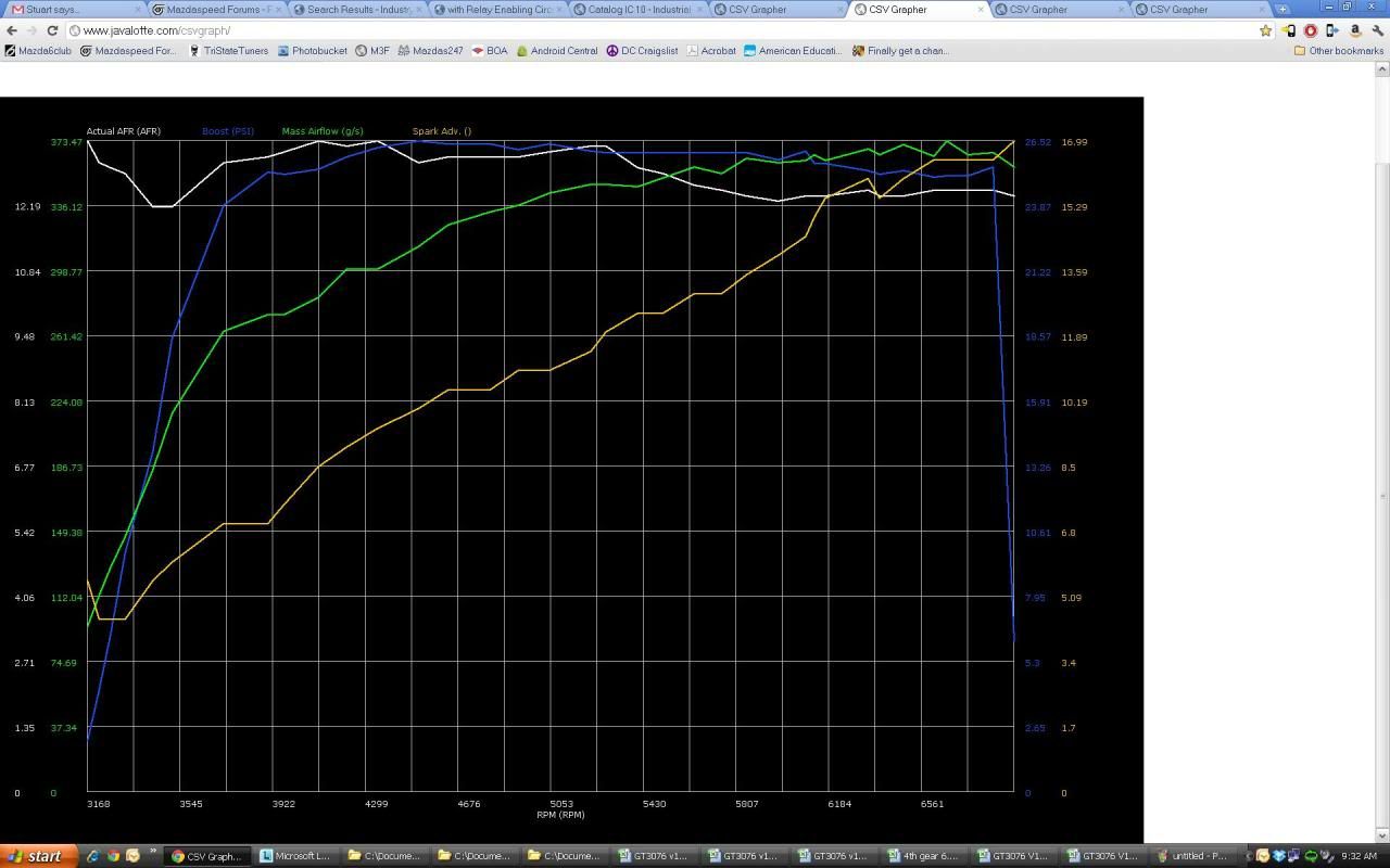

heres a log from aug sometime (pump gas):
and here is this most recent one Posted on VD above:
i have another maf at home im going to try but i seem to have this same problem above on and off so i will look into it more before i continue tuning.

I FIGURED IT OUT!!!!!!!
so this morning dustin tells me to check to see if my BOV was leaking. now obviously this wont show up in a boost leak test so i went to HD to buy 4 washers to shim my BOV.
here were this mornings results......
and after the shimming.......
i gained 35 g/s with no other changes but the shims lol needless to say ill be redoing that 40-110 video i posted from this morning. my AFR's are also back in check, still about 1/2 a point lean but better then 1.5 pts from this morning haha
