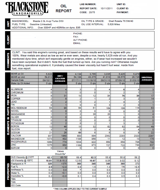

Another EXCELLENT oil report while running E85:
I'm guessing the fuel content is from running 93 while I went to the dragon. It was running rich as hell while I was down there, so I'm not surprised to see it. I changed the oil shortly after I got back (I may not even have switched back to E85 at that point, actually). So, 3500-4000 miles on E85 and 1500-2000 miles on 93 in this report.
Apparently, massive torque on the low end doesn't hurt a thing
File Type: png Blackstone_Report_phate_20111011_MS3Engine.png (87.4 KB, 14 views)
