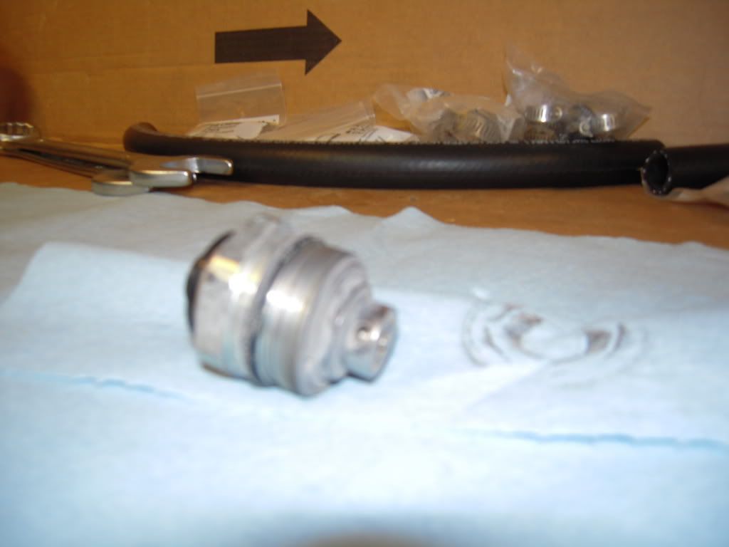

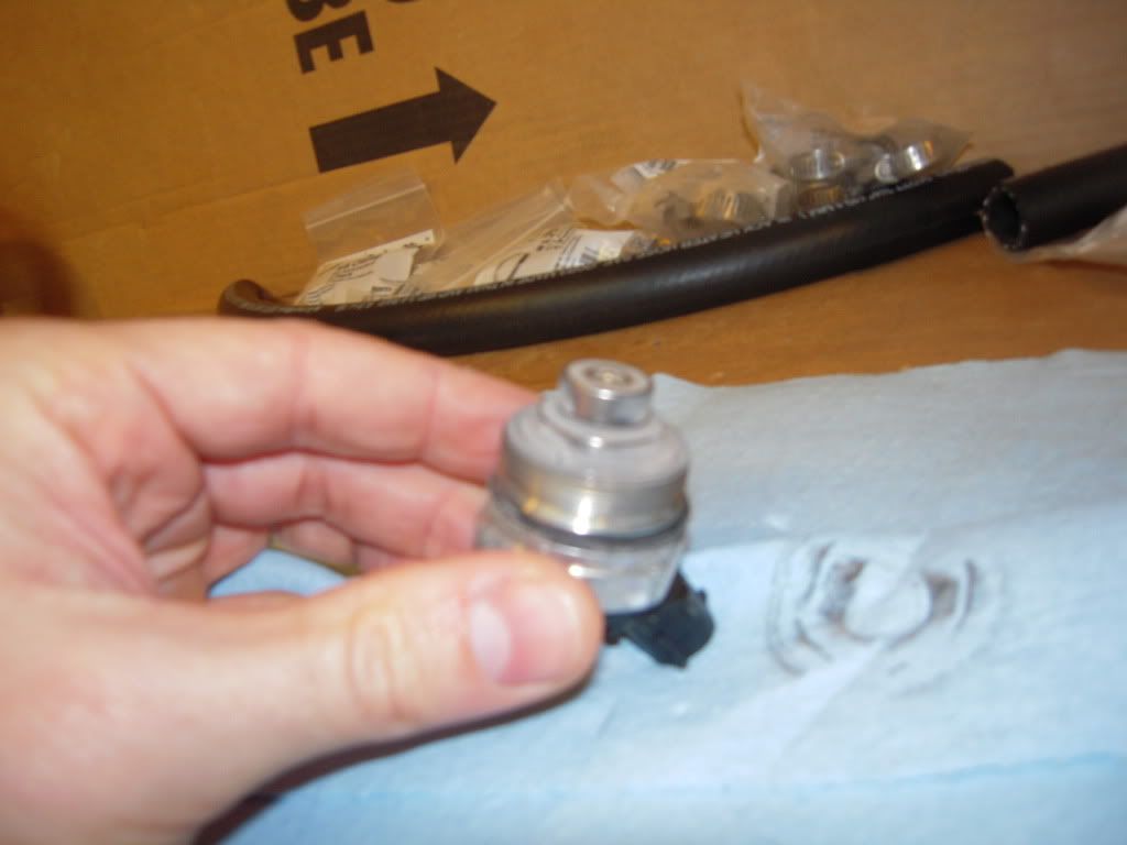

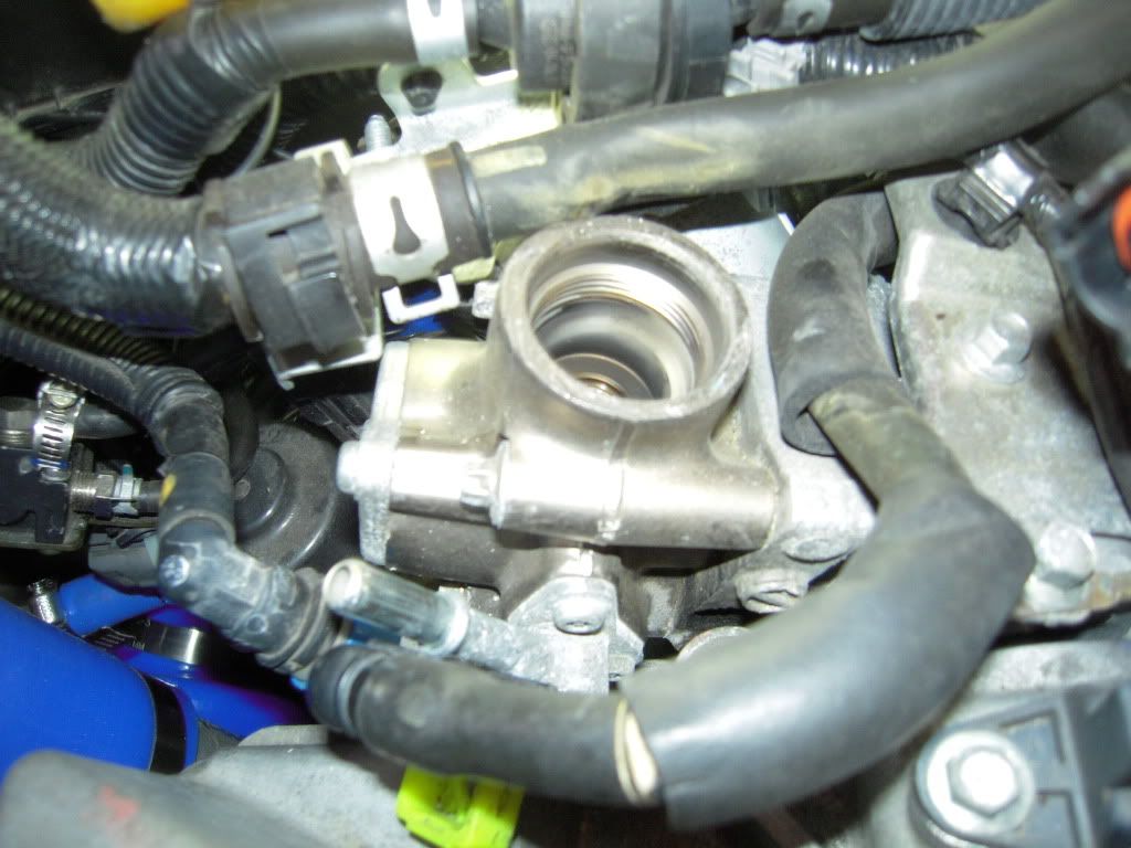

It looks like my second tank of 7.5 gallons E to 5 gallons of 93 has resulted in my spill valve sticking. I was getting ~60 PSI at idle intermittently. This is of course after almost a year at various lower E concentrations.
About 30 miles ago I filled up with 5 gallons E to 7.5 gallons 93 and it seems to be much better so far (dissolving some of the gunk off is my current conjecture); however, I am likely going to disassemble to clean/inspect.
The shop manual doesn't go into any details about disassembling of the pump or spill valve (page 985-987).
Do you have any general recommendations on the spill valve removal/disassemble/reassemble? I reread the first 2 pages of this thread were you show the pics but you did not detail any tips/tricks.

Yeah:
1) Unplug the spill valve solenoid from the harness,
2) Unscrew spill valve with 32mm box wrench or adjustable wrench and pull out (pull out, lol)
3) DO NOT DROP SOLENOID
4) Using a cloth covered flat screwdriver, pry around the bottom edge of the collar to work it loose. It doesn't matter if you scratch that edge, but DO NOT scratch the top of the collar where it mates to the spill valve button thing.
5) Clean with brake parts cleaner and a soft rag (I use microfiber but it doesn't really matter).
6) put back together, press collar into solenoid until it sticks, then screw it back in using the tighten-loosen-tighten method until it's tight and the connector points in the same direction as before (assuming you didn't spin it within the nut, cause it will).
Is it required to pull the pump or can I just put the solenoid with the pump still in the car?

Eff pulling the pump. Just pull the solenoid, it's way easier!
Also, once the solenoid is removed, pull the button thingy out and you can see the internals piston through the hole. You'll be able to tell pretty quickly if things are dirty

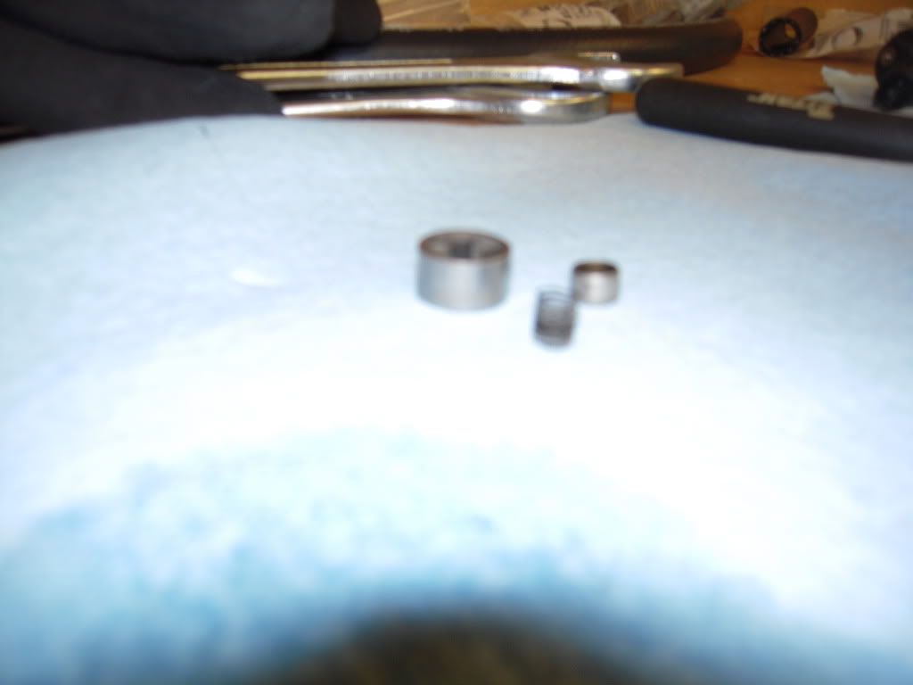

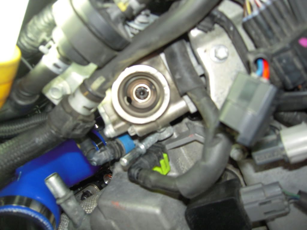

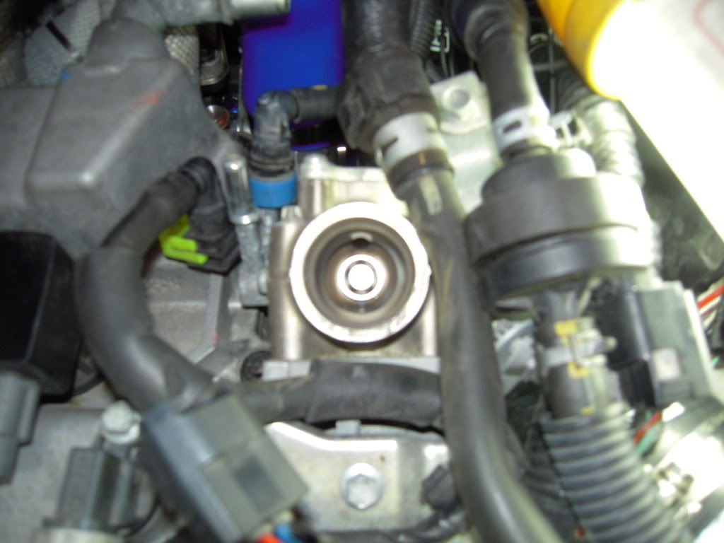

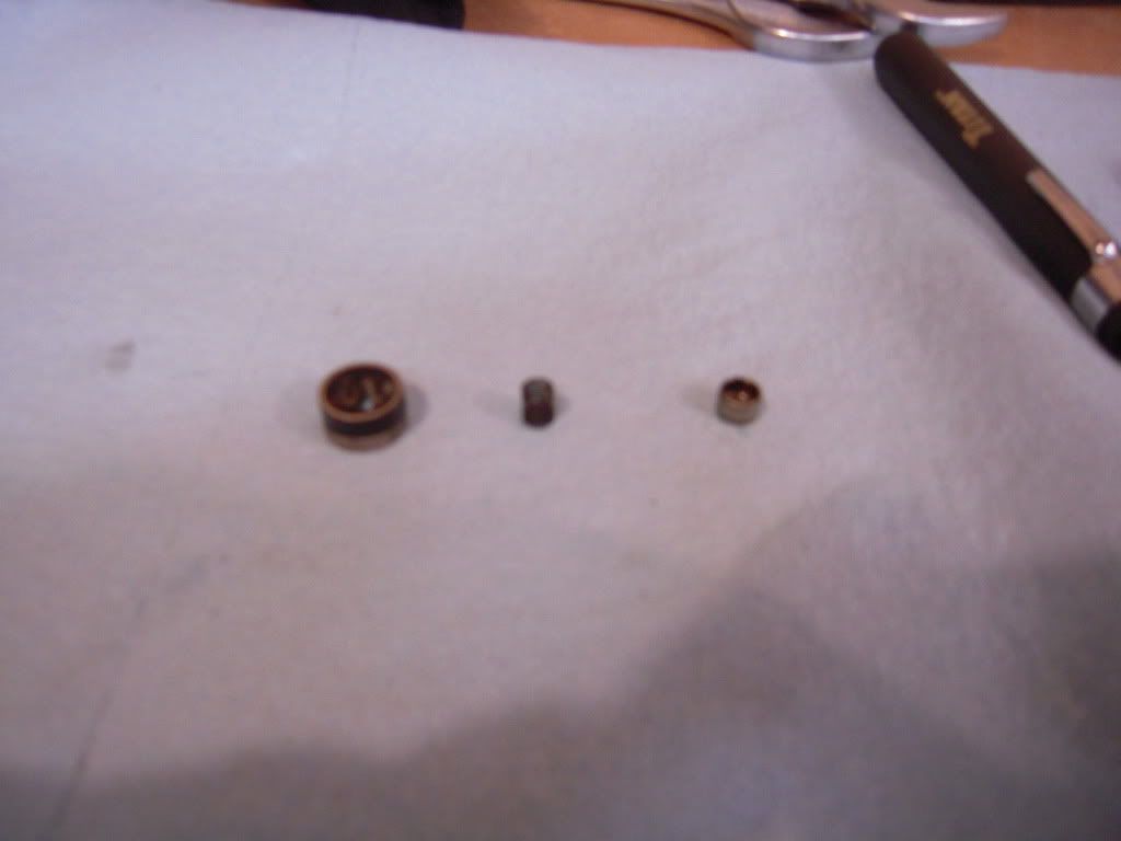

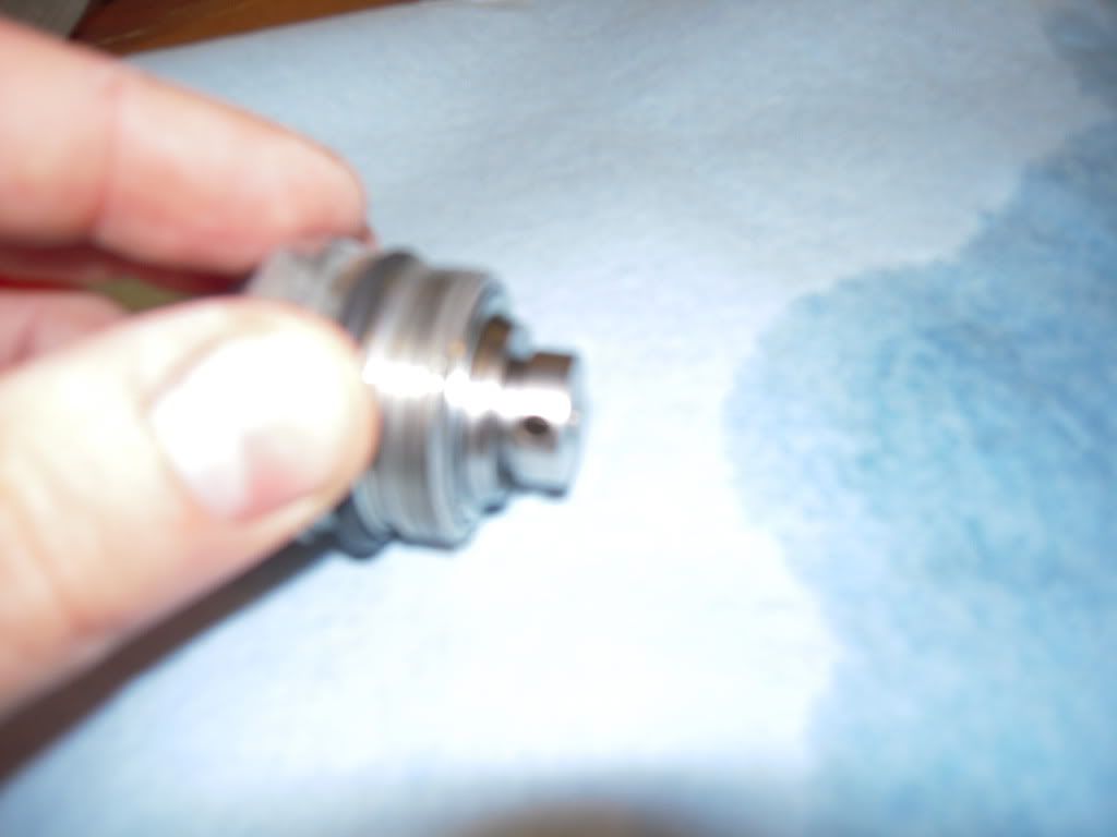

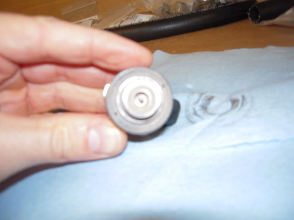

So here is what I found when I pulled the spill valve:
Lots of gray residue that wiped off easily with a shop towel.
This part was a little dirty as well:
Had a similar tint on the housing:
Cleaned up:
I couldn't figure out how to get the spill valve apart, so I just cleaned it up as best as I could with the shop towels and carb cleaner. I fiddled with trying to prior up/apart the 2 retainer pieces, but was afraid of breaking something when they didn't cooperate with moderate force.
No issues so far.
This residue seems to be pretty standard. Mine was like this, after drying it turned a brownish color.
