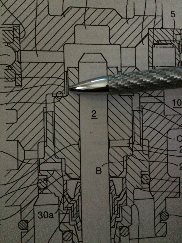

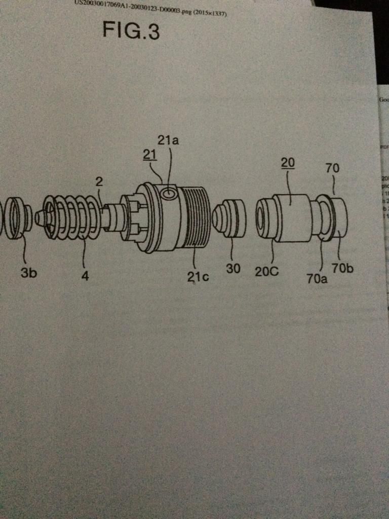

Ok so I read through the patent for our fuel pump, found here: Patent US20030017069 - High pressure fuel pump for internal combustion engine - Google Patents
And I've come up with the following for solutions (or at least help) with high Ethanol concentrations:
1. Coat the retaining nut and spill valve threading in a resin coating which would insulate the parts and keep heat from spreading.
2. Replacing seals with O, X, or K rings of superior sealing ability, or possibly adding additional seals.
3. Increasing the seal between the cylinder and the pump body. This could be done in couple of ways.
.......A. Increase the torque on the retaining nut to press the cylinder harder against the pump body.
.......B. Surface harden the cylinder so it can press into pump body to seal better. Possibly in combination with A.
.......C. Put some sort of deformable material such as part 70 between the cylinder and pump body to create a seal. Possibly in combination with A and ...........B.
4. Improving part 30, the seal between the cylinder and retaining nut could be improved.
Not all of these may work but that's what I came up with after going over the patent. If our pump isn't that different from the LNF pump then I think it's very possible to run full E85. The patent goes over the seals pretty extensively so I would definitely recommend taking a read of it.
Here is a picture to get a good idea of what I mean by sealing the cylinder to the pump body.
http://i1301.photobucket.com/albums/...ps84dca8c6.jpg
As well as a picture of seal 30 and 70.
http://i1301.photobucket.com/albums/...ps89196520.jpg
Enki 10-29-2014 05:27 PM
Counter arguments for each; not trying to shit on your rainbow but I've thought about the pump design at great length as well.
The internals themselves have direct contact with super hot engine oil as well as a set of lobes on the camshaft; heat conduction will happen regardless.
Our pumps actually have *two* seals/oil control surfaces already. One is an X shaped buna ruing on the narrow end of the retaining nut, and the other is a little plastic scraper backed by a regular shaped o-ring on the fat end. I had my gunsmith drill this part out and plug it with a piece of PTFE that was also center drilled, but the tolerances are so fucking tight that when tightening the last couple of threads on the nut, the drilled hole in the PTFE was off just enough to seize the internals and prevent actuation, so that idea was scrapped. Yes, he used a drill press and lined it all up while installed in the retaining nut.
If you're going to increase the seal anywhere, it should be on the narrow end of the retaining nut. Closing off the internals from allowing fuel to flow around/through them will result in metal on metal contact and a hardware failure; I'm pretty (~99%) sure that the cause of the issue is oil entering the pump.
See 3.
Our best bet right now (both cost and effort wise) is oil + additive, which so far has been promising to a remarkable degree.
