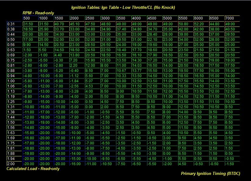

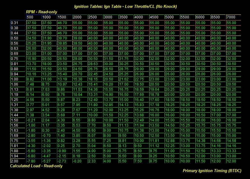

Upped the load values I target 1.07 lambda and lowered Max timing. I'm holding between 20-40 degrees of advance cruising around town now at 1.07 lambda. The car definitely feels less responsive; I may bump advance up a bit to see the affects.
silvapain 11-15-2011 09:45 PM
I've decided that I am trying to test two things at once, which never works.
I put my old timing tables back in, and I'm just going to run the higher cruise lambda values for now. The car is back to feeling more responsive with the old timing values back. It's obvious I also was too drastic with my timing changes.
My timing values before (what I've gone back to now):
http://i158.photobucket.com/albums/t...d3/E85V207.jpg
What I tried that felt sluggish:
http://i158.photobucket.com/albums/t...d3/E85V208.jpg

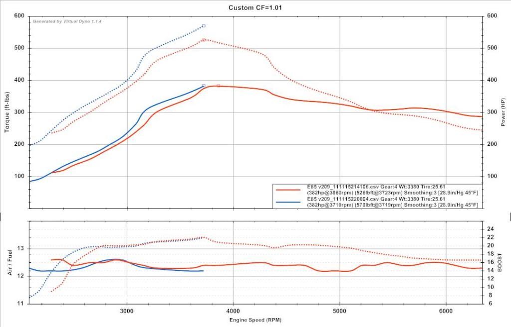

I had to increase my WOT lambda from .81 to .84 to give me some injector headroom. I was hitting 103% IDC above 5500 RPM. Now at .84 lambda I'm at 96% IDC max.
I'm still running pretty conservative timing at 18.5 degrees advance at RL.
silvapain 11-17-2011 10:17 AM
Think my clutch and/or tires are slipping? Number seem VERY high, but consistent...
http://i158.photobucket.com/albums/t...11-15-2011.jpg
