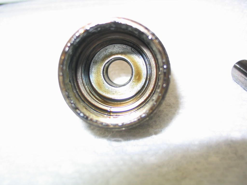

-Corn fed 07 MS3 - Sold
 Old 11-10-2011, 09:01 AM   #46
Man this process sounds familiar
I'm sure. At least it's easy to pull and clean.
I'm wondering if it might be binding issues. The E85 isn't lubricating the plunger as well as pump gas was or something. I say this because I literally could not find a single speck of debris or buildup on the spill valve internals when I pulled it apart last time.

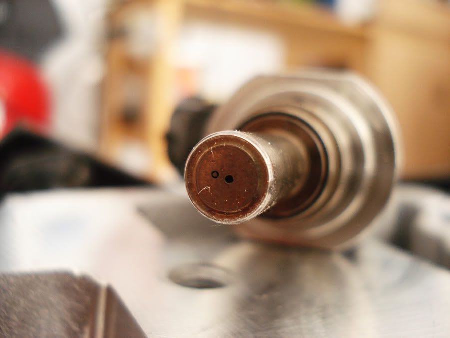

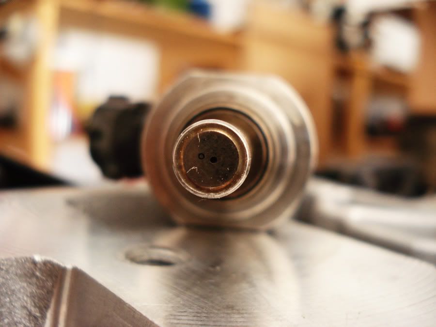

Groans: 189
You have been attacked by the goo. Make sure the inside of the pump isn't sticky.
 Old 11-10-2011, 10:06 AM   #48
Pump should be clean. I just pulled it two days ago and it was nearly spotless.
 Old 11-10-2011, 10:15 AM   #49

holy fuck that is horrible....ok so is it just me or is anyone else worried about an injector getting stuck open?
I'm a bit worried to be honest. The only consolation I have is that the injectors should be more resistant than normal port injection injectors to sticking, due to the high pressures involved. The gunk was very soft, and could be easily wiped up with a finger.
seems someone on here has already hydrolocked a motor due to a stuck injector...can't remember where I saw it.
anyway....perhaps a good cleaning method could be to periodically fill up with 93 since it dissolves the gunk in the pump.
so when you pull the Spillvalve for inspection and see gunk, run a tank of 93 through and then go back to E.
seems like simple insurance.
I don't think anyone running a mix should have any trouble however I'll pull my valve after a few more tanks full to see if anything is going on.
back when I replaced my CPE pump with about 5K miles of E-mix there was absolutely no residue on the valve.

Are there any differences between MS6, GenJuan MS3, and GenPu MS3 injectors? I'm going to look into getting a second set of injectors and swap them with my original injectors, then send off my injectors to have them cleaned and checked.
Yes. There are some differences...
username speed6 killah showed me 2 injectors @ one time, and I believe the gen2 has 2 holes in the inector vs. one (in the gen one).
I believe there is a pic on here somewhere and will post it when I find it.
Interesting... @SPEED6 KILLAH, are the resistances the same? If so, going to GenPu injectors might be a minor upgrade for a better spray pattern.
There's no difference in injectors.
I pulled my injectors off a 2007 ms6 (which is pretty much as old as they get), and snapped a pic to show they were the same:
It has that same dimple as the newer ones.
Hmm.
I distinctly remember the one injector having only one hole.
Lemme dig up the pic.
@djuosnteisn
Here is the post I was referring to.
http://www.mazdaspeedforums.org/foru...tml#post909876
I see you posted that pic in the other thread also.
I was going from memory, and that the part #'s were different between model years.
My apologies for any confusion.

Hmm.
There's 2 holes in that pic, look closely:
The dimple is on the right of the normal hole, at 3 o'clock.
Ok Dustin...
I apologize for the confusion.
Please see my post above.

The injector in that thread still has two ports.
EDIT: slow typing on my iPhone owns me. See you guys already figured it out.
