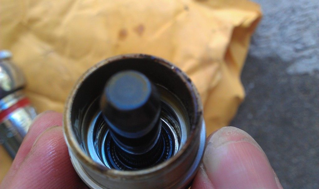

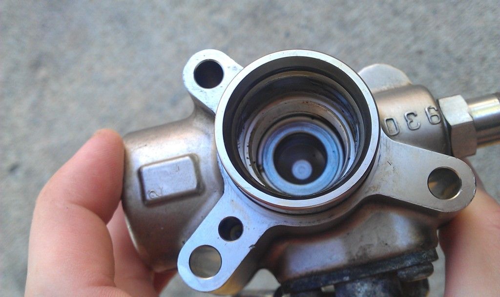

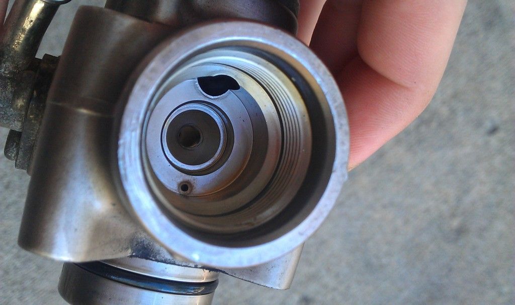

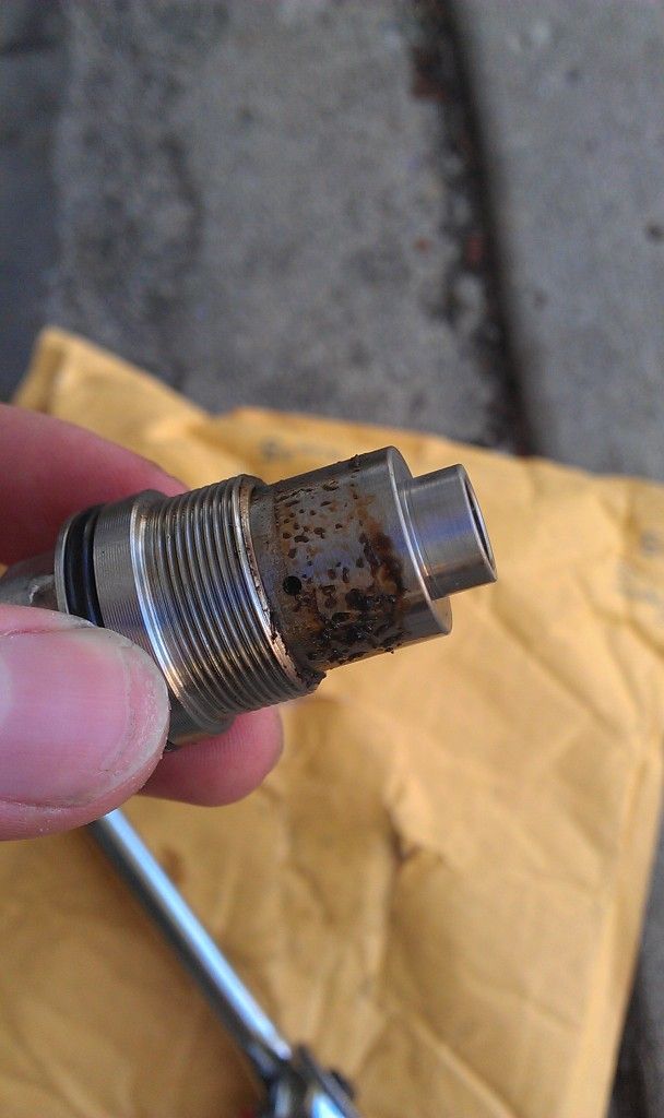

I run the vr1 racing oil....I clean my spill valve about every week just so fp doesn't drop when I'm cruising somewhere, just to be on safe side and I have pulled my pump, and it has been spotless clean....both the spill valve and hpfp are spotless after pulling pump....I have had no problem at all on the vr1 oil!
I uploaded pics of me finally pulling the pump after 1500+ on the other thread and it was spotless, barely any spec of black, that was just between the treads tho.

It takes me 5 mins to clean my spill valve, and I do it just cause I don't want my fp to drop like over the weekend cruising around etc.....it doesn't bother me at all...and I have not seen one problem running 50/50... Spill valve only takes a shit on 100% from what I have seen/read.
Just so you guys know, this thread is about people running extremely high (>50%) to full on e85; not cut with gas.
@silvapain: Is your post in reference to running pure e85?
@mazdafreak: Do you have any buildup of sticky residue? What ratio of city to highway driving do you do? Also, even if your pressure does drop out, you won't hurt the motor; if you could run it twice as long before next cleaning and report the results, I'd (and the community) would appreciate it greatly. As for losing pressure: trust me; both Phate and myself have had it happen at WOT. On a secondary side note, it is possible to hit freeway speeds with only ITFP pressure; you just accelerate slow as balls.
Yes, I run 100% e85! I am about to attach pics of what my pump looked like after 1500+ miles without a cleaning, i just cleaned the spill valve every other week just cause I didn't want pressure to drop....and I have had my pressure drop a lot when I was running t6, had to clean every week since fp would drop to 50 psi just cruising and at WOT, not fun when it happens lol......I switched to vr1 oil and no problems yet.
