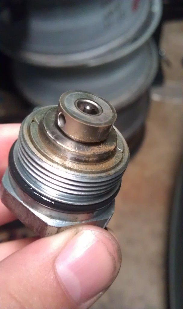

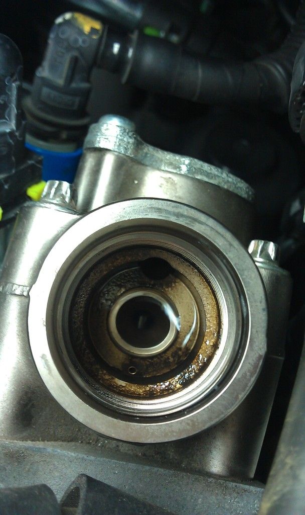

Okay, this is weird.....So my fuel pressure dropped going to work on the highway, and got fuel pressure back after I got off the highway......I parked the car, since I had to work.....I went home, and my fuel pressure has not dropped for at least 30 miles so far.
So wtf happened?? I haven't had a chance to pull the spill valve yet....But I'm holding pressure.
Sounds like what I've experienced. Pressure would come and go, but it will eventually gum up enough that it renders the spill valve inoperable.

^^Ahh makes sense.....I guess the vr1 oil works good.....When I ran t6, fp would drop right away and be gunked up.
This is the pic of the spill valve.....It wasnt super sticky, just a tad bit, it looked/felt like that gummy/sticky shit from a sticker.

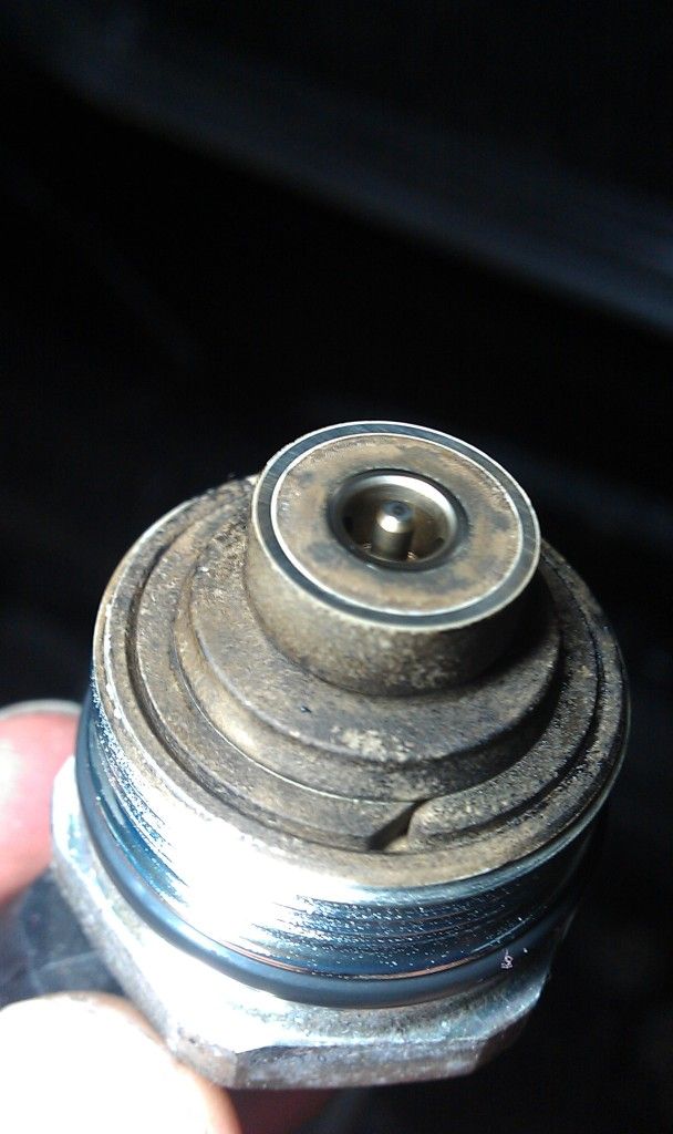

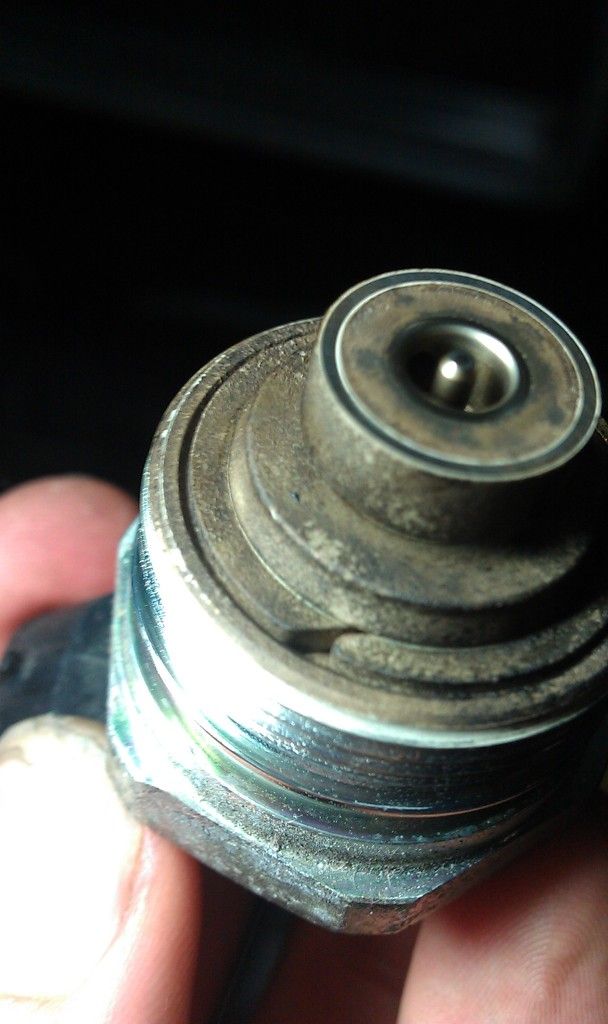

phate Enki this is my buddies justinspeed3 spill valve on 50/50 on t6 for maybe half the summer till now. He was having problems with afr going crazy and would randomly full cut, ap clint said to check spill valve, and well, u can see the results. I'm on 100% and my spill valve never looked this bad lol.

Fuck man MINE never looked that bad. Most of that is either from before adding corn (not cleaned prior to going mid-mix; probably should be a requirement, really) or hes right on the edge of ratio that causes issues.
How is he calculating his mix? Is he putting in the same amount of e85 to 91 per tank or just the same amount of corn each tank and topping off?
Yeah same here, mine has NEVER looked that bad, and I'm on 100% E lol.....I don't kno the exact details, but I kno he fills up at every half a tank and puts ~6/6 gallons of 85/93. Idk if he adds a lil more 85 or not....Maybe justinspeed3 can help answer??
So I think 50/50 down the road actually gunks up, or its the t6 oil.... I see nothing but problems with ppl running E and t6.
Could be the gas. I use 91.
Ultimately, he should make a thread on it.
I think I can give some background on this car:
Tuned on 5050 MONTHS ago by yours truly. So I talked to him about this today and got some info, which is why the spill valve was pulled
He hasn't switched back to 93 since the 5050 tune, which is a ton of miles for him - I would guess 7-10k miles. Way back when we did the tune, he wanted to always top off the car because he drives it so much. I told him to always err on the high side with E85, which is exactly what he was doing. Over time, this has led to a higher than intended concentration.
He is approaching 13:1 AFR's on his current tank, due to too much ethanol. In terms of AFR's, it's fine, that's why we tune them conservatively (target 11.48). BUT, I think this extra ethanol put him in the 'danger zone' for black death build up. Couple that with lots of miles, and bam, you have buildup and the E85 woes we've come to know and love.

Back to the original topic...
I would gum up my spill valve in ~50 miles when trying to run 7.5-8 gal/tank E85 (~E50) when using Walmart SuperTech 5w-30 synthetic. I could reduce the E85 concentration to 6-7 gal/tank and clean the spill valve in place enough to control again.
This was repeatable as it checked it 2-3 times.
I have never had any issues with this oil at E20-E40 during the past 1.5 years.

u didnt have to clean spill valve either between E20-E40 either? for u atlease
Correct, zero issues below E50.
