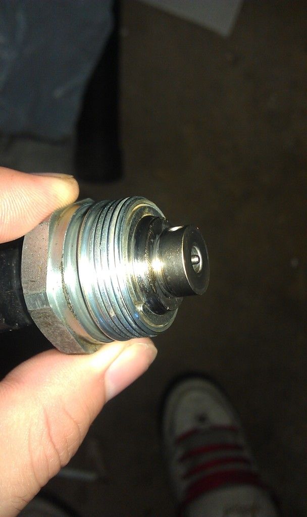

It's about time for an update.
I've had the JBR cut PTFE scrapers for some time now (they are pretty much perfect; thanks @jbarone), but have had issues with my testing.
With the new set of o-rings I've bought, I couldn't convince the scraper to seat in the stock location. Rather than risk fucking up trimming the o-ring, I put the totally stock retaining nut back in and placed one scraper between the retaining nut and the internals collar, and lightly tightened the assembly.
That is when I started having fuel issues.
My idle psi is set to 750; I was only getting 400-450, and wouldn't make over 800 at higher rpms. Okay, too much drag I thought. I haven't been able to pull the pump until today to remove it due to a foot injury, but now that I have, I'm pretty pissed.
You see, back on the stock retaining nut with no scraper, my pressure started out slightly above commanded (which is fine and normal). As it sits in the driveway, it only makes 200 ish PSI (again, 750 commanded). As the engine warmed up, the max pressure went down.
If any of you have followed my e85 thread, this will sound familiar; it's the same exact symptoms I had when my stock PRV shit the bed. Only difference now is that I'm running the PTP 2150 valve.
As far as the pump goes, when I disassembled it just a few minutes ago, the whole assembly seemed to move just fine; the scraper actually expanded outwards more than it did inwards, so was basically doing nothing but preventing the retaining nut from seating all the way. With the car running, I can feel the internals clicking along happily inside the pump like normal; manually actuating them without the spring showed very little resistance aside from the initial o-ring rollover in the nut.
So basically, I'm fucked until I can get another PRV (preferably stock, as it's more likely to last a year's worth of driving rather than two weeks).
Because it will be a while until I can get this fixed, is there anyone that is willing to take over the scraper research? I will mail the couple dozen scrapers that are left at my cost to someone that will keep on top of this in my place.

Just talked to John; he's gonna warranty my valve if it's bad. Only thing is I have to send my current one in, and since my stock one has been in my glove box for a month, no bueno.

Well i have finally pulled my pump after who knows how long, and idk if im just lucky, but this vr1 oil i think is working very well so far!! I clean my spill valve every week just so its a piece of mind that i wont lose fuel pressure while driving anywhere...But everytime i have removed the spill valve, it was completely spotless and clean.....Lmk what u all think.

looks good!

Yup!! All looks very good since the oil switch! I also did recently run a can of seafoam ((On a full tank of 93 tho)).....I do want to drop the itfp and see what the filter looks like, but not ready to tackle that project just yet, since me have to save for a build ;-)
Im back on 93 for the time being, pretty sure my 02 sensor is going bad.....just cruising on highway, my afr dips down to 13.1....I have good vacumm, shouldnt be a leak or anything.
how can you guys say these picts look good? you shouldn't have any of that grimey built up shit on the sleeve or the inside of the piston part. what % e85 are you running?

Good is a relative term in this case lol.

Yeah, it was very good....But I also didnt do an oil change for awhile, so oil was probably breaking down a bit....When oil was new, I had no problems and no build up.
I was running 100% E85
