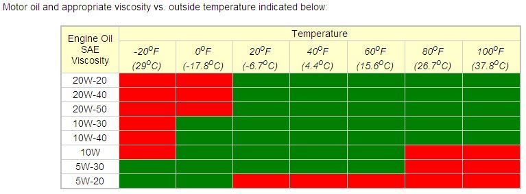

Here is some nice information on determining the proper oil viscosity with respect to ambient temperature:
Engine & Gear Oil - Temperature and Viscosity Limits
Edit: I should add that this table does not take into account engine bearing tolerances. I would run 1 weight lighter than that table for the MS3/6.
The Following 5 Users Say Thank You to silvapain For This Useful Post:
Easter Bunny (04-09-2012), GLORIFIEDBOZO (04-04-2012), mazdafreak (04-04-2012), metalgear386 (09-01-2013), wolly6973 (04-04-2012)

learn something new everyday, thanks for the reference
