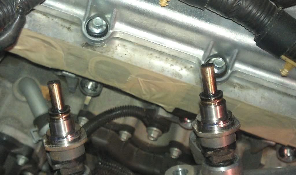

Well i replaced my injector seals last night....got a chance to look at the injectors and shit, and my stock seals were all junked up.....idk if that normal or from running full e85 before for around ~5000 miles.

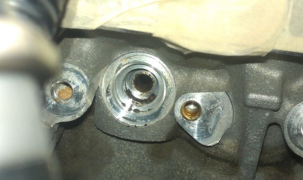

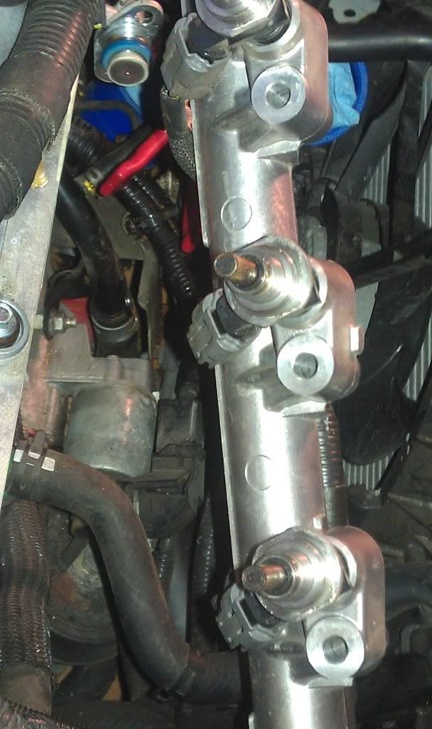

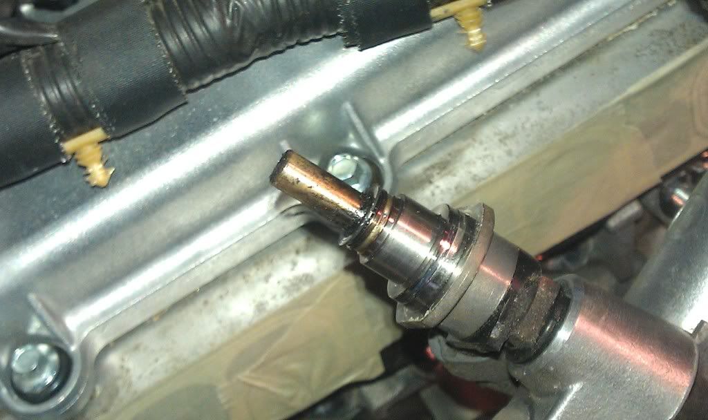

So before you read any further I am not saying this is an end all be all solution to the problem. This is 1 car, 1 pump, 1k-1100 miles. Once more people have tried different oils or the same I am currently running, there are more positive results, and nothing changes for me in the next 10k miles, then I would say oil choice is a must do for positive results. That being said on to the rest....
Pulled the pump today since I finished out the 5th tank since swapping back to 100% E85. I was unbelievably amazed at how good everything looked. Actually I had pump, high pressure line, and HPRV out, and they all looked good. Didn't take pics of anything but the pump though. The only spots with any "black death" were little bit around the shaft collar, and a little on the outside of the piston as you can see in the pics. That was it, the rest didn't even have the brown film I got when I initially swapped to E85. Somehow with the flash from the camera the wear spots look brown, but I couldn't get them to wipe off. And on to the pics....
Edit: Just to clarify, I did not even attempt to clean anything before these pictures. The black gunk seen in the places I mentioned early was sticky and was the normal black death, but you can see just how much of that there was.
