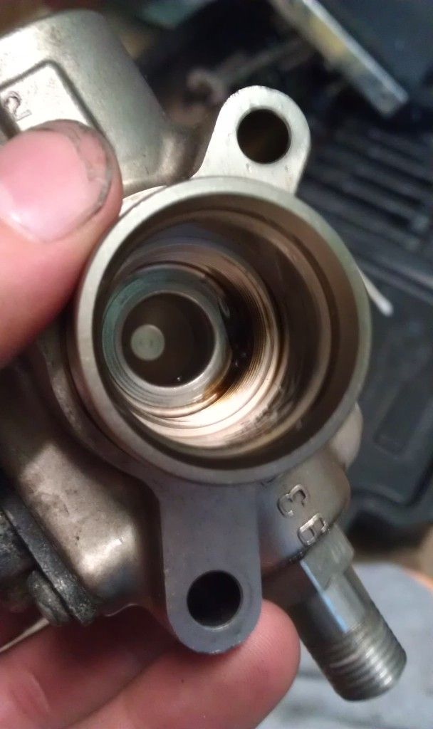

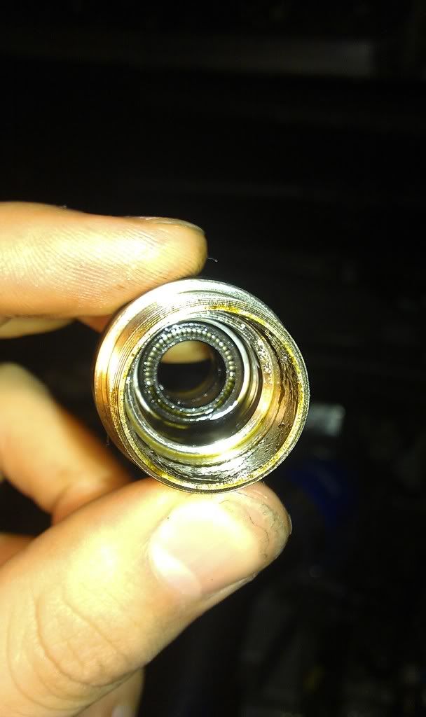

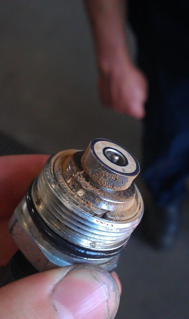

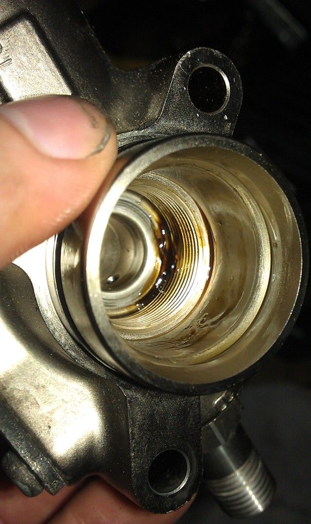

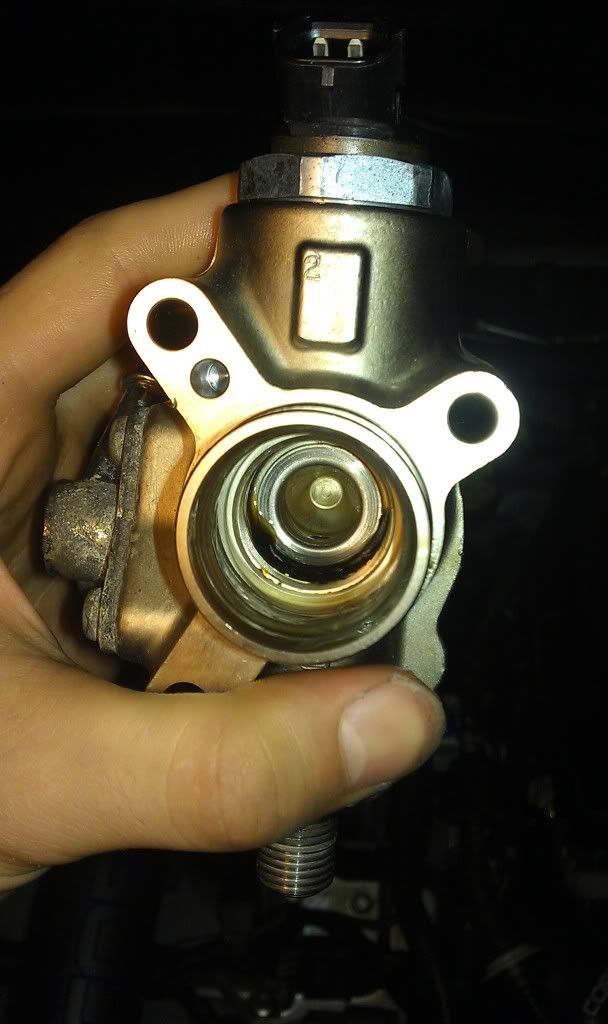

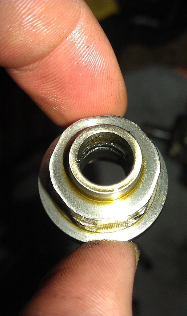

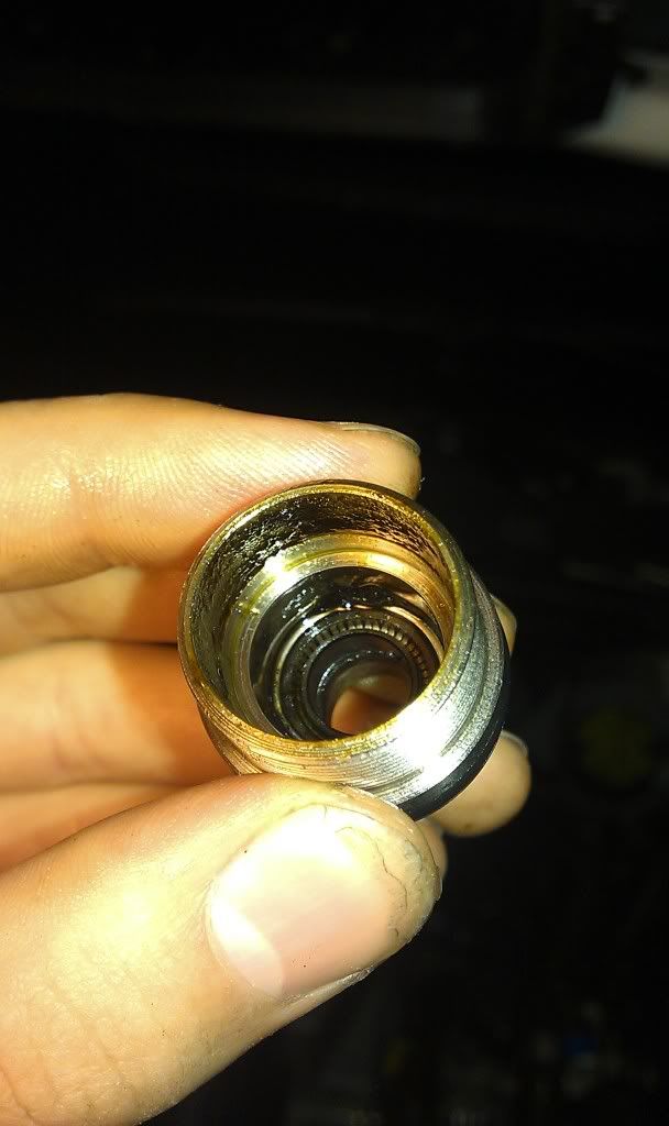

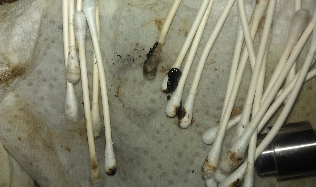

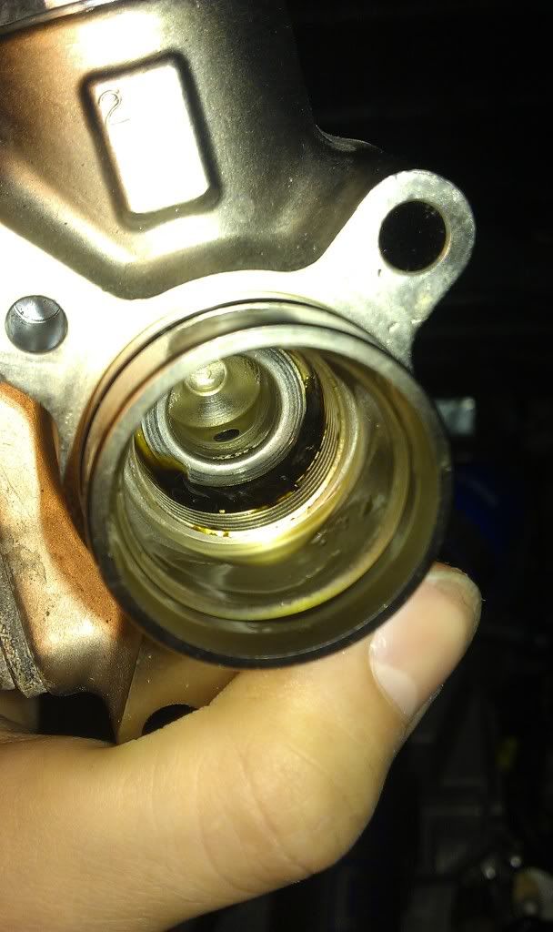

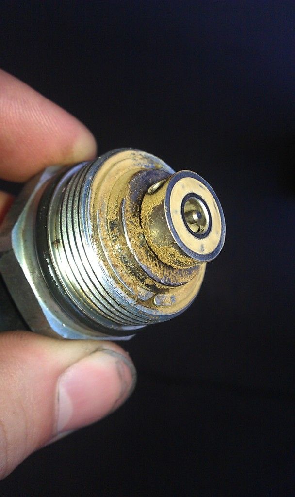

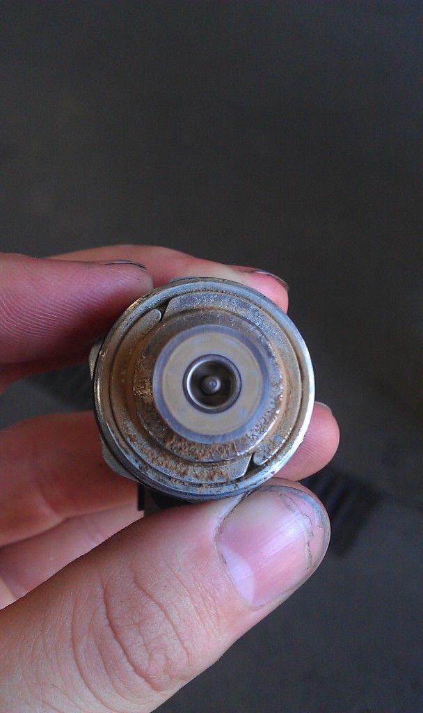

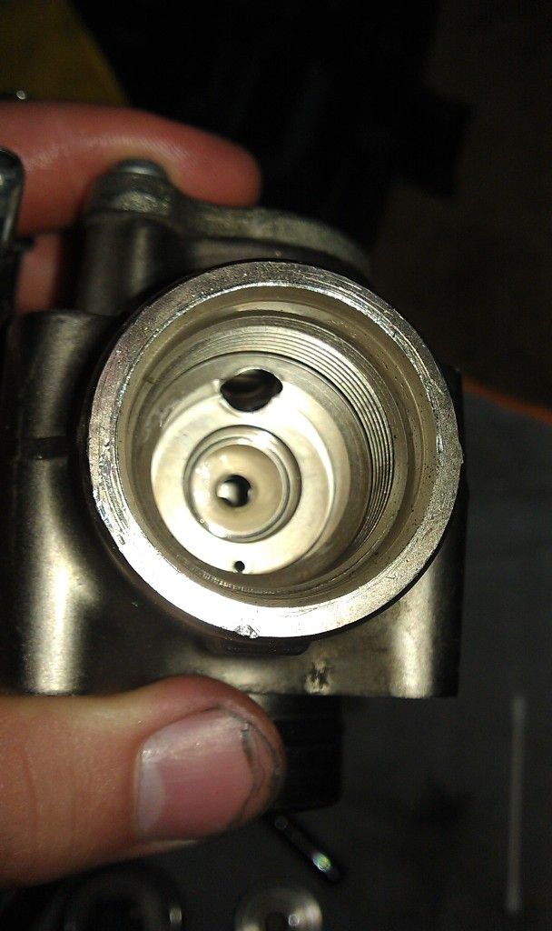

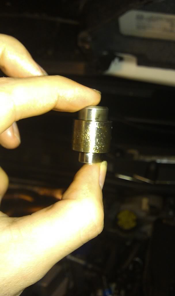

Finally took apart the pump today ((except spill valve since it has been cleaned the other day)).....And got some pics for everyone.......My shit had some nasty slugg oil build up in spots, as you will see in the pics.
This has been about 600 miles on full 85 with vr1 oil ((about 70 miles on t6 before i switched oils))
@Enki @GLORIFIEDBOZO @phate @silvapain
((This part accidently got rolled in some shit on the floor, only oil build up on this))
Q-Tips show was i actually wiped out of the pump.

Damn it! Spill valve took a shit cruising on the highway going to work...cruising at 60psi isn't fun.
Can I test out the new stuff jbr makes for the pump too?

Groans: 124
@Enki @phate @GLORIFIEDBOZO @silvapain
Okay so I pulled the spill valve, and well I def don't like what I see at all!!!
Is my fuel filter clogged up or what??? It's like I have sand in my fuel.

Rep Power: 11232
Thanks: 14,868
Collect a sample!! That's def something new lol.

Is it sticky? How far did you drive with it stuck? Has your intank filter ever been changed? Where did you get your gas?

Groans: 124
I'm at work and cleaned the spill valve....I think there is some shit in the pump still.
Do u use a q-tip for the sample??
I got stuck driving it for like 10 miles if that.....no, my intake pump filter was never changed with 39,xxx miles on the car, and I have no idea how to install it...I was gonna change to the 265 pump.
And I just switched from throntons gas to Mobils 85 gas, this is the second tank.... Could be garbage gas.

Well i pulled the pump after the spill valve took a shit and looked like sand covered my spill valve.
The pump was cleaner than shit!!! WTF was that shit the other day?? I did out 93 back in....might put a lil 85 back in to see if I can get that build up again and send a sample.
SPILL VALVE CLEAN NOW?!?!?
ARE THERE SCAR MARKS ON THIS?? ((WEAR MARKS))
