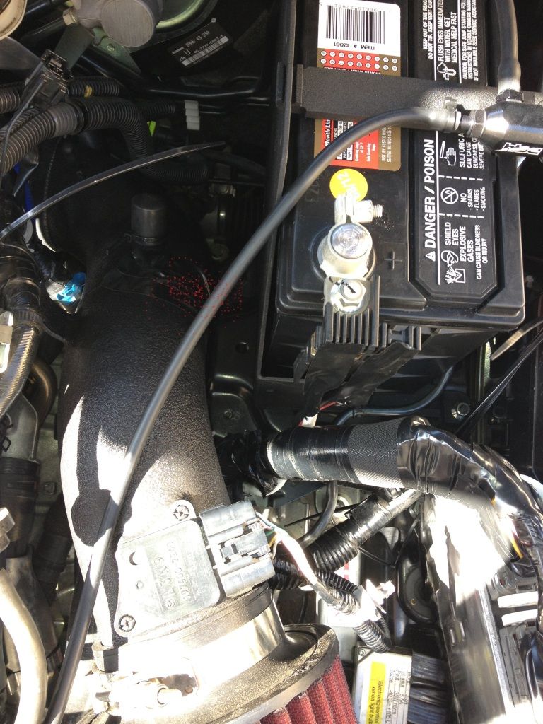

anyone have this with the JBR 3.5" intake? the intake is right up against one of the ecu connectors, afraid I'll have to move the ecu from the side of the batt tray. It looked so good
Hey Philip,
Can you post a couple of pics of the JBR "wide path" intake to show what's hitting? Even at 3.5 inches, there should be no issues with anything rubbing. For intakes that may wandering off the "path" though, I think we've got a simple solution for you which will make relocating the ECU from the battery tray unnecessary. If you could post some pics that would be great. Thanks!

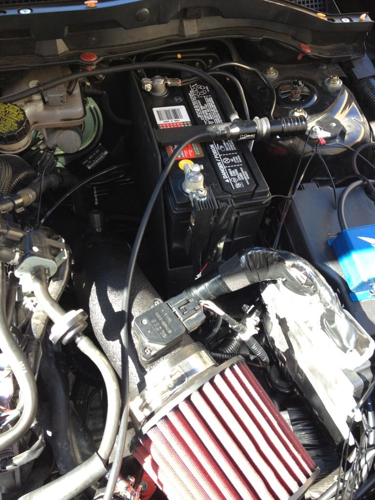

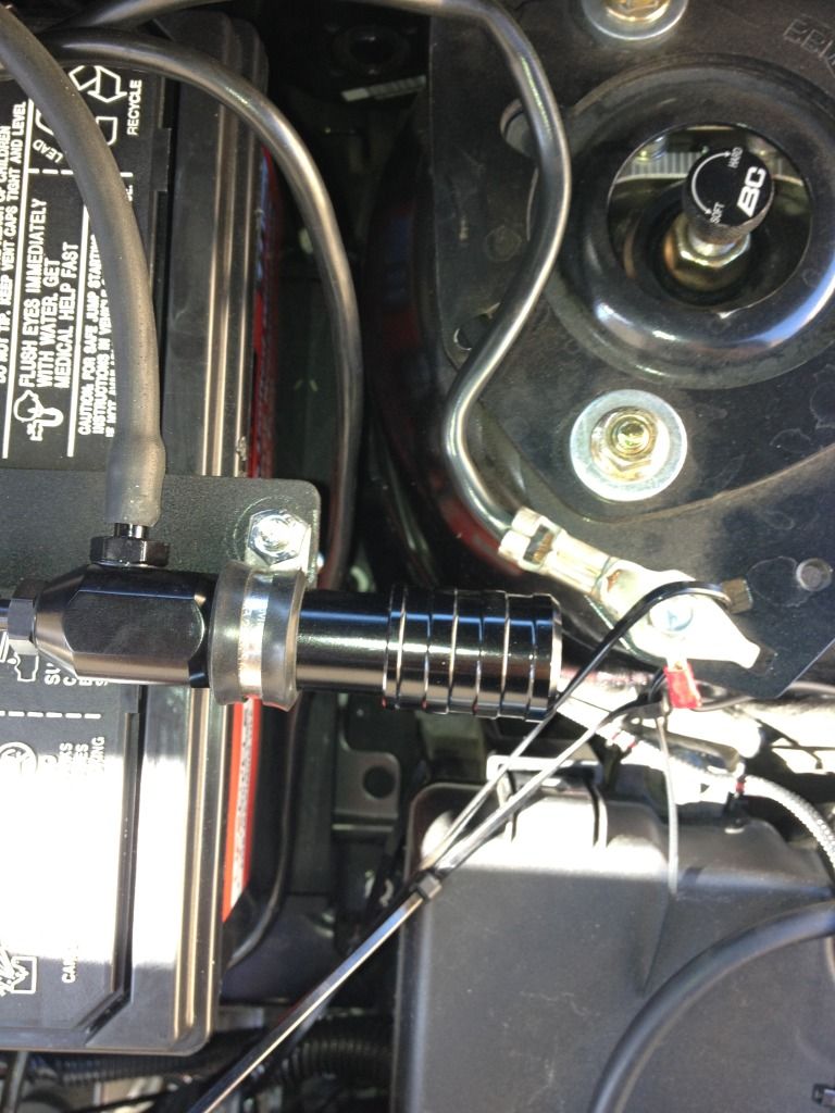

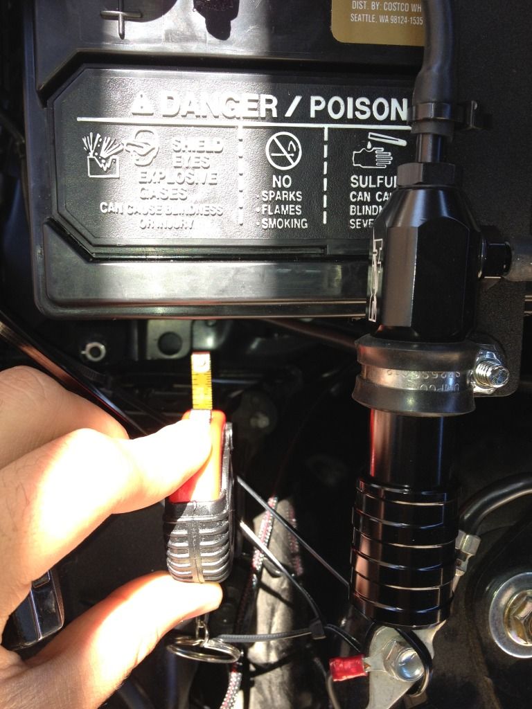

heres some pics gt3071 like @802MS3 but my inlet is the regular 4'' , I have the @jbarone 3.5 intake love it, I have the @HTP tray and love it. Using both in conjunction with one another I had to relocate my ecu since the farthest ecu connector ( the one that would end up on the bottom circled red) would not allow me to connect the harness to the ecu. In another picture circled in red you will notice black electrical tape (on intake). Thats when the ecu was mounted to the tray, it had a tight fit and was compressing both the battery tray and against intake but it was on (ecu wire harness still not on).
A possible fix or revision if htp so chooses to can be seen in this next picture. There is about .75-1 inch of room on the side away from the ecu ( depending on how much you can push the fuse box harness down/ out of the way). Doing this would just mean the bolt holes on the tray would need slight relocation, doesnt look like much else would need changing.

On the Gen 1 there is a wire harness that runs between the strut tower and the battery tray not allowing it to be moved over any further. The Gen 2's don't have that harness there so there is room to move the tray over but we opted for a part that fit both cars.
Can someone see if moving the ecu towards the brake booster to the rear holes on the tray will work? If so then ill start putting two extra holes for those that need to push the ECU back.

from what I remember the ecu wiring harness would not extend but il check after work. I thought about making extra holes ( in a lower triangle fashion) and mounting the ecu diagonally, but got too lazy and went to town with zip ties and rubber grommets!

Figured I would post a pic of my weekend install. HTP tray and ECU relocation.

Just curious, any reason you didn't use the mounting on the battery tray for the ECU?

I would have but I wanted to mount the ECU in front so I could have a large open surface to mount my meth tank. I already have the mount fabbed up to mount to the tank and then it will use your stock holes and hardware to mount it where the ECU should go. If it wasn't for that, it would have been super easy to use your supplied parts and mount location to bolt the ECU to the outside of the box.

Totally understand. Thanks for the quick reply!
