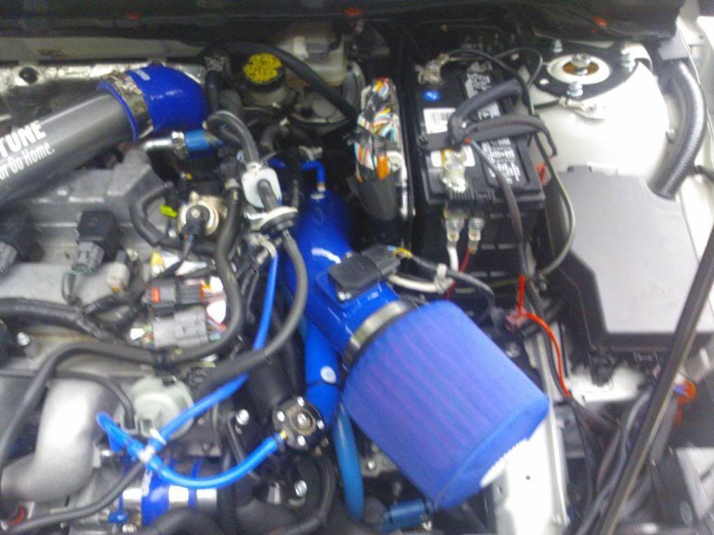

Originally Posted by DamagedGoods (Post 1924118)
Anyone with a Speed 6 have to notch the battery tray to get it to fit? (on a K04)
Mine just didn't want to cooperate without modifying the tray.
http://img.tapatalk.com/d/13/03/02/zabuhyse.jpg
Originally Posted by razorscs (Post 1927957)
I had to with the BNR, no way it was fitting. Easy to do though and turned out fine.

http://tapatalk.imageshack.com/v2/14...d4f51e6154.jpg
In case you guys wondering if HTP 3.5" intake will fit with JBR battery tray, here is the picture of it. It is indeed very tight with the intake rubbing the ECU wiring harness. Tried with all sort of methods (trimming the coupler to turbo so that the intake shift closer to engine) and none of them working well. The MAF is practically touching the harness. End up, we were drilling new holes on JBR tray to mount the ECU closer to firewall.
The intake was fitted to GTX3071R ATP turbo. It pushed the turbo inlet further out compared to OEM K04.
Yatta 10-08-2014 08:33 AM
For a short term fix a piece of coolant hose cut open and wrapped around the harness will prevent damage to the wires (or the powder coat) but moving the ECU back might be best; still hate how most (all?) relocation kits leave the top of the ECU exposed.
SparkySparks 10-14-2014 08:21 AM
I ended up going with the HTP tray because it sits back an inch or two further then the JBR one. Hope you are able to get things adjusted enough and like @Yatta; said, you can use a bit of hose over the wires to provide a buffer.
