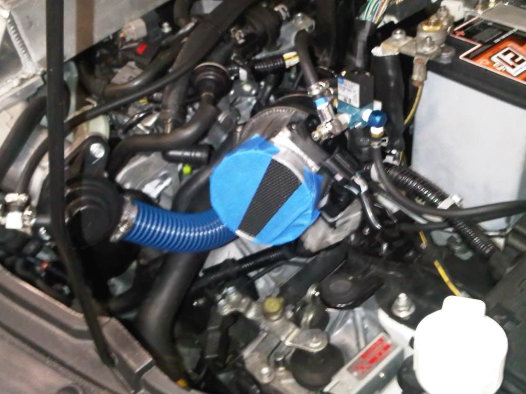

@Tomas; that's not an HTP intake - is that your engine bay?
 Old 03-22-2013, 02:50 PM   #188
Bob Ross Fanclub
Tomas's Avatar
Location: SEFL
Posts: 3,811   (View Stats)
Rep Power: 4333
Thanks: 4,534
Originally Posted by Voltwings View Post
Am i the only 4" with no honey comb?
No. DJ also not haz
Not it's not. It's DIY
And yes it is.
