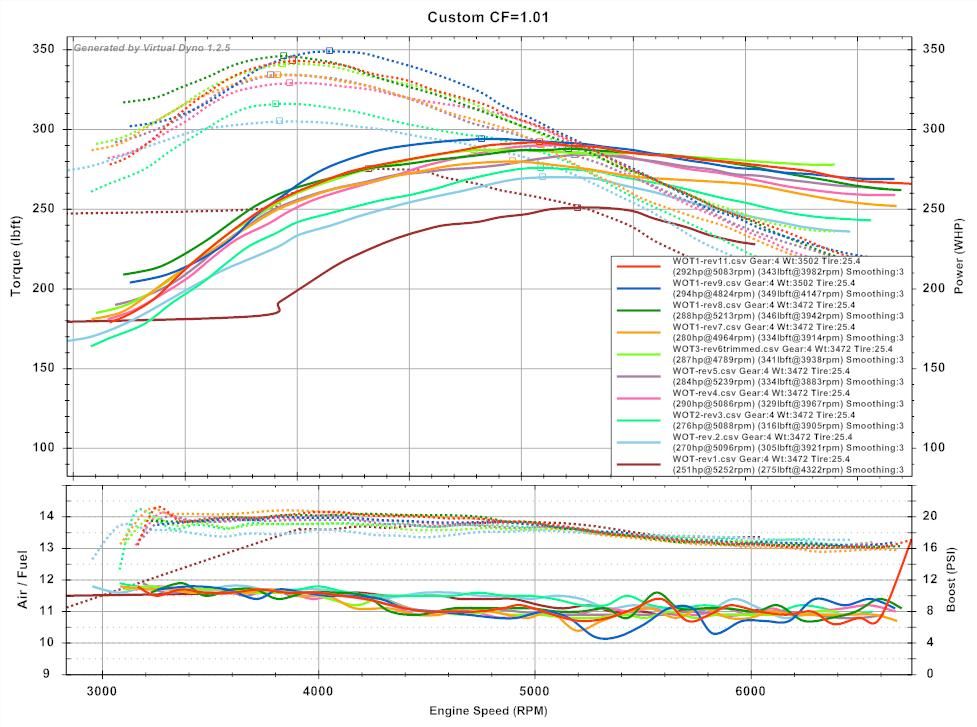

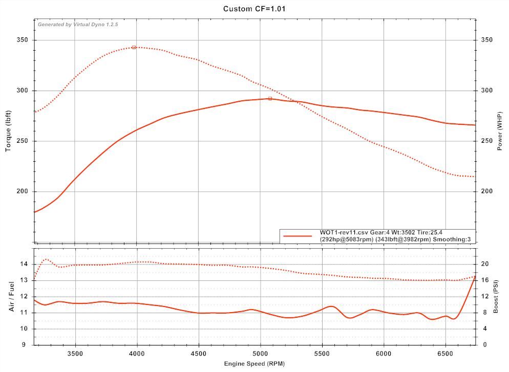

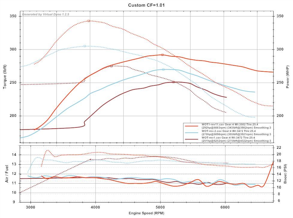

Well I finished up my tune yesterday with the one and only @Lex; and let me say, I am very satisfied. Getting tuned was definitely an adventure and I learned some stuff along the way.
I am completely in love with my car now, and this was definitely the best mod I've done to it. Lex was able to pull 54 extra horsies out of the car. Before the tune, I was barely able to break traction in 1st. Now, I'm breaking traction in 3rd. What was great is that Lex spent some extra time with me to make sure I had a safe tune. I was not expecting that and was very pleased that he did that for me.We started to see some kr near the end and had to dial back a little bit. I was able to get to 294/349 before Lex dialed back timing a little bit in the 5k rpm range to reduce knock. My final revision gave me 292/343, my goal had been 285. I'll get on a dyno either next week or the week after to see what numbers are really being put down.
I'll definitely be coming back to Lex when I'm ready for E85 in the Spring or Summer.
Here's some VD graphs for your viewing pleasure. 1st graph is the last revision. 2nd is the first, second, and last. The 3rd is all graphs throughout the tune. The last graph is a datalog taken for the base logs.
http://i225.photobucket.com/albums/d...ps1d262b4c.jpg
http://i225.photobucket.com/albums/d...psd05c0a17.jpg
http://i225.photobucket.com/albums/d...ps67acf5bc.jpg

Very nice. Il getting tuned by lex at the beginning of the year, and can't wait to see what kind of numbers he can make on my slow ass shitbox lol. How long did it take you to finish the tune?

A little over 2 months after Lex had spent some extra time giving me a safe tune. But keep in mind after the 1 month of actual tuning time ended, the 2 day maximum for receiving a new revision ended. So I wasn't getting revisions as often. A total of 11 revisions

That's a really good pickup there, especially given your mods. You guys must have some decent fuel out there and I'm sure the lower temps helped. What was the outside air temp for that run?
My buddy has a few more mods than that and is sitting around 265-270WHP on a modded OTS which is pretty normal numbers for the gas out here.
Near 300 on pump gas alone is pretty badass!

Lex did say he it seemed like I have good fuel in my area. I've been fueling up at the same pump for over 3 months now. The outside temp when I took my final log was 57*F.
