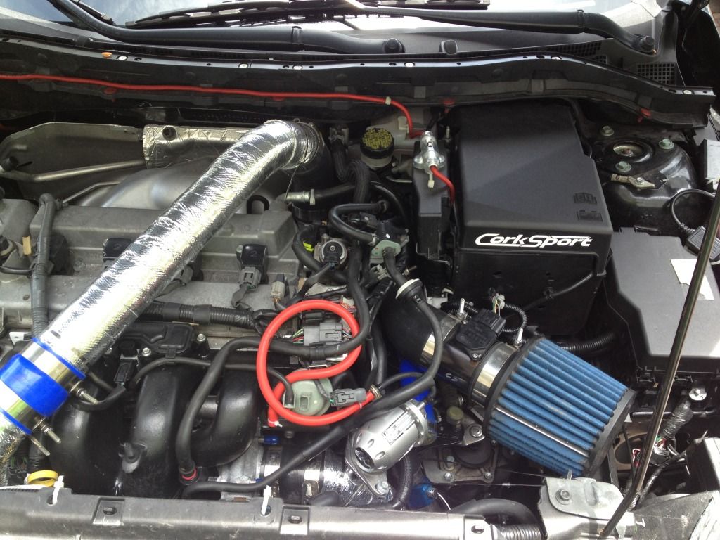

rghispanic88 06-09-2012 12:24 PM
DID someone say VTA?
http://i1206.photobucket.com/albums/...8/IMG_0149.jpg
http://i1206.photobucket.com/albums/...8/IMG_0150.jpg
Dash08 06-09-2012 05:57 PM
This thing is fucking loud.
I haz teh rice. Scare people I will.
