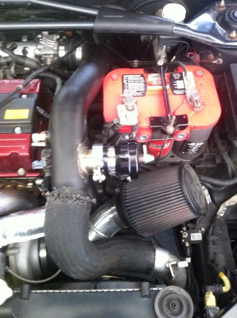

No, you definitely need the vac line hooked up. Some of the pics above were just taken before everything was put back together.
You need to hook that line up, or you'll get bad compressor surge.
Thanks for clarifying. That was throwing me off. Didn't look right so i thought I'd ask.

ewg vta without the dump tube

I have the ultimate VTA gates... but i has no picture at work lol

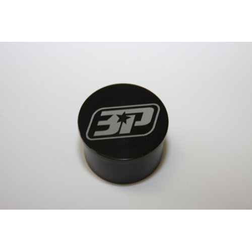

Fuck, hate being a noob to certain things, but what are you guys using to cap off the recirc inlet on the TIP?
I'm thinking a silicone or rubber hose cap with a clamp. Ace hardware, Lowe's?

Use one of these if using an inlet pipe and clamp it down. They come in all sizes.
I am just testing now and I put a small plastic container and clamped it down in my recirc hose. That will be cleaned up later though.
Dash08 (06-08-2012), SLOWHATCH (06-08-2012)

Or get a plastic pvc plug. They sell them at home depot or lowes for a buck, thats what I did with mine or we have these in stock if you wanna be all pretty

@djuosnteisn
Fast forward to 0:30 seconds. Runs for 2 mins middle part of video you can hear it. Don't know how to edit videos on the GoPro yet I'm a noob
@Lex is this how BOV's are supposed to work?
Evo VIII Compressor Surge TIAL Q - YouTube

Mother of god. That hurts to here.
And yes sounds like definitely comp surge.

You needs softer spring or perhaps the plumbing is not correct.

Originally Posted by 4G63 View Post
... is this how BOV's are supposed to work?
Definitely surgey sounding. Softer spring is indeed required.
Hopefully it doesn't open under vac with the softer spring, cause that's the norm on our platform. People have to shim them to get them just right, and it's a bitch.
Here's how a clean blow off should sound (kinda hard to hear, crank volume):
Yea I know it needs the softer spring like I was saying the one in their currently was for the vacuum I'd have at idle with the 274 cams in there. Wasn't going to install it til the cams but had to hear it lol. With a softer spring it should be fine I haven't seen anyone use any shimming to get it to work it's just the right spring that matters as you know.
My pipe setup like @Lex said isnt plumbed wrong but it is terrible now I'm gonna have to spend another $400 on some upper piping setup The pipe I got for cheap is hitting my Optima RedTop battery (it's a little wider than stock)
(piping wasn't all clamped for pic, speed density sensor is also resting on my valve cover because of the pipe being pushed over by the battery. Had to wrap it with krampton tape rated to 3000 degrees lol)
I'm done didn't mean to hijack I'm sorry Lex!!!

Well, this is bullshit.
Nobody sells those vinyl plastic end caps to cap off the recirc inlet. I wanted to use something soft so I can throw a hose clamp on it for a good seal.
I see the hard PVC plastic plugs and caps, but how do you keep the fucker on there? Can't put a hose clamp on PVC, that won't do shit.
Any other suggestions?

home depot has copper pipe caps, 1", for under $3. cut a short length of recirc hose, cram the cap in one end, and put the other end of the hose on the TIP. clamp both sides. done. that's how I have mine and no leaks, and as tight as the cap is in the hose it won't come out, especially with a clamp on it.

^^^This is a great idea.
I used a rubber plug from Ace Hardware and wrapped the exposed portion with a little electrical tape.
