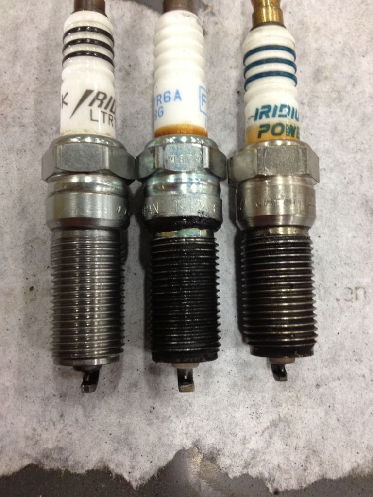

Interesting note:
Autolite XP5364 on left, NGK ILTR6A in the middle, Autolite XP5263 on right. All different lengths.
Could it be some of the blowout issues are a result of a bad connection between the coils and spark plugs? I just started getting into 20+ psi boost after the piston+rod change I did and was also having blow out issues. There was nothing I changed on either the tune or plugs when I swapped the internals and the head. Same spark plugs went in, OEM head gasket like before, etc. Literally nothing as far as combustion chamber was different except using genpoo pistons instead of gen1.
Yesterday I went from Densos to NGK. Same heat range and gap. Only difference is the Densos are midgets compared to the NGK. Sort of like the pic above. Not only was the insulator shorter on the Densos but also the side electrode.
Could it be you pushed the springs inside the COPs too far up when you used those black man penis Autolites and now they don't make very good contact?

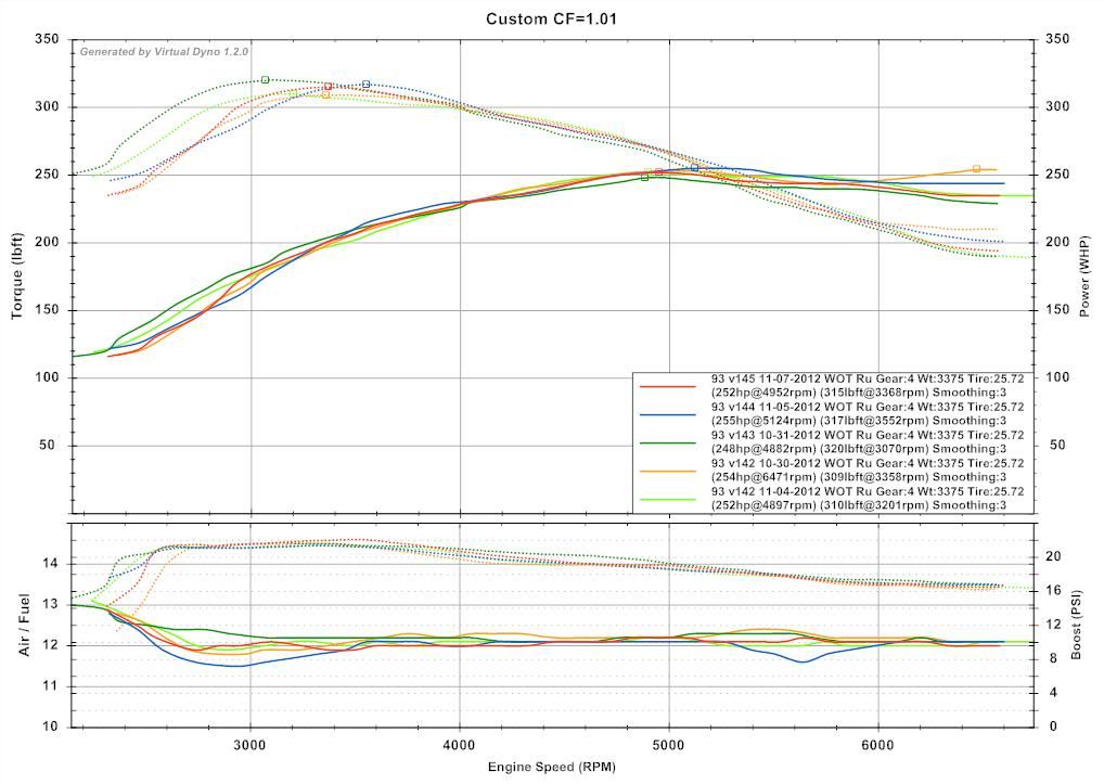

Step 1 completed. Blocked off the TMIC completely and did a couple 4th gear WOT runs. Still had blowout; on the second run I didn't even floor it.
I'm on empty, so I'm going to skip to step 3 and fill up with straight 93 pump gas.

I've been playing with tuning on 93 when I have the time. I also indexed the plugs the other day.
I'm not getting blowout on 93, but I have a lot of testing to do to figure out timing on this setup. I have attached four WOT logs; the first two (v142 map) use the WOT timing values from my pre-ZZB pump gas map. For the second two (v143 map), I pulled 1.5° timing from ALL my ignition maps (CL and OL). With the lower timing the car felt better at and shortly after spoolup, but felt very dead at high RPM.

Ran the tank down as low as I'd dare again, and filled up with 13+ gallons 93. I forgot to switch to my lower timing map before doing a few WOT runs. I get some decent KR at spoolup, but nothing of significance afterwards.
I'm adding 0.5° timing from 3500 up, and we'll see how the car responds.

I'm still getting KR in the 2500-3500 RPM range even after pulling timing a couple degrees. I'm pulling 5° VVT advance in that range as I'm already at 21psi by 2500 RPM.
AFRs are dead on targets after adding 1/2 a degree. My dumb ass forgot to recheck spark advance in the AP after doing a CL MAF cal, so no timing advance in the logs. Without that data, I'm not going to advance timing on this map yet.
FYI: I have adjusted the MAF scale at the low end, but I have not had to do any adjustment to the OL portion. The MAF curve from pre-ZZB has been working great.
How did you indexed the spark plugs just curious?
14mm tapered seat index washers.

 Old 11-05-2012, 09:16 PM   #427
Which size did you used .010" , .021" , .032" ?
I tried all plugs in each hole until I found one plug that fit in the #1 cylinder right without a washer. Then I tried the other three in #2 until I could fit one in with a 0.10" washer. In the end, I had one without a washer, two with a 0.10" washer, and the last was a 0.032" washer if I remember correctly.
The kit comes with 10 of each size, so there's enough to do several cars.

Your last set of logs didn't have timing...
Your previous set of logs suggest you were targeting about 3° at 2500 RPMs, which is 2-3° above what I have seen others run.
Personally, I never went above 0° at 2500 RPMs when on my K04...

 Old 11-06-2012, 05:30 AM   #429
when you say indexed, did you have the tip of the ground strap facing the intake valve? (i.e. pointing to it like a finger)
if so i would try it the other way and face it towards the exhaust and see what happens........

 Old 11-06-2012, 06:31 AM   #430
The ground strap... riser (for lack of a better term) is indexed facing the IM, so the spark will expand out towards the exhaust side and away from the injector.
Yeah, I know. I stated in my post I forgot to recheck timing before I did those logs.
I was targeting 2.5 degrees at 2500 RPM and 2.0 load before; I pulled it back to 0 degrees at that RPM & load.
Since I'm still getting a lot of KR, I'm pulling VVT advance to help clear it up.

Latest WOT logs attached.
Even after increasing timing ~2°, there's no appreciable change in power output.
Im not tuning guru like these guys are, but ive been following your post since your car blew up.
Ive gone over these logs, and I'm wondering why your making peak hp before you even touch 4900 rpm in most of these logs ? Especially with such cool BATs ? On top of that, it almost looks like the same in every log, as soon as your VVT hits 0 at or around 4800, you stop making anymore power. With the exception of the few logs where it jumps around sporatically at the end of the rpm band, where you gained peak hp at almsot 6400 rpm....
Seems wierd. Maybe im just an idiot. But it does still look wierd, or im not seeing something. 20lbs so low should be getting a bit more torque no ? Your timing table matches my 95 octane mixed gas tune, and im making over 345 consistantly on 1.01 VD's.
