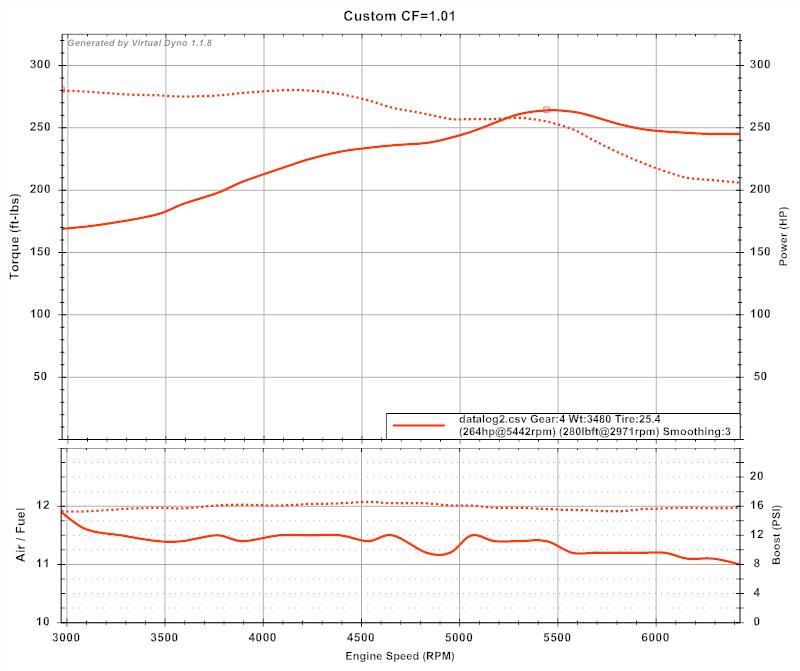

I've been working with @Boost_creep for awhile now, just thought I would post results of his most excellent work. Keep in mind this is with my modest list of mods, targeting 19.5psi. Using VD with CF of 1.01, as suggested by the forum, tire size 235/40-18, weight...very fat...some of us needz more HP than others LOL
http://i234.photobucket.com/albums/e...r/dyno_1vj.jpg
Mods in sig. Oh, this was with the IC shroud off; we're trying to see if we can track down some random KR.
EDIT: I'll post a datalog with stock tune and one with a canned Cobb Stage 1 tune tomorrow morning; I datalog in the mornings for consistency. I could post what I have, but I added the TIP and fixed some things while we were working together. So they wouldn't really be accurate. I think I started at around 230whp....LOL

Thanks for posting this, Ben!
Your car has really come a long way. Now, if only you had some local e85, we could make even more!

I don't think there's any race gas here either, but I could be wrong. In any case the corn isn't too far; it's around 50 miles away. The KR I'm seeing is partly due to noise; the last map was the first time we saw "real knock." So he's dialing it back a little here, adding some more there. On the last iteration there wasn't any knock and it was pretty aggressive. My AFR's were rock solid with that one. Hell I just checked my log, the highest KR on the log I used for the VD plot was 1.05. So not terribly significant.
Here's the log...
